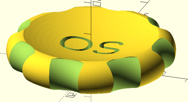

Hello!
just stumbled across the next video about muses 3d CAD comparison....
so wanted to see if i could quickly hack that coin together with
openscad....
weeeell.....
as usual the chamfers are the problem.... I managed them in one dimension
(z) but my imagination lacks concerning the x/y plane..... if ever someone
wants to show me how it's done, with pleasure!
But the main problem is a performance problem:
i came so far:
innendd= 6;
akr=5;
kr=20;
exr = 14;
maker_coin(r=kr, or=akr, innerh=innendd)
linear_extrude(height=2*akr) text("OS", size= 10, halign = "center", valign
= "center");
// r= radius of the coin- outercircle diam, inner height
module maker_coin(r=kr, or=akr, innerh=innendd, exd=14)
    maker_coin_body(r=kr, or=akr, innerh=innendd, exd=14);
    translate([0,0,2]) children();
module maker_coin_body(r=kr, or=akr, innerh=innendd, exd=14)
  resth = 2*or-innerh;
  bigd = (r^2+resth^2)/resth; //euklidischer Höhensatz·
    union()
      cylinder(r=r, h=2*or);
      translate([0,0,or]) rotate_extrude($fn=180)
translate([r,0,0])circle(r=or);
    union()
      translate([0,0,bigd/2+innerh]) sphere(d= bigd, $fa=1);
      for(w=[0:360/8:360]) rotate([0,0,w])·
        translate([r+2*or,0,-.1]) cutout(r=r, or=or, exd=exd);
module cutout(r=kr, or=akr, exd=14)
    cylinder(d=1.5*exd,h=2*or+2,center= false, $fn=100);
    cutr = or+0.2;
      translate([0,0,cutr-.2])
      rotate_extrude($fn=80)
      translate([exd/2+cutr,0,0])
    circle(r=cutr,$fn=60);
In fact everything went quite smooth until i rotated the cutout....
as soon as the for loop with the rotate went in (line 34) openscad gets
unbearably slow, with standard openscad unbearably so (the system thinks it
crashed...)
That didn't look so awful to me? So what happened?
and if we ( :D ) could offer a complete and easy to read example to send to
makers muse, that would make me happy :D the example on thingieverse is
well, on thingiverse, and does not comply completely to the  requirements
given....
ciao
Bruno

Indeed, that performance is really awful.  Turning on the experimental
vertex-object-renderer features helps a lot.  For me, that alone took
preview performance on your model from unusable to sort-of-usable.  But
still...
The first thing is easy.  Repeat this mantra:  use $fn only to create
regular polygons.  To control circle quality, use $fa and $fs.  $fa=2 /
$fs=1 seems like a reasonable setting here.
Also:  screens are high resolution and really show faces.  3D printing
much less so.  If you turn up your circle quality enough that your
displayed model looks really smooth, you probably have way more faces
than you really need for 3D printing.  Experiment.  Note also that you
can set the circle quality to some medium level while you're working,
and to high quality for your final render.
But that still leaves the preview performance pretty poor.
That leads us to a second and more difficult mantra:  never do in 3D
what you can do in 2D.

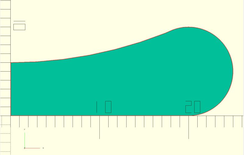

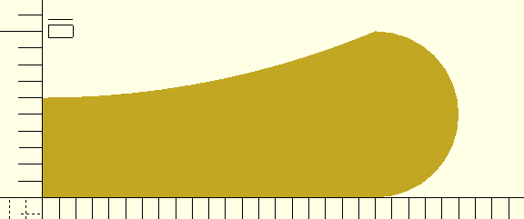

You have the basic shape of the coin being a torus unioned with a
cylinder, with a sphere subtracted.  But that's the same as a circle
unioned with a rectangle, with a circle subtracted, all
rotate-extruded.  The shape that would be rotate-extruded is this:
That gets you the body of the coin, without anywhere near as many nasty
3D operations.  (In particular, it avoids that big sphere with its
thousands and thousands of faces - in your design, it has ~26,000 faces.)

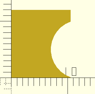

Similarly, you have cutout() being a cylinder with a torus subtracted.
But that's the same thing as a rectangle with a circle subtracted,
rotate-extruded.  The shape that you are rotate-extruding is:
Also, you have a convexity problem on the linear-extruded text.  A
convexity of four is probably enough, but five is definitely enough.
All that done, the performance gets pretty good.

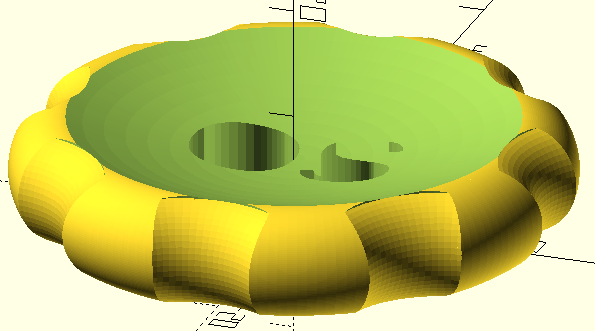

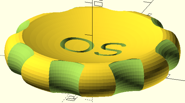

Here's a preview of your model:
Here's a preview of mine:
Mine is a little lower circle resolution on the outside.  My bet is that
the difference isn't visible in 3D printing, but experiment with $fs.
Setting $fs=0.5 looks like it's better resolution than yours, but it
gets significantly slower (not so much with the vertex-object stuff
turned on).  Experiment with an actual printer.  (Yours has 28K facets.
Mine with $fs=1 has 10K; with $fs=0.5 has 23K.)  Here's mine with $fs=0.5:
On my system (i7-13700), yours F6-renders in 1m6s; mine with $fs=1
renders in 15s; with $fs=0.5 in 54s.  But with the experimental Manifold
renderer, they're all sub-second.  (Manifold is magic.)
If one wanted to optimize further, note that cutout() is a fully
cylindrical object, and only a small fraction of it is actually used for
the subtraction.  You could use rotate_extrude's angle parameter to only
generate maybe a quarter of it.  Those invisible negative faces have a
preview cost (and probably a rendering cost too).  But that seems like
overkill.
Anyhow, there's some ideas.  Here's my version.
nasty 3D operations.  (In particular, it avoids that big sphere with
its thousands and thousands of faces - in your design, it has ~26,000
faces.)
subtracted.  But that's the same thing as a rectangle with a circle
subtracted, rotate-extruded.  The shape that you are rotate-extruding is:
that the difference isn't visible in 3D printing, but experiment with
$fs.  Setting $fs=0.5 looks like it's better resolution than yours,
but it gets significantly slower (not so much with the vertex-object
stuff turned on).  Experiment with an actual printer.  (Yours has 28K
facets.  Mine with $fs=1 has 10K; with $fs=0.5 has 23K.)  Here's mine
with $fs=0.5:
Manifold renderer, they're all sub-second.  (Manifold is magic.)

BB
Bruno Boettcher
Sat, Mar 2, 2024 7:59 AM
Hello Jordan!
wow... thanks a lots for the very detailed analysis!
Am Fr., 1. März 2024 um 21:00 Uhr schrieb Jordan Brown <
openscad@jordan.maileater.net>:
still...
ok, indeed :D looks bad on the screen but you are right, the printer hasn't
that good of a resolution....
That leads us to a second and more difficult mantra:  never do in 3D what
you can do in 2D.
will try to keep that in mind :D
unioned with a rectangle, with a circle subtracted, all rotate-extruded.
that's also exactly what Angus did :'(
That gets you the body of the coin, without anywhere near as many nasty 3D
operations.  (In particular, it avoids that big sphere with its thousands
ok, think i get it.....
rotate-extruded.
hmmm since we are at it... a hint how to integrate directly also the
horizontal bevels to that shape?
oh.... never looked into convexity, but noticed the ugly artifacts...
On my system (i7-13700), yours F6-renders in 1m6s; mine with $fs=1 renders
in 15s; with $fs=0.5 in 54s.  But with the experimental Manifold renderer,
my system is definitely slower :D but nevermind, your version clearly is
the one to go with! thanks!
overkill.
nope, will look into that! seems logical..
but as said i still need to add also in x/y plane the bevel, and not really
knowing how to achieve that....
anyway thanks a lot, i will put this up later on github, for further
enhancements and review!
thanks a lot!
ciao
Bruno

BB
Bruno Boettcher
Sat, Mar 2, 2024 10:18 AM
Hello all,
will still work on that for
  • limiting the cutouts to the necessary angles as Jordan suggested
  • and have to somehow add the x/y bevel to the cutouts,
in the meantime, i put it up here:
https://github.com/nohkumado/opensource_makercoin for review, validation
suggestions (i used the images you kindly provided, Jordan, hope that's
ok?), and in a few day i will try to push it onto Angus :D
thanks!

Hello all, will still work on that for - limiting the cutouts to the necessary angles as Jordan suggested - and have to somehow add the x/y bevel to the cutouts, in the meantime, i put it up here: https://github.com/nohkumado/opensource_makercoin for review, validation suggestions (i used the images you kindly provided, Jordan, hope that's ok?), and in a few day i will try to push it onto Angus :D thanks! Am Sa., 2. März 2024 um 08:59 Uhr schrieb Bruno Boettcher <bboett@gmail.com >: > Hello Jordan! > > wow... thanks a lots for the very detailed analysis! > > > Am Fr., 1. März 2024 um 21:00 Uhr schrieb Jordan Brown < > openscad@jordan.maileater.net>: > >> Indeed, that performance is really awful. Turning on the experimental >> vertex-object-renderer features helps a lot. For me, that alone took >> preview performance on your model from unusable to sort-of-usable. But >> still... >> >> The first thing is easy. Repeat this mantra: use $fn only to create >> regular polygons. To control circle quality, use $fa and $fs. $fa=2 / >> $fs=1 seems like a reasonable setting here. >> > ok, indeed :D looks bad on the screen but you are right, the printer > hasn't that good of a resolution.... > >> >> That leads us to a second and more difficult mantra: never do in 3D what >> you can do in 2D. >> > will try to keep that in mind :D > >> >> You have the basic shape of the coin being a torus unioned with a >> cylinder, with a sphere subtracted. But that's the same as a circle >> unioned with a rectangle, with a circle subtracted, all rotate-extruded. >> The shape that would be rotate-extruded is this: >> >> that's also exactly what Angus did :'( > > >> >> That gets you the body of the coin, without anywhere near as many nasty >> 3D operations. (In particular, it avoids that big sphere with its >> thousands and thousands of faces - in your design, it has ~26,000 faces.) >> > ok, think i get it..... > > >> >> Similarly, you have cutout() being a cylinder with a torus subtracted. >> But that's the same thing as a rectangle with a circle subtracted, >> rotate-extruded. >> > hmmm since we are at it... a hint how to integrate directly also the > horizontal bevels to that shape? > > >> >> Also, you have a convexity problem on the linear-extruded text. A >> convexity of four is probably enough, but five is definitely enough. >> > oh.... never looked into convexity, but noticed the ugly artifacts... > > On my system (i7-13700), yours F6-renders in 1m6s; mine with $fs=1 renders >> in 15s; with $fs=0.5 in 54s. But with the experimental Manifold renderer, >> they're all sub-second. (Manifold is magic.) >> > my system is definitely slower :D but nevermind, your version clearly is > the one to go with! thanks! > > > >> >> If one wanted to optimize further, note that cutout() is a fully >> cylindrical object, and only a small fraction of it is actually used for >> the subtraction. You could use rotate_extrude's angle parameter to only >> generate maybe a quarter of it. Those invisible negative faces have a >> preview cost (and probably a rendering cost too). But that seems like >> overkill. >> > nope, will look into that! seems logical.. > but as said i still need to add also in x/y plane the bevel, and not > really knowing how to achieve that.... > > anyway thanks a lot, i will put this up later on github, for further > enhancements and review! > thanks a lot! > > -- > ciao > Bruno > > =========================================== > http://nohkumado.eu/, <http://bboett.free.fr>http://aikido.nohkumado.eu/, > <http://bboett.free.fr> > http://aikido.zorn.free.fr > -- ciao Bruno =========================================== http://nohkumado.eu/, <http://bboett.free.fr>http://aikido.nohkumado.eu/, <http://bboett.free.fr> http://aikido.zorn.free.fr
Sat, Mar 2, 2024 12:09 PM
As well as the fillets, there is the problem of smoothing out the curve
in the top surface, to make it a 'tangent to the rim'. The gui interface
of most cad programs allow a tangent to be applied, or interactive
manual adjustment, since you can draw with lines, interactively pull
them about. In openscad you have to specify the locations. I think it is
achievable by trial and error, or by some mathematical calculations,
beyond my pay grade.. Wrt the fillet, I think it may be simpler? to
create it included with the 14d cylinder which is to be  subtracted, as
a sort of curved lip. This could be done, by creating a thin outline,
apply Minkowski with a 2mm radius, and subtract from a shape which
included the 14d cylinder. A lot of effort, but doable, even if slow as
treacle. But, the advantage is, it is all Parametric. Also, many  of the
Makersmuse attempts were unable to do filleting. It's been some time,
but I have previously imported scad files into freecad, just to get the
filleting done. Freecad is very good at that, being able to select the
edges, radius for each edge, etc.
I suppose I need to test my 'theories'.
Best wishes,
Ray

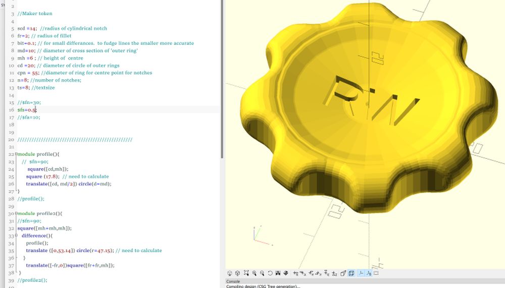

As well as the fillets, there is the problem of smoothing out the curve in the top surface, to make it a 'tangent to the rim'. The gui interface of most cad programs allow a tangent to be applied, or interactive manual adjustment, since you can draw with lines, interactively pull them about. In openscad you have to specify the locations. I think it is achievable by trial and error, or by some mathematical calculations, beyond my pay grade.. Wrt the fillet, I think it may be simpler? to create it included with the 14d cylinder which is to be  subtracted, as a sort of curved lip. This could be done, by creating a thin outline, apply Minkowski with a 2mm radius, and subtract from a shape which included the 14d cylinder. A lot of effort, but doable, even if slow as treacle. But, the advantage is, it is all Parametric. Also, many  of the Makersmuse attempts were unable to do filleting. It's been some time, but I have previously imported scad files into freecad, just to get the filleting done. Freecad is very good at that, being able to select the edges, radius for each edge, etc. I suppose I need to test my 'theories'. Best wishes, Ray On 02/03/2024 10:18, Bruno Boettcher via Discuss wrote: > Hello all, > will still work on that for > - limiting the cutouts to the necessary angles as Jordan suggested > - and have to somehow add the x/y bevel to the cutouts, > > in the meantime, i put it up here: > https://github.com/nohkumado/opensource_makercoin for review, > validation suggestions (i used the images you kindly provided, Jordan, > hope that's ok?), and in a few day i will try to push it onto Angus :D > > thanks! > > > > Am Sa., 2. März 2024 um 08:59 Uhr schrieb Bruno Boettcher > <bboett@gmail.com>: > > Hello Jordan! > > wow... thanks a lots for the very detailed analysis! > > > Am Fr., 1. März 2024 um 21:00 Uhr schrieb Jordan Brown > <openscad@jordan.maileater.net>: > > Indeed, that performance is really awful.  Turning on the > experimental vertex-object-renderer features helps a lot.  For > me, that alone took preview performance on your model from > unusable to sort-of-usable.  But still... > > The first thing is easy.  Repeat this mantra:  use $fn only to > create regular polygons.  To control circle quality, use $fa > and $fs.  $fa=2 / $fs=1 seems like a reasonable setting here. > > ok, indeed :D looks bad on the screen but you are right, the > printer hasn't that good of a resolution.... > > > That leads us to a second and more difficult mantra: never do > in 3D what you can do in 2D. > > will try to keep that in mind :D > > > You have the basic shape of the coin being a torus unioned > with a cylinder, with a sphere subtracted. But that's the same > as a circle unioned with a rectangle, with a circle > subtracted, all rotate-extruded.  The shape that would be > rotate-extruded is this: > > that's also exactly what Angus did :'( > > > That gets you the body of the coin, without anywhere near as > many nasty 3D operations.  (In particular, it avoids that big > sphere with its thousands and thousands of faces - in your > design, it has ~26,000 faces.) > > ok, think i get it..... > > > Similarly, you have cutout() being a cylinder with a torus > subtracted.  But that's the same thing as a rectangle with a > circle subtracted, rotate-extruded. > > hmmm since we are at it... a hint how to integrate directly also > the horizontal bevels to that shape? > > > > Also, you have a convexity problem on the linear-extruded > text.  A convexity of four is probably enough, but five is > definitely enough. > > oh.... never looked into convexity, but noticed the ugly artifacts... > > On my system (i7-13700), yours F6-renders in 1m6s; mine with > $fs=1 renders in 15s; with $fs=0.5 in 54s. But with the > experimental Manifold renderer, they're all sub-second.  > (Manifold is magic.) > > my system is definitely slower :D but nevermind, your version > clearly is the one to go with! thanks! > > > > If one wanted to optimize further, note that cutout() is a > fully cylindrical object, and only a small fraction of it is > actually used for the subtraction. You could use > rotate_extrude's angle parameter to only generate maybe a > quarter of it.  Those invisible negative faces have a preview > cost (and probably a rendering cost too).  But that seems like > overkill. > > nope, will look into that! seems logical.. > but as said i still need to add also in x/y plane the bevel, and > not really knowing how to achieve that.... > > anyway thanks a lot, i will put this up later on github, for > further enhancements and review! > thanks a lot! > > -- > ciao > Bruno > > =========================================== > http://nohkumado.eu/, > <http://bboett.free.fr>http://aikido.nohkumado.eu/, > <http://bboett.free.fr> > http://aikido.zorn.free.fr > > > > -- > ciao > Bruno > > =========================================== > http://nohkumado.eu/, > <http://bboett.free.fr>http://aikido.nohkumado.eu/, > <http://bboett.free.fr> > http://aikido.zorn.free.fr > > _______________________________________________ > OpenSCAD mailing list > To unsubscribe send an email todiscuss-leave@lists.openscad.org
Sat, Mar 2, 2024 1:19 PM
 the first, module profile, just the 20,6 square and the 5r circle
 next find the large circle by trial and error. the centre will be
 on the y axis (x=0) , and diameter will be the y value - 6
 then that will need to be subtracted from the 20,6 square and the
 5r circle, and something else, to give the smooth transition.
 The something else, by trial and error is a 17.8 square.
 useful to use # to give some f5 transparency
 If i knew the maths, then trial and error could be
 replaced by calculations, allowing a parametric result.
$fn=100;
module profile(){
      square([20,6]);
      square (17.8);
      translate([20,5]) circle(r=5);
module profile2(){
      profile();
   #   translate ([0,53.14]) circle(r=47.15);
Hello all,
Angus :D
thanks!
bboett@gmail.com:
 Hello Jordan!
     For me, that alone took preview performance on your model
     from unusable to sort-of-usable.  But still...
     to create regular polygons.  To control circle quality, use
     $fa and $fs.  $fa=2 / $fs=1 seems like a reasonable setting here.
     do in 3D what you can do in 2D.
     same as a circle unioned with a rectangle, with a circle
     definitely enough.
     like overkill.
 thanks a lot!
 ciao
 Bruno

/*  the first, module profile, just the 20,6 square and the 5r circle  next find the large circle by trial and error. the centre will be  on the y axis (x=0) , and diameter will be the y value - 6  then that will need to be subtracted from the 20,6 square and the  5r circle, and something else, to give the smooth transition.  The something else, by trial and error is a 17.8 square.  useful to use # to give some f5 transparency  If i knew the maths, then trial and error could be  replaced by calculations, allowing a parametric result.   */ $fn=100; module profile(){       square([20,6]);       square (17.8);       translate([20,5]) circle(r=5); } module profile2(){    difference(){       profile();    #   translate ([0,53.14]) circle(r=47.15);   } } On 02/03/2024 12:09, Raymond West via Discuss wrote: > > As well as the fillets, there is the problem of smoothing out the > curve in the top surface, to make it a 'tangent to the rim'. The gui > interface of most cad programs allow a tangent to be applied, or > interactive manual adjustment, since you can draw with lines, > interactively pull them about. In openscad you have to specify the > locations. I think it is achievable by trial and error, or by some > mathematical calculations, beyond my pay grade.. Wrt the fillet, I > think it may be simpler? to create it included with the 14d cylinder > which is to be  subtracted, as a sort of curved lip. This could be > done, by creating a thin outline, apply Minkowski with a 2mm radius, > and subtract from a shape which included the 14d cylinder. A lot of > effort, but doable, even if slow as treacle. But, the advantage is, it > is all Parametric. Also, many  of the Makersmuse attempts were unable > to do filleting. It's been some time, but I have previously imported > scad files into freecad, just to get the filleting done. Freecad is > very good at that, being able to select the edges, radius for each > edge, etc. > > I suppose I need to test my 'theories'. > > Best wishes, > > Ray > > On 02/03/2024 10:18, Bruno Boettcher via Discuss wrote: >> Hello all, >> will still work on that for >> - limiting the cutouts to the necessary angles as Jordan suggested >> - and have to somehow add the x/y bevel to the cutouts, >> >> in the meantime, i put it up here: >> https://github.com/nohkumado/opensource_makercoin for review, >> validation suggestions (i used the images you kindly provided, >> Jordan, hope that's ok?), and in a few day i will try to push it onto >> Angus :D >> >> thanks! >> >> >> >> Am Sa., 2. März 2024 um 08:59 Uhr schrieb Bruno Boettcher >> <bboett@gmail.com>: >> >> Hello Jordan! >> >> wow... thanks a lots for the very detailed analysis! >> >> >> Am Fr., 1. März 2024 um 21:00 Uhr schrieb Jordan Brown >> <openscad@jordan.maileater.net>: >> >> Indeed, that performance is really awful. Turning on the >> experimental vertex-object-renderer features helps a lot.  >> For me, that alone took preview performance on your model >> from unusable to sort-of-usable.  But still... >> >> The first thing is easy.  Repeat this mantra:  use $fn only >> to create regular polygons.  To control circle quality, use >> $fa and $fs.  $fa=2 / $fs=1 seems like a reasonable setting here. >> >> ok, indeed :D looks bad on the screen but you are right, the >> printer hasn't that good of a resolution.... >> >> >> That leads us to a second and more difficult mantra:  never >> do in 3D what you can do in 2D. >> >> will try to keep that in mind :D >> >> >> You have the basic shape of the coin being a torus unioned >> with a cylinder, with a sphere subtracted. But that's the >> same as a circle unioned with a rectangle, with a circle >> subtracted, all rotate-extruded.  The shape that would be >> rotate-extruded is this: >> >> that's also exactly what Angus did :'( >> >> >> That gets you the body of the coin, without anywhere near as >> many nasty 3D operations.  (In particular, it avoids that big >> sphere with its thousands and thousands of faces - in your >> design, it has ~26,000 faces.) >> >> ok, think i get it..... >> >> >> Similarly, you have cutout() being a cylinder with a torus >> subtracted.  But that's the same thing as a rectangle with a >> circle subtracted, rotate-extruded. >> >> hmmm since we are at it... a hint how to integrate directly also >> the horizontal bevels to that shape? >> >> >> >> Also, you have a convexity problem on the linear-extruded >> text.  A convexity of four is probably enough, but five is >> definitely enough. >> >> oh.... never looked into convexity, but noticed the ugly artifacts... >> >> On my system (i7-13700), yours F6-renders in 1m6s; mine with >> $fs=1 renders in 15s; with $fs=0.5 in 54s.  But with the >> experimental Manifold renderer, they're all sub-second.  >> (Manifold is magic.) >> >> my system is definitely slower :D but nevermind, your version >> clearly is the one to go with! thanks! >> >> >> >> If one wanted to optimize further, note that cutout() is a >> fully cylindrical object, and only a small fraction of it is >> actually used for the subtraction.  You could use >> rotate_extrude's angle parameter to only generate maybe a >> quarter of it. Those invisible negative faces have a preview >> cost (and probably a rendering cost too).  But that seems >> like overkill. >> >> nope, will look into that! seems logical.. >> but as said i still need to add also in x/y plane the bevel, and >> not really knowing how to achieve that.... >> >> anyway thanks a lot, i will put this up later on github, for >> further enhancements and review! >> thanks a lot! >> >> -- >> ciao >> Bruno >> >> =========================================== >> http://nohkumado.eu/, >> <http://bboett.free.fr>http://aikido.nohkumado.eu/, >> <http://bboett.free.fr> >> http://aikido.zorn.free.fr >> >> >> >> -- >> ciao >> Bruno >> >> =========================================== >> http://nohkumado.eu/, >> <http://bboett.free.fr>http://aikido.nohkumado.eu/, >> <http://bboett.free.fr> >> http://aikido.zorn.free.fr >> >> _______________________________________________ >> OpenSCAD mailing list >> To unsubscribe send an email todiscuss-leave@lists.openscad.org > > _______________________________________________ > OpenSCAD mailing list > To unsubscribe send an email todiscuss-leave@lists.openscad.org
Sat, Mar 2, 2024 2:02 PM
The BOSL2 library has a number of modules that create geometry that is
tangent to other geometry.  Maybe that would help make this parametric.
$fn=100;
module profile(){
      square([20,6]);
      square (17.8);
module profile2(){
      profile();
for each edge, etc.

The BOSL2 library has a number of modules that create geometry that is tangent to other geometry.  Maybe that would help make this parametric. On 3/2/2024 8:19 AM, Raymond West via Discuss wrote: > > /* >  the first, module profile, just the 20,6 square and the 5r circle >  next find the large circle by trial and error. the centre will be >  on the y axis (x=0) , and diameter will be the y value - 6 >  then that will need to be subtracted from the 20,6 square and the >  5r circle, and something else, to give the smooth transition. > >  The something else, by trial and error is a 17.8 square. >  useful to use # to give some f5 transparency > >  If i knew the maths, then trial and error could be >  replaced by calculations, allowing a parametric result. >   */ > > $fn=100; > module profile(){ >       square([20,6]); >       square (17.8); >       translate([20,5]) circle(r=5); > } > > module profile2(){ >    difference(){ >       profile(); >    #   translate ([0,53.14]) circle(r=47.15); >   } > } > > > > > On 02/03/2024 12:09, Raymond West via Discuss wrote: >> >> As well as the fillets, there is the problem of smoothing out the >> curve in the top surface, to make it a 'tangent to the rim'. The gui >> interface of most cad programs allow a tangent to be applied, or >> interactive manual adjustment, since you can draw with lines, >> interactively pull them about. In openscad you have to specify the >> locations. I think it is achievable by trial and error, or by some >> mathematical calculations, beyond my pay grade.. Wrt the fillet, I >> think it may be simpler? to create it included with the 14d cylinder >> which is to be subtracted, as a sort of curved lip. This could be >> done, by creating a thin outline, apply Minkowski with a 2mm radius, >> and subtract from a shape which included the 14d cylinder. A lot of >> effort, but doable, even if slow as treacle. But, the advantage is, >> it is all Parametric. Also, many  of the Makersmuse attempts were >> unable to do filleting. It's been some time, but I have previously >> imported scad files into freecad, just to get the filleting done. >> Freecad is very good at that, being able to select the edges, radius >> for each edge, etc. >> >> I suppose I need to test my 'theories'. >> >> Best wishes, >> >> Ray >> >> On 02/03/2024 10:18, Bruno Boettcher via Discuss wrote: >>> Hello all, >>> will still work on that for >>> - limiting the cutouts to the necessary angles as Jordan suggested >>> - and have to somehow add the x/y bevel to the cutouts, >>> >>> in the meantime, i put it up here: >>> https://github.com/nohkumado/opensource_makercoin for review, >>> validation suggestions (i used the images you kindly provided, >>> Jordan, hope that's ok?), and in a few day i will try to push it >>> onto Angus :D >>> >>> thanks! >>> >>> >>> >>> Am Sa., 2. März 2024 um 08:59 Uhr schrieb Bruno Boettcher >>> <bboett@gmail.com>: >>> >>> Hello Jordan! >>> >>> wow... thanks a lots for the very detailed analysis! >>> >>> >>> Am Fr., 1. März 2024 um 21:00 Uhr schrieb Jordan Brown >>> <openscad@jordan.maileater.net>: >>> >>> Indeed, that performance is really awful. Turning on the >>> experimental vertex-object-renderer features helps a lot.  >>> For me, that alone took preview performance on your model >>> from unusable to sort-of-usable.  But still... >>> >>> The first thing is easy.  Repeat this mantra:  use $fn only >>> to create regular polygons.  To control circle quality, use >>> $fa and $fs.  $fa=2 / $fs=1 seems like a reasonable setting >>> here. >>> >>> ok, indeed :D looks bad on the screen but you are right, the >>> printer hasn't that good of a resolution.... >>> >>> >>> That leads us to a second and more difficult mantra:  never >>> do in 3D what you can do in 2D. >>> >>> will try to keep that in mind :D >>> >>> >>> You have the basic shape of the coin being a torus unioned >>> with a cylinder, with a sphere subtracted.  But that's the >>> same as a circle unioned with a rectangle, with a circle >>> subtracted, all rotate-extruded.  The shape that would be >>> rotate-extruded is this: >>> >>> that's also exactly what Angus did :'( >>> >>> >>> That gets you the body of the coin, without anywhere near as >>> many nasty 3D operations.  (In particular, it avoids that >>> big sphere with its thousands and thousands of faces - in >>> your design, it has ~26,000 faces.) >>> >>> ok, think i get it..... >>> >>> >>> Similarly, you have cutout() being a cylinder with a torus >>> subtracted.  But that's the same thing as a rectangle with a >>> circle subtracted, rotate-extruded. >>> >>> hmmm since we are at it... a hint how to integrate directly also >>> the horizontal bevels to that shape? >>> >>> >>> >>> Also, you have a convexity problem on the linear-extruded >>> text.  A convexity of four is probably enough, but five is >>> definitely enough. >>> >>> oh.... never looked into convexity, but noticed the ugly >>> artifacts... >>> >>> On my system (i7-13700), yours F6-renders in 1m6s; mine with >>> $fs=1 renders in 15s; with $fs=0.5 in 54s.  But with the >>> experimental Manifold renderer, they're all sub-second.  >>> (Manifold is magic.) >>> >>> my system is definitely slower :D but nevermind, your version >>> clearly is the one to go with! thanks! >>> >>> >>> >>> If one wanted to optimize further, note that cutout() is a >>> fully cylindrical object, and only a small fraction of it is >>> actually used for the subtraction.  You could use >>> rotate_extrude's angle parameter to only generate maybe a >>> quarter of it. Those invisible negative faces have a preview >>> cost (and probably a rendering cost too).  But that seems >>> like overkill. >>> >>> nope, will look into that! seems logical.. >>> but as said i still need to add also in x/y plane the bevel, and >>> not really knowing how to achieve that.... >>> >>> anyway thanks a lot, i will put this up later on github, for >>> further enhancements and review! >>> thanks a lot! >>> >>> -- >>> ciao >>> Bruno >>> >>> =========================================== >>> http://nohkumado.eu/, >>> <http://bboett.free.fr>http://aikido.nohkumado.eu/, >>> <http://bboett.free.fr> >>> http://aikido.zorn.free.fr >>> >>> >>> >>> -- >>> ciao >>> Bruno >>> >>> =========================================== >>> http://nohkumado.eu/, >>> <http://bboett.free.fr>http://aikido.nohkumado.eu/, >>> <http://bboett.free.fr> >>> http://aikido.zorn.free.fr >>> >>> _______________________________________________ >>> OpenSCAD mailing list >>> To unsubscribe send an email todiscuss-leave@lists.openscad.org >> >> _______________________________________________ >> OpenSCAD mailing list >> To unsubscribe send an email todiscuss-leave@lists.openscad.org > > _______________________________________________ > OpenSCAD mailing list > To unsubscribe send an email todiscuss-leave@lists.openscad.org -- This email has been checked for viruses by AVG antivirus software. www.avg.com
Sat, Mar 2, 2024 8:28 PM
Probably good enough to 3d print, rendering obviously slow, but it
works. More time, higher resolution. (The values are what I noted from
the Youtube  by Angus)
code attached. Basically made the shape smaller by the size of the
fillet, then applied Minkowski to the whole thing, then at the end,
embossed the letters. I attempted to subtract the individual notches,
then add in fillets individually, but it got even more messy (bit=0.1 is
left over from that, maybe more). I may.  or may not do the couple of
calculations i mention in the comments, but only as an exercise. The
rest of it is pretty well parametric, but  I guess that's just the
number of notches and size of fillet.
It would be trivial to turn this into something functional, labelled
hydraulic hand-wheels, whatever.
