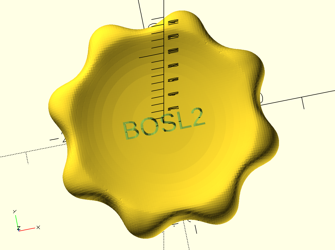

hmmm since we are at it... a hint how to integrate directly also the
horizontal bevels to that shape?
I don't know which edges you are wanting to bevel.
 Also, you have a convexity problem on the linear-extruded text.  A
 convexity of four is probably enough, but five is definitely enough.
oh.... never looked into convexity, but noticed the ugly artifacts...
On 3/1/2024 11:59 PM, Bruno Boettcher wrote: > > Similarly, you have cutout() being a cylinder with a torus > subtracted.  But that's the same thing as a rectangle with a > circle subtracted, rotate-extruded.  > > hmmm since we are at it... a hint how to integrate directly also the > horizontal bevels to that shape? I don't know which edges you are wanting to bevel. > Also, you have a convexity problem on the linear-extruded text.  A > convexity of four is probably enough, but five is definitely enough. > > oh.... never looked into convexity, but noticed the ugly artifacts... https://en.wikibooks.org/wiki/OpenSCAD_User_Manual/FAQ#Why_are_some_parts_(e.g._holes)_of_the_model_not_rendered_correctly?
BB
Bruno Boettcher
Sun, Mar 3, 2024 8:53 AM
Hello!
the expected result is what Raymond West got with the minkowsky transform!
In the picture he posted you see that his cylindrical cutouts are smoothed
in all planes.
Personally i have not very good experience with minowsky, since my designs
seem heavily optimizable by base :D, and even taking into account that i
will get some day better, adding minkowsky plunges my comps into the "take
ages to complete" and "freeze the app with never ending complains of the
system" hell....
So Raymonds solutions does the job of smoothing out the cutouts, but if i
could find one that is less taxing?
ciao
Bruno

Hello! the expected result is what Raymond West got with the minkowsky transform! In the picture he posted you see that his cylindrical cutouts are smoothed in all planes. Personally i have not very good experience with minowsky, since my designs seem heavily optimizable by base :D, and even taking into account that i will get some day better, adding minkowsky plunges my comps into the "take ages to complete" and "freeze the app with never ending complains of the system" hell.... So Raymonds solutions does the job of smoothing out the cutouts, but if i could find one that is less taxing? ciao Bruno Am So., 3. März 2024 um 03:22 Uhr schrieb Jordan Brown < openscad@jordan.maileater.net>: > On 3/1/2024 11:59 PM, Bruno Boettcher wrote: > > > Similarly, you have cutout() being a cylinder with a torus subtracted. >> But that's the same thing as a rectangle with a circle subtracted, >> rotate-extruded. >> > hmmm since we are at it... a hint how to integrate directly also the > horizontal bevels to that shape? > > > I don't know which edges you are wanting to bevel. > > Also, you have a convexity problem on the linear-extruded text. A >> convexity of four is probably enough, but five is definitely enough. >> > oh.... never looked into convexity, but noticed the ugly artifacts... > > > > https://en.wikibooks.org/wiki/OpenSCAD_User_Manual/FAQ#Why_are_some_parts_(e.g._holes)_of_the_model_not_rendered_correctly > ? > > -- ciao Bruno =========================================== http://nohkumado.eu/, <http://bboett.free.fr>http://aikido.nohkumado.eu/, <http://bboett.free.fr> http://aikido.zorn.free.fr
Sun, Mar 3, 2024 10:06 AM
Yeah, that sort of smoothing can be simply described as "hard" :-)
Like the shape that Sanjeev asked about, shapes with compound curves are
hard.  You can do some stuff with Bézier patches, but they are a pain to
describe.
Some shapes that are relatively easy to describe in the physical world
(sand off that corner, lay a fillet down along that corner) are hard to
describe geometrically.

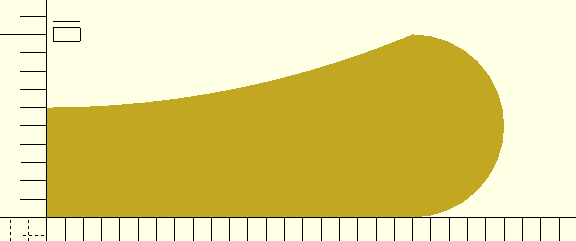

The shape of the coin profile is wrong.
The circular cutout intersects the rim at the top, but it should intersect further in, where the two circles have matching angles on the rims. The transition should not be detectable.
Try 'lifting it' slightly, or reducing the diameter with a fraction.
The fillets...
Can the fillets be modelled as sections of cylinders, or circular extruded from circles?
If so, make a negative 'form' for the rim of the coin, and use those cylinders and extrusions, together with a cylinder for the cutout itself, and use that with a DIFFERENCE operation to cleanly make the cutouts.
It's sometimes easier to make a negative and remove that from a piece than to build it up using additives.
Trygve

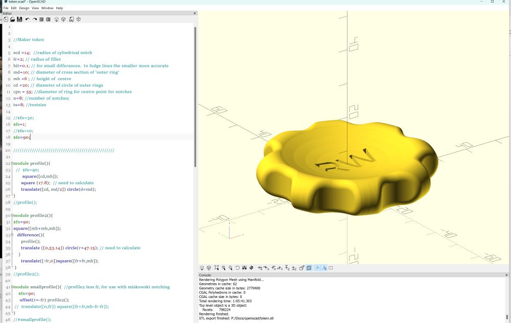

it's a function of the $fn. In my code I commented it out in the
profiles, so that it would render this side of Easter. If the same low
resolution image is good enough for printing, then a slight adjustment
to  the line  ' translate ([0,53.14]) circle(r=47.15); // need to
calculate' in profile 2  module will eliminate the ridge. If you comment
out the last line ( done() ) and uncomment the  '// profile();', you
will see the jagged profile. If you then uncomment the '//$fn =90;'  in
the profile module you get a smoother profile. Because there are both
large and small radii, the resolution achieved by the '$fn' values is
'not a one size fits all', and this was posted as a work towards a
solution.  As is, may be good enough for a  fdm print. Without the
attempt at filleting,It can be made smoother than a smooth thing using
openscad with a $fn =1000, (just 'cos we  can!).
An alternative could be to forget the the large recess/curve/scallop in
the profile, and then difference a large smooth sphere just before the
text addition. Many ways of getting a result.
cutouts.
That was my initial thought, I made a slim section of the interface of
the notch and the rim, (the ' bit=0.1' was left over from that ) - the
notch being  larger by twice the fillet, the rim being the small rim,
and then simply Minkowski that shape. However, adding that into a
suitably notched full size rim gave problems with non manifold
rendering, etc. I may return to that.
low resolution image is good enough for printing, then a slight
adjustment to  the line  ' translate ([0,53.14]) circle(r=47.15); //
need to calculate' in profile 2  module will eliminate the ridge. If
you comment out the last line ( done() ) and uncomment the  '//
profile();', you will see the jagged profile. If you then uncomment
the '//$fn =90;'  in the profile module you get a smoother profile.
Because there are both large and small radii, the resolution achieved
by the '$fn' values is 'not a one size fits all', and this was posted
as a work towards a solution.  As is, may be good enough for a  fdm
print. Without the attempt at filleting,It can be made smoother than
a smooth thing using openscad with a $fn =1000, (just 'cos we  can!).
in the profile, and then difference a large smooth sphere just before
the text addition. Many ways of getting a result.
of the notch and the rim, (the ' bit=0.1' was left over from that ) -
the notch being  larger by twice the fillet, the rim being the small
rim, and then simply Minkowski that shape. However, adding that into
a suitably notched full size rim gave problems with non manifold
