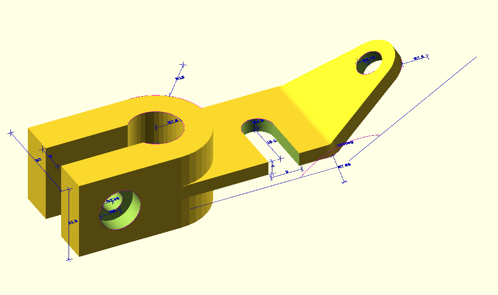

This is another topic I think needs a lot of attention.
The dimensional details of the 3d model made should be easy to communicate.
I have written a few functions in python which can do this.
openscad file attached, just to show what it is capable of
you need the file dependencies2.scad in the same folder to view this
[image: Screenshot 2025-06-25 at 9.20.05 PM.png]
I hope this works.

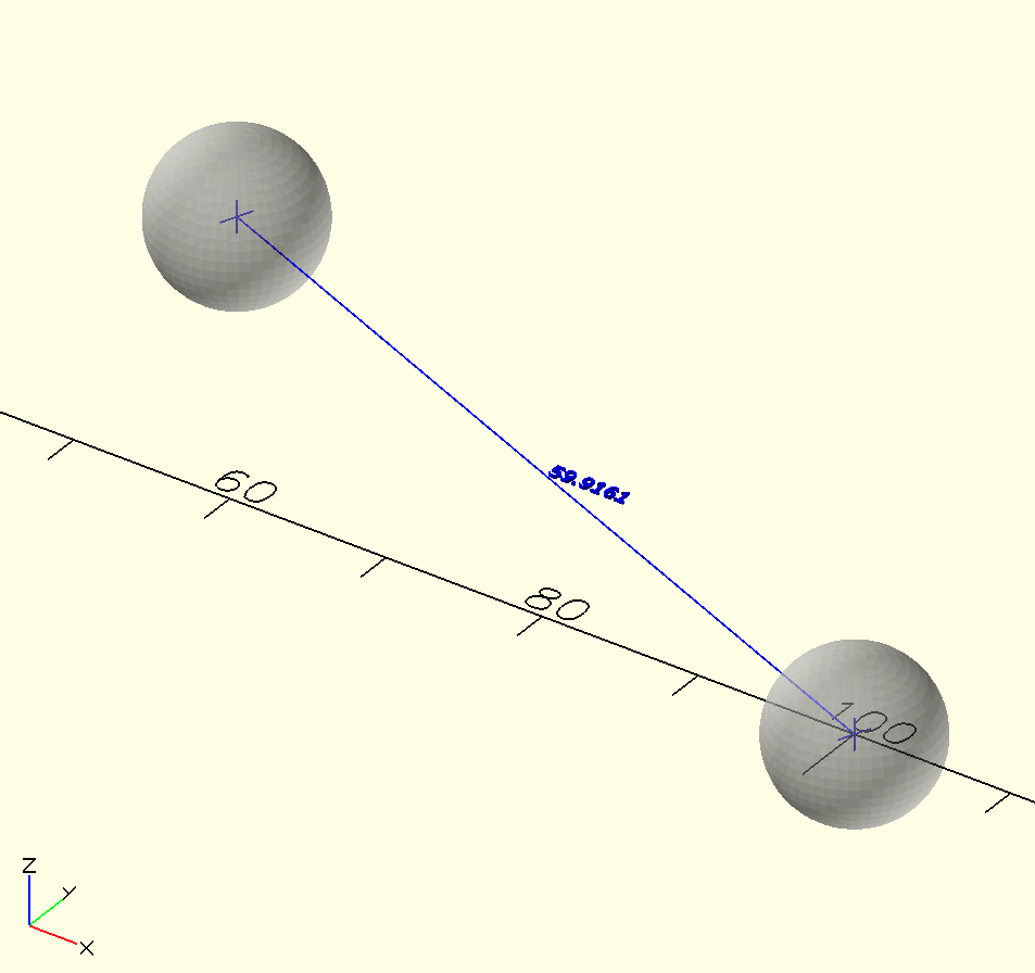

I tried the first 2 cases you mentioned:
python code is as below and results
openSCAD files are also attached (I don't know if this mail goes through
due to its size)
case1:
s1=translate([100,0,0],sphere(5))
s2=rot('z27', translate([50,0,0],sphere(5)))
find the centers of sphere s1 and s2
c1=center_circle3d(cpo(s1)[0])
c2=center_circle3d(cpo(s2)[0])
dimensioning
txt1=dim_linear([c1,c2],0)
f.write(f'''
include<dependencies2.scad>
%{swp(s1)}
%{swp(s2)}
{txt1}
[image: Screenshot 2025-06-26 at 7.08.28 AM.png]

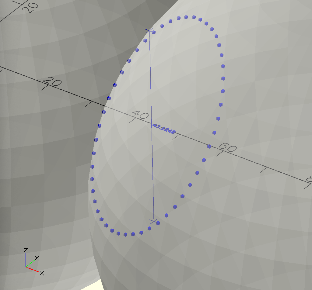

Case2:
s1=sphere(50);
s2=translate([90,0,0], sphere(50))
find the intersection points
ips=ip_sol2sol(s1,axis_rot_o([0,1,0],s2,90))
sort the points in lexicographic sequence from bottom to top
ips1=lexico(ips,[2,0,1])
pick the first and the last points
p0,p1=ips1[0],ips1[-1]
dimensioning
txt1=dim_linear([p0,p1])

The prerequisite is the drawing should be made with points list and not
with openscad primitives.

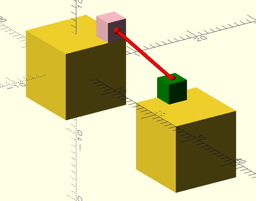

Jordan, you're not wrong but also you're not right.  The reason is that
BOSL2 provides restore().
Yes, in OpenSCAD fundamentally you can only pass information down the
tree.  But because of restore() the geometric tree does not have to match
the syntactic tree.  Note that below the two yellow cuboids() are for
practical purposes both at the top level, and the pink and green cuboids
are practically speaking, not in a child-ancestor relationship, and yet I
can still get the coordinates of points on the cube, draw a connecting
line, compute its distance, and so on.
cuboid(10)
align(TOP,BACK+RIGHT)
color_this("pink") cuboid(3) let(pink=parent())
restore()
right(20)
cuboid(10,anchor=TOP+FWD)
color_this("green")align(TOP,LEFT) cuboid(3) let(green=parent())
color_this("red")
stroke([desc_point(green,anchor=TOP),
desc_point(pink,anchor=RIGHT)],dots=true,width=0.5);
