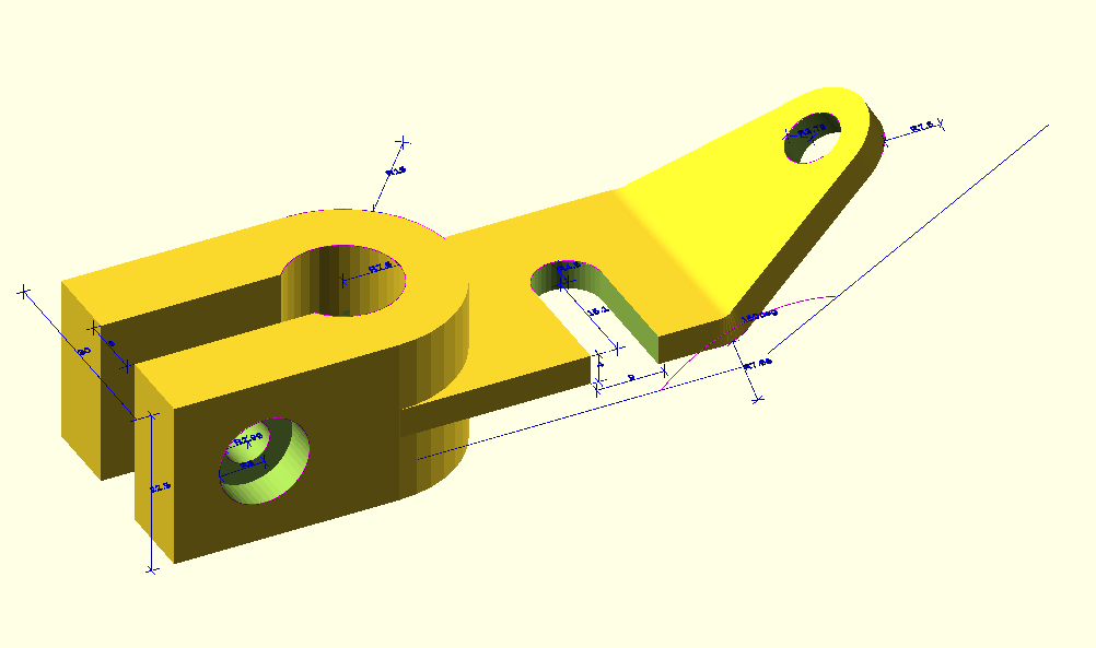

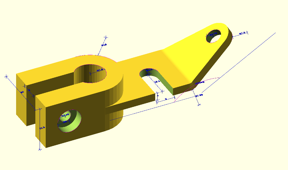

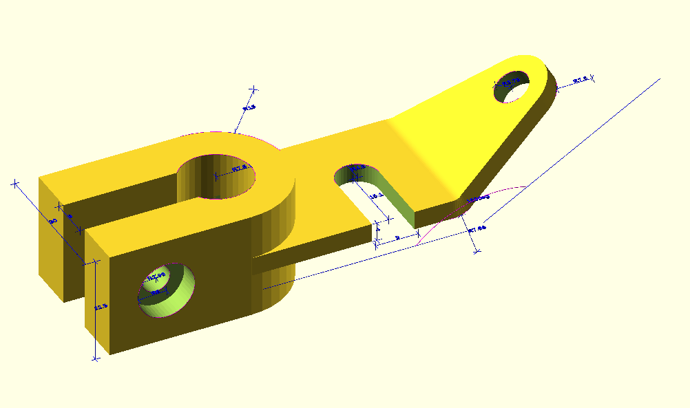

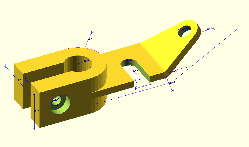

Hi Sanjeev,
On 26/06/2025 16:50, Sanjeev Prabhakar via Discuss wrote:
It's not so difficult to build models with points list. What is
probably required is to explain the design methodology to people.
Well how do you do it?
this one of yours, for example.
You probably have an intermediate step, from your visualisation, to the
points on a polygon or polyhedron. I'm sure you can't visualise the
correct numbers. However, it is straightforward, if tedious, to simply
construct it from basic shapes - cubes and cylinders in this case, (or
linear extrude circles and squares), within bare openscad itself. Once
that is accomplished, then maybe get the points from the stl/obj file
whatever.
I can easily visualise this
$fn=100;
cube(500,true);
translate([0,0,250])sphere(250);
no idea how to visualise the list of points for the polyhedron, and I
certainly couldn't be bothered to type them out, or be able to readily
change the location or scale, etc. and then redo it for $fn=10, say?
wrt dimensions on drawings, unless you are fabricating or checking
manually, then the chances are that most are not needed, and it will be
extremely difficult to place them automatically and correctly and
legible on a 3d drawing.
Just my two penn'orth
Best wishes,
Ray

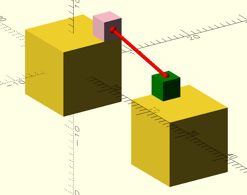

On 6/26/2025 4:46 PM, Adrian Mariano via Discuss wrote:
Jordan, you're not wrong but also you're not right.  The reason is
that BOSL2 provides restore().
Yes, in OpenSCAD fundamentally you can only pass information down the
tree.  But because of restore() the geometric tree does not have to
match the syntactic tree. Note that below the two yellow cuboids() are
for practical purposes both at the top level, and the pink and green
cuboids are practically speaking, not in a child-ancestor
relationship, and yet I can still get the coordinates of points on the
cube, draw a connecting line, compute its distance, and so on.
cuboid(10)
  align(TOP,BACK+RIGHT)
    color_this("pink") cuboid(3) let(pink=parent())
restore()
right(20)
  cuboid(10,anchor=TOP+FWD)
    color_this("green")align(TOP,LEFT) cuboid(3) let(green=parent())
    color_this("red")
      stroke([desc_point(green,anchor=TOP),
desc_point(pink,anchor=RIGHT)],dots=true,width=0.5);

Fri, Jun 27, 2025 2:30 AM
So,
When you create something from primitives,  you still have to do some
calculations and write code to Rotate, translate, extrude etc
Suppose drawing from the points list becomes equally simpler, probably you
would switch to that way of designing because then it will give that much
flexibility.
For me now it is like that.
I have written so many 2d and 3d sketching functions that almost anything I
wanted so far could be created.
Now the problem is that only I can do it as I remember all the functions
due to the fact that these were written by me ( of course some of it was
inspired by many of you here).
For anyone else it would be hard initially.
Finally, I would encourage everyone to learn making models through points
list. It will definitely help as per my experience.

Oh, I think you've scratched one of my itches...
I've done a bit of scale modeling with OpenSCAD for 3D printing, but ran
into the challenges you describe when I took up machining for metal parts.
No CNC, just dimensioning to support cutting actions.  I ended up writing a
dim() module that plotted both a measurement and a 'turns/ticks' count in
parens to inform the XY table translations in a milling operation.  Cool
beans...
But, my efforts to come up with overall dimensioned drawings didn't pan
out.  So, I'm going to try DraftSCAD with my current project, a structure
model.  It'd be nice to put out a set of drawings on the project for others
to consider/validate/etc.
But, this is the project I'd eventually go back to regarding dimensioned
drawings:  https://github.com/butcherg/DRG_168

Thank you for introducing me to DraftSCAD. Had not heard about it before. Please tell us know how your effort pans out. BTW, the locomotive is WAY COOL. God, it hurts my brain to think how long it took to write that in OpenSCAD... On Fri, Jun 27, 2025 at 10:14 AM Glenn Butcher via Discuss < discuss@lists.openscad.org> wrote: > Oh, I think you've scratched one of my itches... > > I've done a bit of scale modeling with OpenSCAD for 3D printing, but ran > into the challenges you describe when I took up machining for metal parts. > No CNC, just dimensioning to support cutting actions. I ended up writing a > dim() module that plotted both a measurement and a 'turns/ticks' count in > parens to inform the XY table translations in a milling operation. Cool > beans... > > But, my efforts to come up with overall dimensioned drawings didn't pan > out. So, I'm going to try DraftSCAD with my current project, a structure > model. It'd be nice to put out a set of drawings on the project for others > to consider/validate/etc. > > But, this is the project I'd eventually go back to regarding dimensioned > drawings: https://github.com/butcherg/DRG_168 > > Regards, > Glenn Butcher > On 6/27/2025 6:58 AM, Cameron Kendall Brooks via Discuss wrote: > > Hi, > > I’ve been working on a library that may be of interest on this topic. This > is an extension of some work by others as indicated in the readme: > https://github.com/CameronBrooks11/DraftSCAD > > > Sincerely, > Cameron Brooks > ------------------------------ > *From:* Sanjeev Prabhakar via Discuss <discuss@lists.openscad.org> > <discuss@lists.openscad.org> > *Sent:* June 26, 2025 10:30 PM > *To:* OpenSCAD general discussion Mailing-list > <discuss@lists.openscad.org> <discuss@lists.openscad.org> > *Cc:* Sanjeev Prabhakar <sprabhakar2006@gmail.com> > <sprabhakar2006@gmail.com> > *Subject:* [OpenSCAD] Re: dimensioning in openscad > > So, > When you create something from primitives, you still have to do some > calculations and write code to Rotate, translate, extrude etc > > Suppose drawing from the points list becomes equally simpler, probably you > would switch to that way of designing because then it will give that much > flexibility. > > For me now it is like that. > > I have written so many 2d and 3d sketching functions that almost anything > I wanted so far could be created. > > Now the problem is that only I can do it as I remember all the functions > due to the fact that these were written by me ( of course some of it was > inspired by many of you here). > > For anyone else it would be hard initially. > > Finally, I would encourage everyone to learn making models through points > list. It will definitely help as per my experience. > > On Fri, 27 Jun, 2025, 2:26 am Raymond West via Discuss, < > discuss@lists.openscad.org> wrote: > > Hi Sanjeev, > On 26/06/2025 16:50, Sanjeev Prabhakar via Discuss wrote: > > It's not so difficult to build models with points list. What is probably > required is to explain the design methodology to people. > > > Well how do you do it? > > this one of yours, for example. > > You probably have an intermediate step, from your visualisation, to the > points on a polygon or polyhedron. I'm sure you can't visualise the correct > numbers. However, it is straightforward, if tedious, to simply construct it > from basic shapes - cubes and cylinders in this case, (or linear extrude > circles and squares), within bare openscad itself. Once that is > accomplished, then maybe get the points from the stl/obj file whatever. > > I can easily visualise this > > $fn=100; > cube(500,true); > translate([0,0,250])sphere(250); > > no idea how to visualise the list of points for the polyhedron, and I > certainly couldn't be bothered to type them out, or be able to readily > change the location or scale, etc. and then redo it for $fn=10, say? > > wrt dimensions on drawings, unless you are fabricating or checking > manually, then the chances are that most are not needed, and it will be > extremely difficult to place them automatically and correctly and legible > on a 3d drawing. > > Just my two penn'orth > > Best wishes, > > Ray > _______________________________________________ > OpenSCAD mailing list > To unsubscribe send an email to discuss-leave@lists.openscad.org > > > _______________________________________________ > OpenSCAD mailing list > To unsubscribe send an email to discuss-leave@lists.openscad.org > > _______________________________________________ > OpenSCAD mailing list > To unsubscribe send an email to discuss-leave@lists.openscad.org >
Sat, Jun 28, 2025 1:46 PM
made a small video to explain how I do dimensioning in openscad with python
support
https://youtu.be/TfUT-q_Nl3U

Hi John
you can visit my github page:
https://github.com/sprabhakar2006/openSCAD
example of various functions.pdf:
https://github.com/sprabhakar2006/openSCAD/blob/main/explanation%20of%20approaches/example%20of%20various%20functions.pdf
