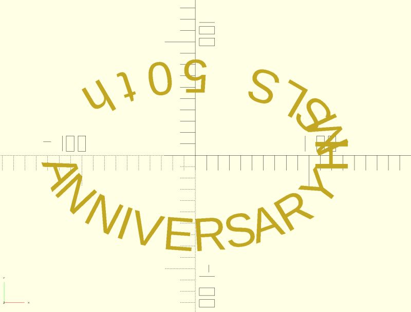

The furniture was the odd bits of 'lead;' that was not text, used to
space and lay out the text and individual letters correctly, generally
packing. I stated in my suggestion for an openscad solution that the
initial spacing would be fixed. At the moment, afaik, there is no
obvious width measurement for characters in openscad, certainly not for
various letter combinations, or ones that would work on curved lines. I
suggested the widest character so that you would be able to fit them in
the available space. I then said decrease the spacing as required (I
guessed folk would understand that was for the individual characters
where needed, and it would probably necessary to increase the font size
at the same time).  This process can be labour-intensive but is
necessary for achieving high-quality results in custom text.  Fitting
text into a space, odd shapes, etc, is an art form, and sometimes it
requires distortion of the individual letter shapes. But the example
that the op mentioned was less than 25 upper case letters (including a
couple of numbers), most likely with some time deadline, so the most
pragmatic approach is probably to position the characters manually, more
or less, or use some other software.

On 11/08/2024 22:50, Adrian Mariano via Discuss wrote:
Why would you base your text spacing on the widest character?  That
would look ridiculous.  You base your initial spacing on the actual
width of the letters.  For most letter pairs, no adjustment is needed
beyond that.  But the way that this is suboptimal is that it doesn't
account for cases where the bounding boxes of the characters should
overlap.  From what Jordan says, it sounds like OpenSCAD doesn't even
do fine kerning when you directly ask it for text.   I don't know what
you are talking about with "furniture pieces".  The way kerning was
accomplished in the days of lead type was that the type wasn't a
rectangle but actually had overhanging sections that could be
positioned into the notional bounding box of the adjacent letter.
Unless you're a typography expert, it's likely that your notion of
what "looks right" for kerning will be underdeveloped.

 The idea of kerning, is such that viewed from a distance (apart
 from blank lines/paragraphs and the like), the page looks a
 uniform shade of grey. It needs to be different for each character
 combination. In straight line text, as you've mentioned, it is
 achievable to a lesser or greater extent, but on curved lines,
 then that becomes a separate issue. Manual typesetters, in the old
 lead font days had furniture pieces to get the correct spacing. It
 depends very much on the type of font, as to how easy it to
 achieve 'correctness', and if the font is bold or italic, you will
 need to start over. It is perfectly doable, for 30 or so
 characters, to manually specify, say, the bottom lh corner, and
 the angle for each character. Openscad responds quickly enough
 that it can be tested as you position each character. The result
 will be most likely far superior to any mathematically
 automatically generated solution based on preconceived values, in
 an attempt to cover every situation. Still, use comic sans, and
 the necessity for kerning disappears.
 Usually, a 'W' is the widest character, so if it is, say, 10mm
 wide, then perhaps initially allow a spacing of 12 mm between
 characters. Space the the other characters at 12 mm spacing, see
 how it looks, and decrease the spacing as required so that it
 'looks right'. a module with character, xy, and angle parameters
 would speed the process (for some regular paths, the angle could
 be calculated from the xy values). Of course, it depends on 'how
 good your eye is', but that also depends on whoever designs some
 mathematical solutions, and I've seen some not so good TrueType
 fonts, and others.

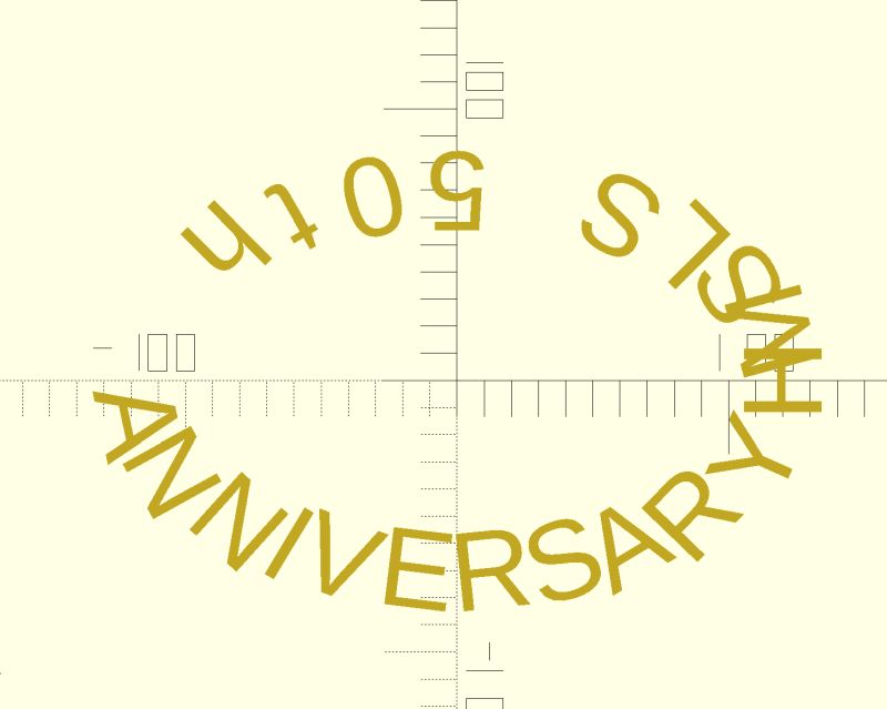

 On 11/08/2024 19:48, Adrian Mariano via Discuss wrote:
 Yes, the point of path_text is that it consults the text metrics
 to space the letters as well as possible and it also does the
 necessary interpolation along the curve you provide to find the
 correct letter positions and computes the normal to the curve so
 it can produce the proper letter orientation.
 Kerning is making tiny adjustments for specific combinations of
 letters like perhaps adjusting AV so that the two letters are
 closer together because their shapes enable them to fit together
 more tightly than their bounding boxes would suggest. Only people
 who are very attuned to typography are going to notice that
 kerning is missing.  I wonder if I could get kerning data out of
 textmetrics by asking for the metrics on pairs of letters and
 then also singleton letters and looking at how they differ.
 Would that work, Jordan?   Like if the advance of "AV" is 2 and
 the advance of A and V separately is 2.2 then would that mean
 that the advance of A should be reduced by 0.2 before placing the
 V to get the kerning?   Of course, the weakness of doing this is
 that ligatures would mess it up.

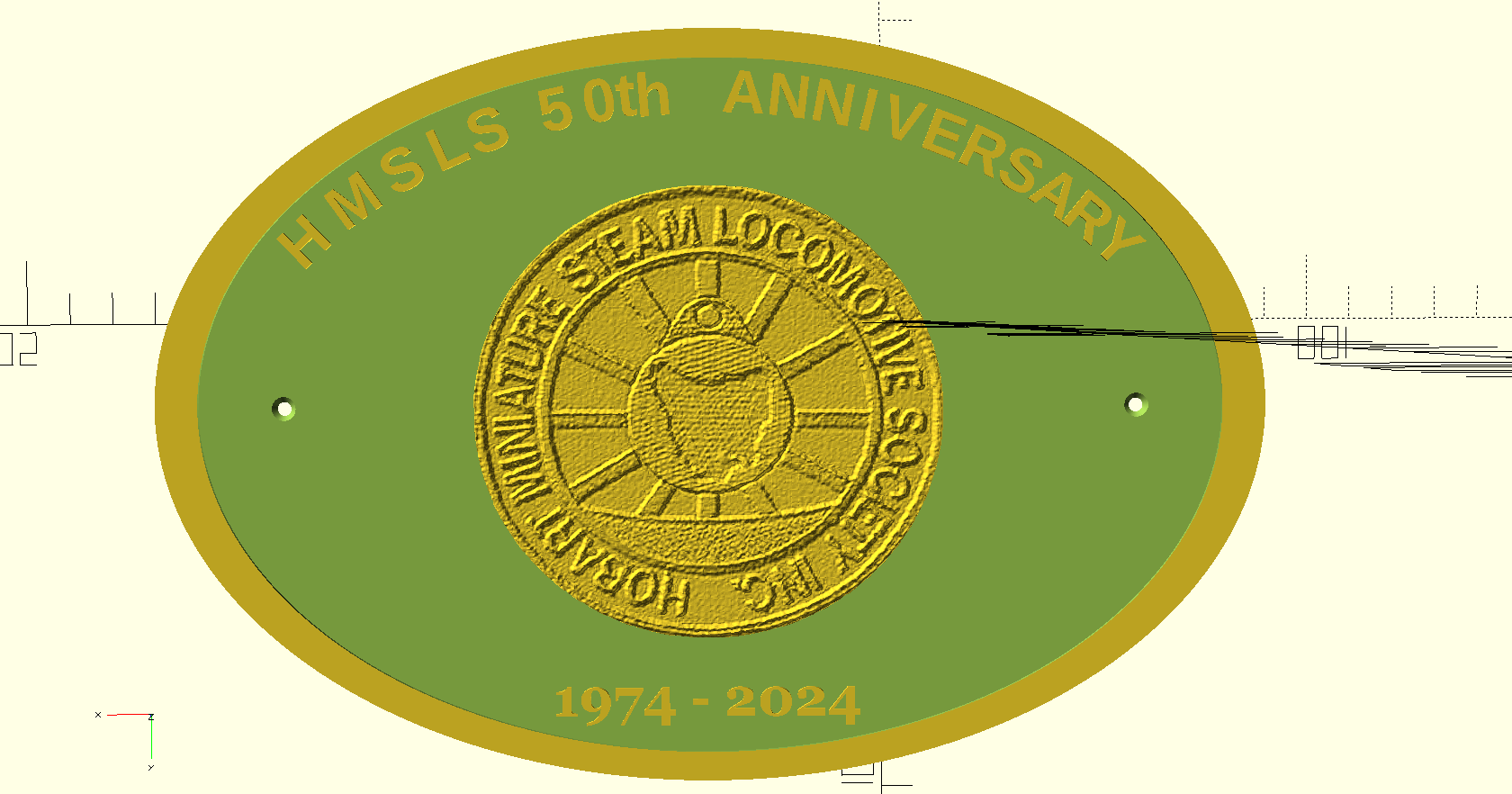

Mon, Aug 12, 2024 12:22 AM
With the dev version of OpenSCAD there is measurement for single
characters or in fact for any piece of text using the textmetrics feature.
Based on what Jordan said it sounds like the OpenSCAD text placement does
not do kerning, though, and of course any adjustment for layout on a curve
would have to be done manually.  But starting from the OpenSCAD layout
would surely be easier than starting from uniform spacing based on the
widest letter, especially for the average user who does NOT have your
expertise with typography.  How offensive do you find my example from a few
messages back where I redid the medal?  That's entirely automated using the
textmetrics, with no fiddly adjustment.

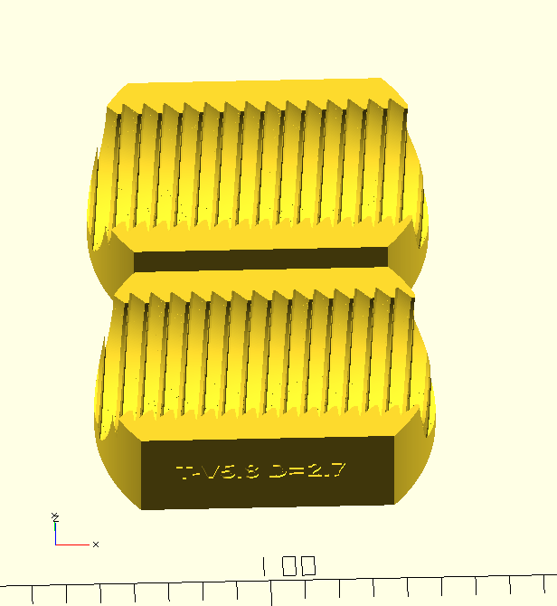

Whats wrong with TrueType? And/or whatever font openscad calls up on its
own with no includes. That is how the origonal machine ran.  The half
nut for my woodworker vice has 3 sides  available to engrave the tooth
id and size diff on it, so I do that on both sides. Using klipper, all
the little corners so close together make the printer slow to 5mm/sec as
it turns the corner.  With stock movement  motors the Ender5plus printer
will lose Y home at more than 20mm speeds. With the new stepper/servo
motors running on 72 volts, this works well at 150mm/sec, without any
input shaping. These motors can reverse a motor that has over shot its
last command, instantly. Normal steppers will overshoot up to 7
microsteps smearing the character. The controller can reverse the motor
when it has reached its position, stopping this overshoot because it has
a much higher voltage. And can use the full output of a 600 watt supply
to do it, might take a millisecond. Another advantage you can see in
your power bill. These motors get only the current needed to get to
where it is supposed to be, so in normal service it runs cold, where a
normal stepper runs at full current all the time. In some cases burn
your hand touching the hot motor, that is wasted heat you pay for in the
power bill for the month. Extra cost per axis is around $100, much of it
is the controller/driver, it is not stepstick stuff. So you put signal
stealers in the stepstick socket and wire 5 circuits from the driver
card in the printer to the frame mounted motor driver, for 5 volts,
ground, step, dir & enable. All opto isolated which is a speed limit due
to the opto's of 2500 to 3000 rpm. W/o that optos the motor could do
10,000 rpms.

Mon, Aug 12, 2024 7:26 AM
Many thanks to everyone who has replied to my query.
Based on comments in the various replies, I initially took the easy way
out by working my way through the fonts until I came across Liberation
Mono, which fixed the main problem as it has a capitol "I" that has a
vertical bar and two horizontal bars, thus making it more-or-less the
same spacing as the rest of the text.
Now I am working my way through the documentation of Adrian's suggestion
of the path_text() module (I have a dev version & have now enabled
textmetrics) to see if that can fix the slightly different angles of the
individual letters. It's not much, but they are not /quite/ the same and
I can see it- and it annoys the ocd in me!
The club's 50th is not until November, so I still have a bit of time to
play.......
Cheers, Ken
I think that is the text I'm using, only problem is in numbers, if en
even number like 2.0, it does not print the ,0, just the 2. I make the
half nuts to match the size of the bolt, by making a dummy bolt that
size, + about .9mm which is about 49mm, but has this 2 or whatever added
to the size of the bolt, so each nut pair fits that bolt precisely with
around 11 teeth of buttress thread fully engaged, 2 start so  I get 12mm

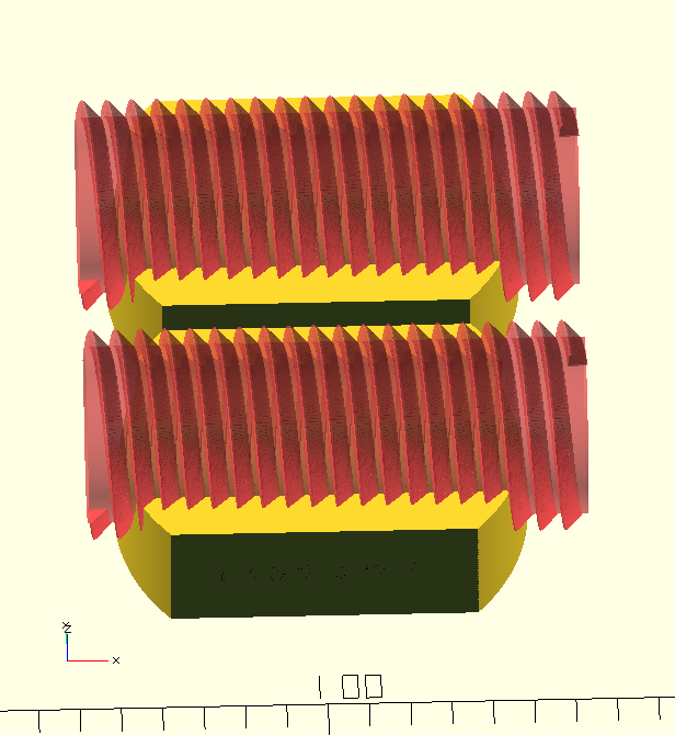

of jaw motion for every turn of the handle, then that virtual bolt is
subtracted from the block the nut is made from. At the same time the
tooth version and size of the nut is engraved on both sides of the nut.
If there is ever a nut problem, I then know how big a replacement nut to
make & send the customer. 1st pix attached is preview with the bolt call
previewed by a #. next is without the #preview an F6 render. These are
why I am building a farm of big & fast printers that can make some of
the smaller parts 4, 8, or 16 up. And I am probably the only outlaw on
the planet driving the XY axis's with much bigger stepper/servo.  The
increased active control of the motors gives me 150mm printing speeds
WITHOUT IS being measured or enabled.  That printer OOTB did Y skips at
25mm/sec.

I've  more or less completed what I set out to do, position characters
around an oval shape. Obviously  the result, i.e size, position is not
as any one else would want, but the code can be readily adapted. It will
allow precise positioning of characters around an oval, hoping that the
result  'looks right' . However, if there are restrictions as to size of
font and size of oval, then there can be obvious conflicts.
I've been looking at the oval text problem. I have other software that
generates text on circular arcs and produces g-code, and I think an
entirely different approach is needed for an oval or other curved path.
I believe it will be necessary to distort some characters. The first
illustration (ignore that above the x axis, if you can, I never never
got around to adjusting that,  but 'anniversary' looks more or less OK)
But - trying to get nice looking spacing at the top of the 'ANNIVERSARY'
is fine, until the second 'A'. The spacings at the bottom of characters
are not so noticeable. However looking in detail, I feel that the
letters should be 'pointing' to the origin of the oval. In order, the
'NNIV' and 'ARY' appear that the should be more pointed towards the
origin(but that may be because the axes is shown). That apart, the
spacing could be improved and I think then it would be good enough (the
spacing resolution in this example is one degree.)
Now, if we make the angles more aligned, then -
you can see that the characters are no longer aligned with the oval
path. Now, of course, a larger oval, small characters, change of font
will effect all of it.
added to the size of the bolt, so each nut pair fits that bolt
precisely with around 11 teeth of buttress thread fully engaged, 2
start so  I get 12mm of jaw motion for every turn of the handle, then
that virtual bolt is subtracted from the block the nut is made from.
At the same time the tooth version and size of the nut is engraved on
to make & send the customer. 1st pix attached is preview with the bolt
call previewed by a #. next is without the #preview an F6 render.
These are why I am building a farm of big & fast printers that can
make some of the smaller parts 4, 8, or 16 up. And I am probably the
only outlaw on the planet driving the XY axis's with much bigger
stepper/servo.  The increased active control of the motors gives me
150mm printing speeds WITHOUT IS being measured or enabled.  That
printer OOTB did Y skips at 25mm/sec.
suggestion of the path_text() module (I have a dev version & have now
enabled textmetrics) to see if that can fix the slightly different
angles of the individual letters. It's not much, but they are not
/quite/ the same and I can see it- and it annoys the ocd in me!
to play.......

Many thanks Raymond, after a bit of adjustment to suit my oval, your
code has worked exactly as advertised🙂.
I set it up so the text followed the top curve of my oval as closely as
I could, and also gave the character data table a variable to add to the
character space so I could just change one value to move the text so it
was nice and symmetrical in reference to the oval.
Now I just need to tidy up the badge a little....
