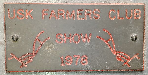

HI Ken,
Very nice, I'm glad you were able to use the code.  I was looking for
the plaques I made for the  Bristol Society of Model and Experimental
Engineers, (in the UK) around about 1974. I found this one from a few
years later (It's about 3 inches long).   Made using a strigon
pantograph mill engraving into brass sheet. I didn't have the proper
cutters, but I remember that for the bsmee I used a sewing needle,
ground into a spade bit. Back then, no cnc, but I made patterns maybe
four or five times actual size, and were scaled down by the pantograph.
Even a cardboard pattern was good enough in some instances, since the
errors were also reduced. It was all fixed font on small brass plates
which were traced for the lettering.

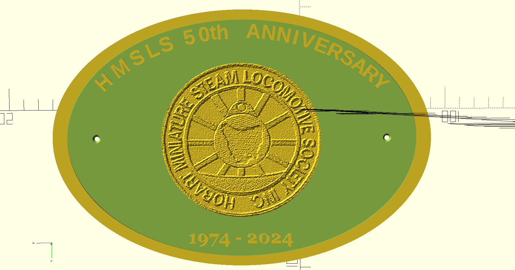

For your central logo, I think it would be better to redraw from
scratch, rather than try to tidy up the existing image, but that may
depend on how you are having the plates made.

.On 13/08/2024 09:46, Ken via Discuss wrote:
Many thanks Raymond, after a bit of adjustment to suit my oval, your
code has worked exactly as advertised🙂.
I set it up so the text followed the top curve of my oval as closely
as I could, and also gave the character data table a variable to add
to the character space so I could just change one value to move the
text so it was nice and symmetrical in reference to the oval.
Now I just need to tidy up the badge a little....
On 2024-08-13 01:34, Raymond West via Discuss wrote:
I've  more or less completed what I set out to do, position
characters around an oval shape. Obviously  the result, i.e size,
position is not as any one else would want, but the code can be
readily adapted. It will allow precise positioning of characters
around an oval, hoping that the result  'looks right' . However, if
there are restrictions as to size of font and size of oval, then
there can be obvious conflicts.
Cheers, Ken
