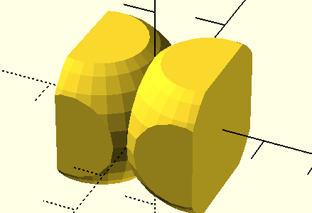

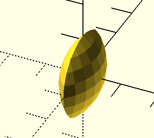

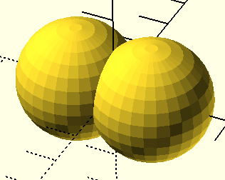

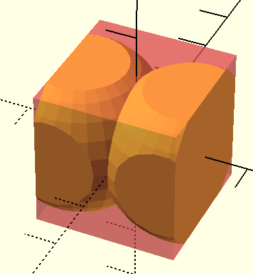

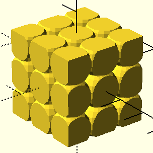

Consider this program:
     for(x=[-1,1])
         translate([x,0,0]*10)
             sphere(15);
     cube(25, center=true);
In standard OpenSCAD, it produces this model:
With Lazy Union enabled, it produces this model:
Not at all the same result.
This is of course a contrived demonstration, demonstrating one of many
scenarios that yield different results in the two modes.
It would be surprising if, among the thousands and thousands of models
out there, there are more than a few that would run into this difference.
Q.  Couldn't it be fixed so that the result is the same?
A.  Sure, but then it wouldn't be Lazy Union in its current form - and
probably some LU-based models would stop working.
Q.  Couldn't it stay as a separate mode?
A.  And have, forever, two different modes with very different behavior,
so that you can't look at a program and tell what it will generate?
Q.  Isn't the LU behavior better?
A.  For reasons too complicated to get into right now (having to do with
children()), I don't think so.  But it doesn't matter, because LU
behavior is not base OpenSCAD's behavior, and breaking models in subtle
ways is highly undesirable.

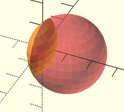

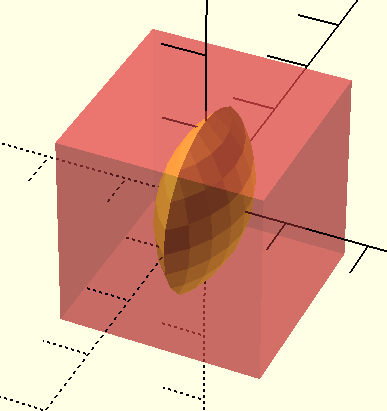

Q.  Why did it do that?
A.  With LU, the "for" doesn't get implicitly unioned; instead, it stays
separate as two children of the intersection.  The intersection then has
three children (sphere, sphere, cube) that it intersects.  (But:  if you
had to ask, isn't that a problem?)

Here's its result in standard OpenSCAD:
Why does it get that result?
The "for" loop generates two spheres, which are implicitly unioned so
that there's one "two spheres mushed into each other" shape:
The intersection then intersects that sort-of-dumbell-shaped shape with
a centered cube, chopping off the top, bottom, front, back, left, and
right sides.  Highlighting the cube with #:
Now, to be clear:  is this particular model useful for anything real?

The point of the message was that with Lazy Union enabled, the results
of the "for" are not implicitly unioned, and the result is as if you'd
said
     translate([-10,0,0])
         sphere(15);
     translate([10,0,0])
         sphere(15);
Intersecting the two spheres, highlighting one of them, yields this:
and then intersecting with the cube doesn't change anything, because the
cube (highlighted) is larger than that:
I promised a couple of perhaps-more-realistic models.  I'm not
explaining them in detail, but I hope that you can see how they relate
to my original simple example.
Mightn't something like this (an intersection of an array of spheres
with a cube) show up in an artistic model?
Or something like this (an intersection of an array of cubes with a sphere)?
Or, again simplified, this sort of cross-section cut?  This particular
example does not use intersection; it demonstrates a related problem
with difference; the LU result is:
