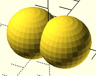

Here's the example again:
      for(x=[-1,1])
          translate([x,0,0]*10)
              sphere(15);
      cube(25, center=true);
what happens if the cube statement is moved to the first argument of the
intersection?
And I've not yet discerned how to "turn on" this LU?

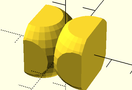

Here's its result in standard OpenSCAD:
Why does it get that result?
The "for" loop generates two spheres, which are implicitly unioned so
that there's one "two spheres mushed into each other" shape:

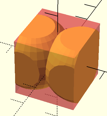

The intersection then intersects that sort-of-dumbell-shaped shape
with a centered cube, chopping off the top, bottom, front, back, left,
and right sides. Highlighting the cube with #:

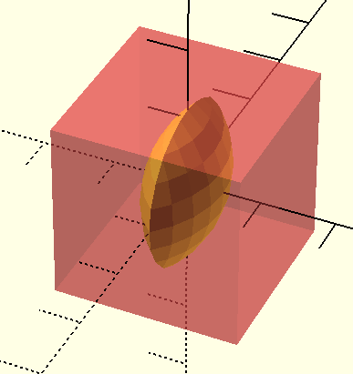

The point of the message was that with Lazy Union enabled, the results
of the "for" are not implicitly unioned, and the result is as if
you'd said
      translate([-10,0,0])
          sphere(15);
      translate([10,0,0])
          sphere(15);

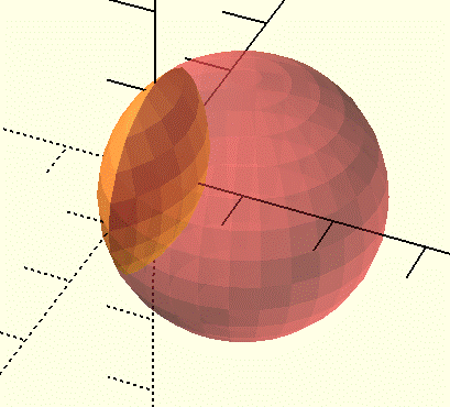

Intersecting the two spheres, highlighting one of them, yields this:
and then intersecting with the cube doesn't change anything, because
the cube (highlighted) is larger than that:

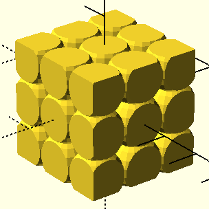

I promised a couple of perhaps-more-realistic models.  I'm not
explaining them in detail, but I hope that you can see how they relate
to my original simple example.
Mightn't something like this (an intersection of an array of spheres
with a cube) show up in an artistic model?

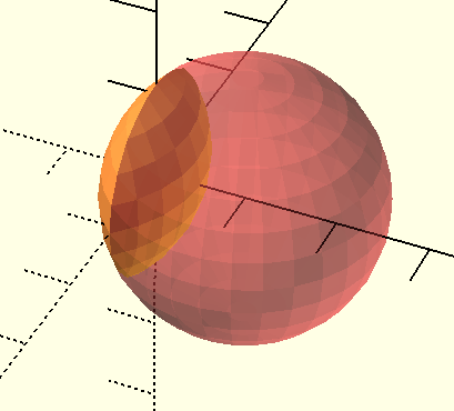

Or something like this (an intersection of an array of cubes with a
sphere)?
Or, again simplified, this sort of cross-section cut?  This particular
example does not use intersection; it demonstrates a related problem
with difference; the LU result is:
and then intersecting with the cube doesn't change anything, because the cube (highlighted) is larger than that:
