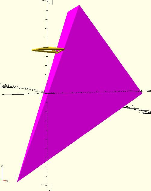

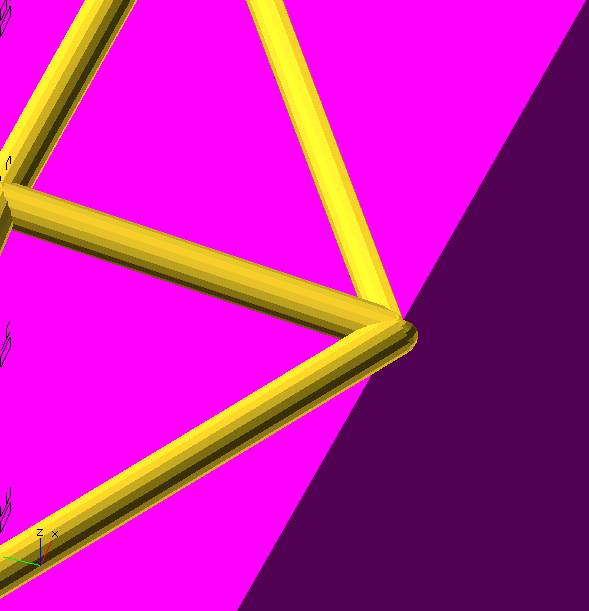

I'm helping a friend's daughter to construct a 120 sided solid by
3d printing a skeleton that she's going to cover in mylar.
My attempt is at:
https://github.com/rugyoga/catalan_solids/blob/main/disdyakis_triacontahedron.scad
Each face is a triangle.
To save some time, I wanted to print the parallelogram formed by four
triangles
so I only need 30 of them. Ideally I wanted them to snap together like lego
bricks.
So the edges that mate to the neighbouring parallelogram should be half
cylinders.
The code for the parallelogram works great.
But I can't get the difference operator to shave the half cylinders.
I'm subtracting four tetrahedron where face slices the rod in half.

Can you see anything obvious that I'm doing wrong?

This is your problem.
That is F5 & View/Thrown-together.
Your tetra( [v[8], v[18], v[7], v[15]] *2 ); is inside-out.
Effectively negative, hence difference() doesn't work.
See https://en.wikibooks.org/wiki/OpenSCAD_User_Manual/Primitive_Solids#Mis-ordered_faces

Sat, Dec 19, 2020 7:11 AM
Sorry, that's a bit misleading.
Not all inside-out, I keep forgetting on my normal system, a VM, I use S/W
rendering, it draws thrown-together a bit wrong.
I did it on a RM, two of the faces are bad.
Sorry, that's a bit misleading. Not all inside-out, I keep forgetting on my normal system, a VM, I use S/W rendering, it draws thrown-together a bit wrong. I did it on a RM, two of the faces are bad. ----- OpenSCAD Admin - email* me if you need anything, or if I've done something stupid... * on the Forum, click on my MichaelAtOz label, there is a link to email me. Unless specifically shown otherwise above, my contribution is in the Public Domain; to the extent possible under law, I have waived all copyright and related or neighbouring rights to this work. Obviously inclusion of works of previous authors is not included in the above. -- Sent from: http://forum.openscad.org/
Sat, Dec 19, 2020 7:15 AM
Also note your aim is a bit off
Sent: Sat, 19 Dec 2020 18:12
Subject: Re: [OpenSCAD] Problems with difference
