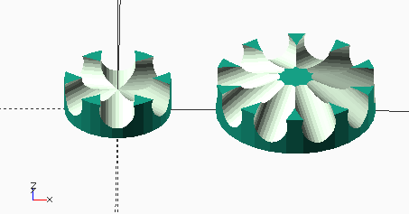

But I can't get the difference operator to shave the half cylinders.
I'm subtracting four tetrahedron where face slices the rod in half.
Your strategy to get a shaved diamond is hard to debug because it resorts
to other vertices besides the diamond ones. I got it using just the 4
extreme diamond vertices:
module flattened_diamond()
scale(2)
// this is the hull of 4 diamond vertices with the origin
polyhedron( [[0,0,0],v[20],v[6],v[18],v[8],v[20]],
[ [0,2,1], [0,3,2], [0,4,3], [0,1,4], [1,2,3,4] ] );
diamond();
This shape, despite its name, has not a flat base and will need support for
3d printing. To get a flat base, the diamond needs to be elongated down and
chopped, a non trivial task.
Ideally I wanted them to snap together like lego bricks.
The shape above is unable to snap in another one. I devised some clips that
could keep the diamonds together at each vertex:
module clip6(r) {
rotFromTo(v[6],[0,0,1])
translate(-v[6])
translate(v[6])
rotFromTo([0,0,1],v[6])
translate([0,0,-0.44r])
cylinder(r=r, h=0.7
r,center=true);
full_skeleton();
module clip12(r) {
rotFromTo(v[20],[0,0,1])
translate(-v[20])
translate(v[20])
rotFromTo([0,0,1],v[20])
translate([0,0,-0.58r])
cylinder(r=r, h=0.5
r,center=true);
full_skeleton();
module clips() {
translate([0,0,0.443+0.73/2])
clip6(3);
translate([10,0,0.584.5+0.54.5/2])
clip12(4.5);
clips();
[image: Clips.PNG]
