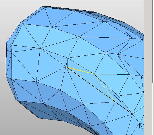

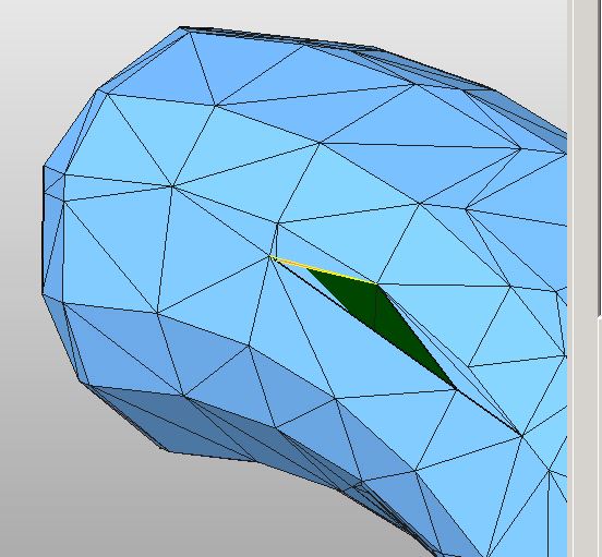

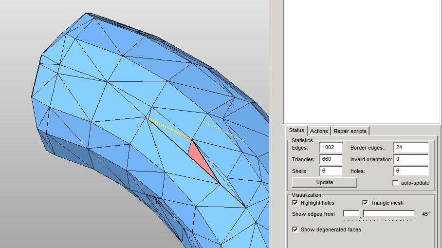

I think the flipped triangle with F5 is because it converts it back to a
PolySet. When there are very close vertices the grid snap and tessellation
can cause inverted triangles. With the F6 version the CGAL faces are not
all triangles but with F5 they are.

I think you will be waiting a long time for a fix because OpenSCAD has had
this problem for many years and it has been reported many times.
The workaround is to make sure there are no very close but not exactly
coincident vertices. Also flush the cache before doing F6.

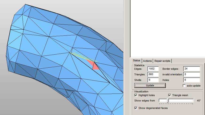

Thu, May 28, 2020 4:10 AM
Possibly the gross flipped triangle is caused by the tessellation from polygon to triangles going
wrong when there are small flipped triangles, just a guess.
Getting warmer.
With add_rotate=7, flushed-F6, export; STL is attached.
There is z-fighting in this region.
This is slightly moved.
I then selected the two triangles (black is selected-backface)
I then remove the two faces.
Showing correctly oriented faces. Plus other issues in the region.
So it is not just small-numbers.
Meshlab
Note the two arrows there is no vertex there (488 is on the other side), there are 4-6 overlapping
triangles, one or two inverted.
There are no small triangles that I can see.
> Possibly the gross flipped triangle is caused by the tessellation from polygon to triangles going wrong when there are small flipped triangles, just a guess. Getting warmer. With add_rotate=7, flushed-F6, export; STL is attached. There is z-fighting in this region. This is slightly moved. I then selected the two triangles (black is selected-backface) I then remove the two faces. Showing correctly oriented faces. Plus other issues in the region. So it is not just small-numbers. Meshlab Note the two arrows there is no vertex there (488 is on the other side), there are 4-6 overlapping triangles, one or two inverted. There are no small triangles that I can see. -- This email has been checked for viruses by AVG. https://www.avg.com
