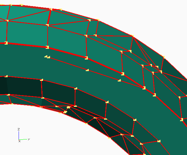

That region is the post tessellation version of this line on the side
generated by CGAL.
I presume that is a very long thin polygon that, when its vertices get
snapped, starts to self intersect and then breaks the
tessellation algorithm.

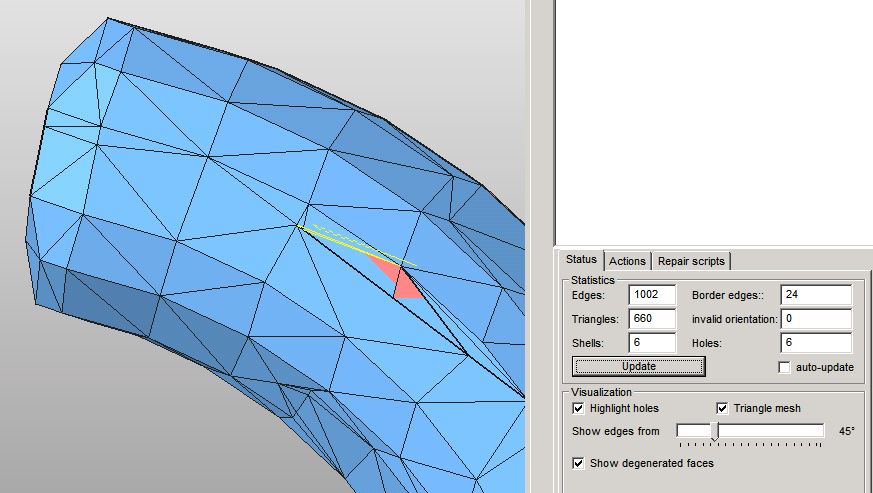

With add_rotate=7, flushed-F6, export; STL is attached.

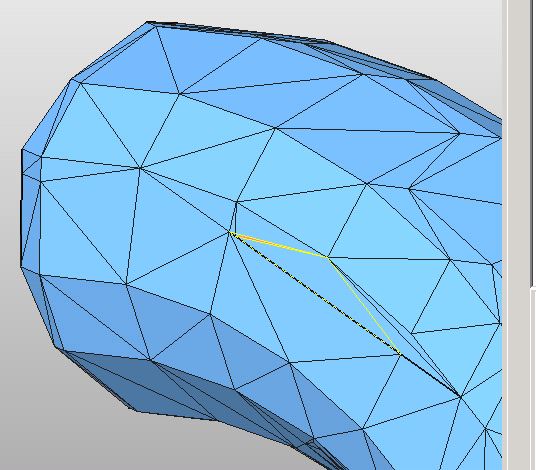

There is z-fighting in this region.
This is slightly moved.

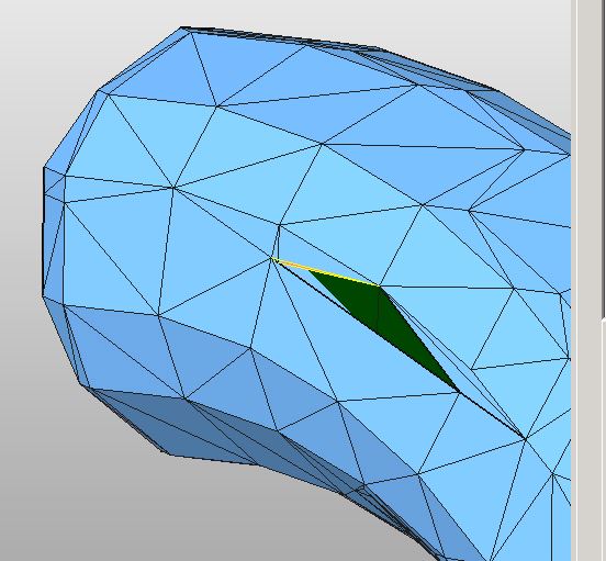

I then selected the two triangles (black is selected-backface)
I then remove the two faces.

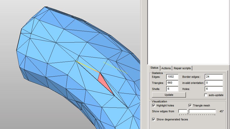

Showing correctly oriented faces. Plus other issues in the region.
So it is not just small-numbers.

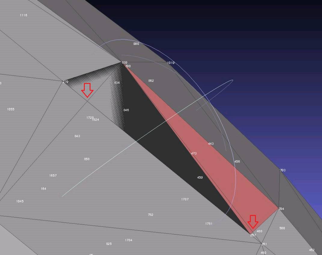

Meshlab
Note the two arrows there is no vertex there (488 is on the other side),
there are 4-6 overlapping triangles, one or two inverted.
There are no small triangles that I can see.
