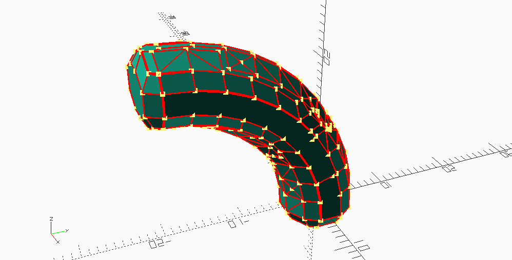

Yes the PolySet grid snap bug should be fixed but it is hard. It is exactly
the same issue that STL files have. OpenSCAD needs a mesh fixer to make it
robust whenever vertex resolution is reduced. If it had one then it could
also fix broken STL imports and bad polyhedron data and stop this endless
list of why does my model not render.

As long as I flush the cache and do F6 it all looks fine to me and I can
export the STL to Netfabb and that says it's fine as well.

It works fine for me if I flush the cache before F6 but not if I do F5,
F6.
So it is not a bug in Minkowski, it is just the normal PolySet grid snap
bug that breaks topology and caches it.
I'm not so sure.

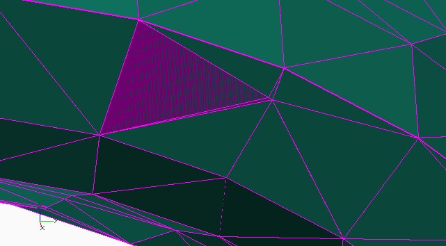

As I said, z-fighting outside-face & inside-face.
In Netfabb I was able to delete the wrong face, and the right one was then
exposed.
I'm still looking, but it does look like duplicated faces.

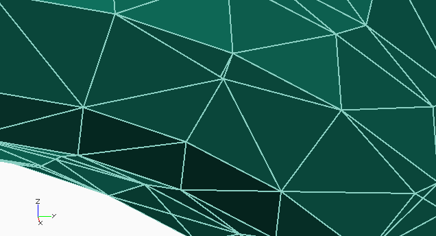

However, testing the exported STL in polyfix reveals a higher number of
faces (628) compared to what OpenSCAD reports (413), which is kind of
strange.

As you can see, polyfix resolved both of the above to vertices=308
faces=608, even if the starting points were different. I think this
shows that at least part of the problems lie in file export code.
It does not make sense that the number of faces exported depends on the
file format chosen. Clearly, there is no check for zero area faces on
file export in OpenSCAD.

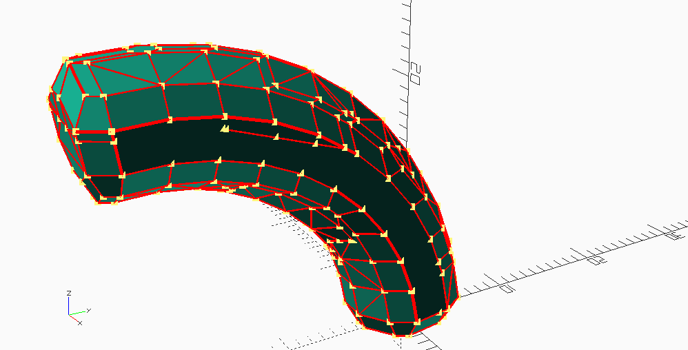

For consistency please use add_rotate=7, it seems to be worse.

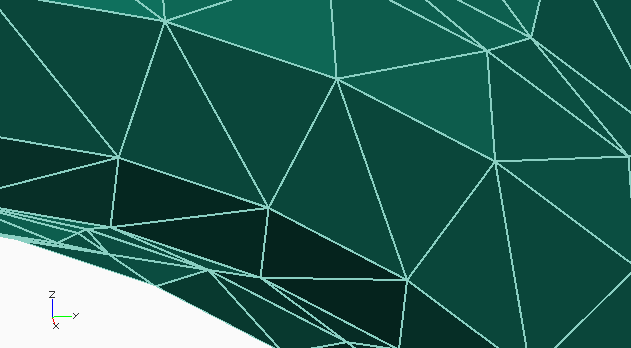

That does produce a broken STL where the lines are on the sides.
I expect CGAL produces vertices that are very close together and they
collapse during export to STL.

This quite clarify my understanding. But how preview deals with minkowski?
I imagine that the flow above is pretty much the same except the union in
last step. Preview might just throw the convex parts to the z-buffer
avoiding the union. And this last process seems to be creating a flipped
face.
That is what I get after a fresh F6 followed by a F5:
[image: FlushF6F5.PNG]
and that is what comes out from a fresh F5:
[image: FlushF5.PNG]
and that last one with Throw Together:
[image: FlushF5TT.PNG]
So, it seems there is a bug in the F5 process of minkowski,
