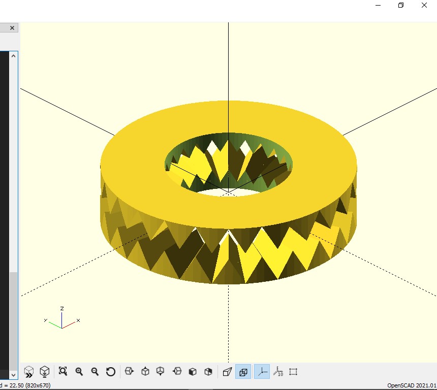

Something else with teeth that the world has been waiting for: a face spline coupling aka Hirth coupling. I created it some time ago as part of a design, but it had a glitch that turned out to be because the circumference of a small sector of a circle is slightly longer than the straight line across it. This left tiny but visible gaps between the splines.
I thought it would be difficult to parametrise but it was not.
But it still has some sharp edges that need rounding. Any volunteers?

I was curious what this looks like so I loaded it up and hit F6. I get No Geometry to Render.

Works perfectly here.
Previews immediately with the cube-and-chevron icon, took a little longer with F6.
Works perfectly here. Previews immediately with the cube-and-chevron icon, took a little longer with F6.

Fri, Sep 20, 2024 12:15 AM
This is what you should see.
BTW I said sector above, but meant segment.
This is what you should see. BTW I said sector above, but meant segment.

i Am using Version 2021.01, but that shouldn’t make any difference?

Still no joy?
Try deleting all //, /* and */.
Still no joy? Try deleting all //, /\* and \*/.

I tried that, still no joy. I'm running 2024.08.30
F5 says Compile & preview finished, total rendering time 0.064 seconds- but there's nothing there.
F6 says there is no top-level geometry to render.

Does this work for you?
