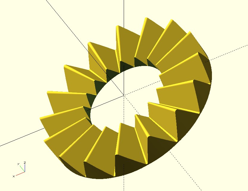

Doesn't work for me.
On Fri, 2024-09-20 at 01:07 +0000, Caddiy via Discuss wrote:

Doesn't work for me. On Fri, 2024-09-20 at 01:07 +0000, Caddiy via Discuss wrote: > Does this work for you?$fn=100;$vpr=[ 60, 0, 315 ]; > $vpt=[ 0, 0, 0 ]; > $vpd=80; > a=60; // Base angle > r=12; // Radius > n=16; // Number of splines > module facespline() > { > difference() > { > intersection() > { > for(i = [1 : n]) > rotate(i * 360/n) > polyhedron( > points = [ > [0, 0, PI*r/2/n*tan(a)], > [r, r*tan(360/2/n), 0], > [r, -r*tan(360/2/n), 0], > [r, 0, PI*r/n*tan(a)], > [0, 0, 0] > ], > faces = [ > [1,2,3], > [3,2,0], > [3,0,1], > [0,2,4], > [0,4,1], > [1,4,2] > ]); > cylinder(r=r, h=PI*r/16*tan(a)+1); > } > // Hole > translate([0,0,-1]) > cylinder(r=6, h=5); > }} > // Face spline coupling > { > translate([0, 0, -3]) > facespline(); > translate([0, 0, 3]) > rotate([0, 180, 360/2/n]) > facespline(); > } > > _______________________________________________ > OpenSCAD mailing list > To unsubscribe send an email to discuss-leave@lists.openscad.org

Sorry Mike, same result as before.

I think you guys not seeing it may have Lazy Union enable.
Problem is the intersection() of the for(), as each arm of the for() doesn't overlap, so intersection() returns empty.
With Lazy union disabled (or not in 2021.01) the for() does a union().
To fix, stick union() in front of the for().

Thanks Michael, that fixed it!

That worked for me too. It’s funny I had to make one of these for a project. My electric golf cart (carries my clubs, not me), has an accessories connector with one of these. Below is the part I made. It’s about 30 mm across. I had to count the blades by hand and measure everything to get it since I had no idea what kind of spline this was. I can’t post the code since I use my  own library and BOSL2, but the way I constructed it was to create 1 “fanBlade” and then repeat it 60 times around a circle. Each fanBlade was made by positioning a thin inner shape and a thin out shape, then hull’ing. I’ll be taking a closer look at the posted code to compare the two methods.

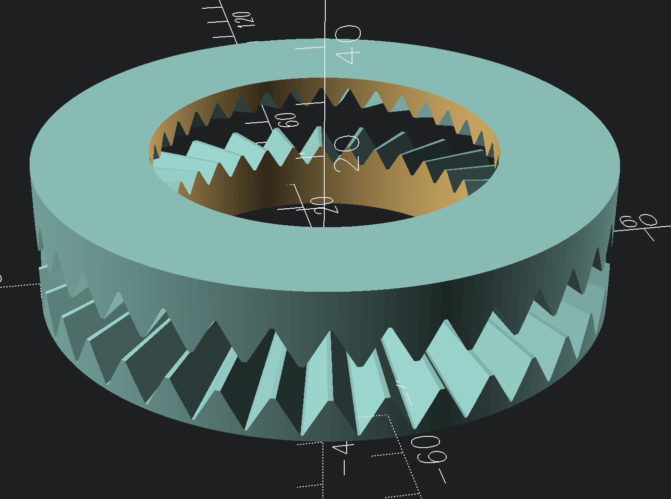

Linear extrude works well too. The peaks and valleys can be rounded, which doesn’t seem to be possible with polyhedrons. The flat side isn’t, and needs to be filled in with a cone to make it flat.

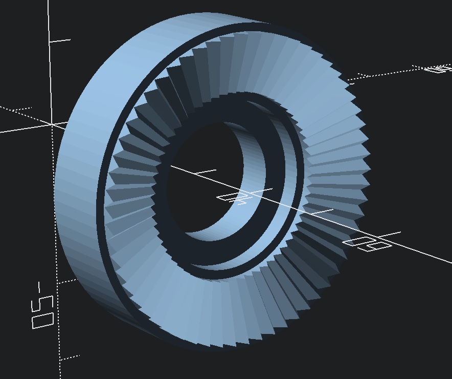

I got interested in the Hirth joint problem since I now know the name and understand what’s going on. Also, the part I needed to make had a conical Hirth joint. I was curious how that could be parameterized. It turned out to be fairly simple. Here is the current state of my test program. It uses BOSL2, but not my own library. It’s set up with the customizer so it’s easy to play around with. I’m running it on OpenSCAD.24.09.20 and BOSL2 from maybe a couple of months ago. It’s not entirely debugged, but works. Using hull and cheating a little, the math is minimal. It’s all in calculating toothBaseWidth and toothHeight. The “cheat” is that I hull the tooth profile with a tiny cube at the origin. For a conical joint, the origin just moves up. Most of the code is actually there to provide the base above or below the teeth. That’s where I think bugs still lurk.
