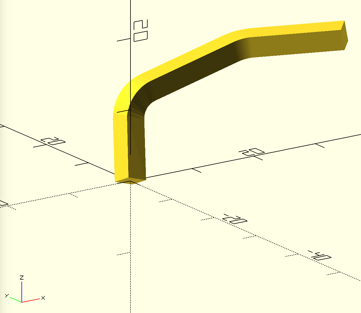

Fri, Jan 27, 2023 5:21 AM
it would be better to give a path without sharp corners and which is also
practically feasible.
then the testing could be more meaningful as per my understanding.
example:
[image: Screenshot 2023-01-27 at 10.40.32 AM.png]

it would be better to give a path without sharp corners and which is also practically feasible. then the testing could be more meaningful as per my understanding. example: [image: Screenshot 2023-01-27 at 10.40.32 AM.png] On Thu, 26 Jan 2023 at 21:56, Guenther Sohler <guenther.sohler@gmail.com> wrote: > Hi List, > > right now i am attempting to add a path_extrude function to openscad > A demonstration what i am talking about is here: > > https://youtu.be/igMupYGvX1s > > (sorry, its in python, but still i hope you get the idea. ) > This shows an arbitrary path_extrude of a square, > but in the video you can clearly see the triangles in the faces, > so i believe the cross section at the joints is not correct. > IMHO the square must turn to a deltoid especially when the base square is > rotated by 45 degrees to be correct. > Can anybody shade some light on that for me ? > > > _______________________________________________ > OpenSCAD mailing list > To unsubscribe send an email to discuss-leave@lists.openscad.org >

Sanjeer, Thank you for your input.
Your output looks very impressive and I want to reach that too.
Personally I believe the challenge is to get it correct with very few
points first.
The error will be much more clearly visible when choosing few points.
Finally, using many points to make it look smooth is just exercise.
Probably
spline and many other functions are viable.
Maybe its also there in BOSL2, will check later.
Thank you for your answers!
is rotated by 45 degrees to be correct.

Guenther, I'm a little unsure of your goal here.  If you are excited to
implement path_sweep for the fun of it that's fine, of course, but this has
been done before by many people in OpenSCAD, starting with
list-comprehension-demos and also in dotSCAD, and BOSL2.  These methods
exist already as OpenSCAD code. so a demonstration isn't needed to show the
possibilities. There are some very difficult questions about how to rotate
the cross sections as you move around the path, and yes, it's entirely
possible that you've gotten it wrong...assuming that you can figure out
what "wrong" means.  It's not clear.  There was a very long thread on the
forum many years ago about the various complications.  I implemented
several different algorithms in BOSL2 for choosing how to line up the
sections.  You might want to take a look to get more understanding of the
issues.

Hi Adrian,
There are many great effects, which you can achieve when  having the points
of the path wide enough apart.
Of course The Tangent and the normals (but especially the angle between x
and y axis) need be correct, but then it looks really cool.
With my approach I can easily immitate your solution by using many points
close together and skip the axis scaling(maybe worth an option)
My Vision and my approach which I have chosen actually came true.
https://www.youtube.com/watch?v=1m5OeK2lW4U
if  it's too different from BOSL extrude maybe we can choose another name .
