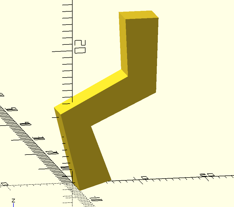

Guenther, I'm not sure what you mean.  Having points widely spaced can be
done, of course.  It's just harder to define the problem, I think, so
perhaps not the place to start.  Nothing in BOSL2 assumes anything about
point spacing, but if the points are far apart you may find that you don't
like the automatically computed derivatives, especially if the path is very
short.  And transitions between the sections may be more likely to do
something odd.  Consider a rectangle that is 10 x 3.  What are the
derivatives at the end?  Are they 45 deg angles?  Or do they respect the
aspect ratio of the rectangle?  Either option can be defended as correct.
The BOSL2 implementation is very general and should be able to handle any
situation, as long as the sections don't lead to a self-intersecting and
hence invalid polyhedron.

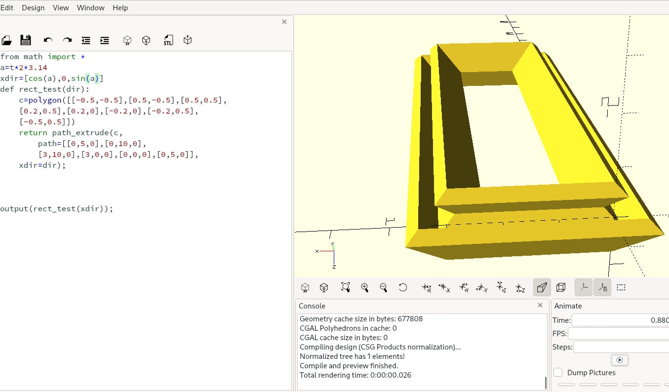

Hi List,
right now i am attempting to add a path_extrude function to openscad
A demonstration what i am talking about is here:
https://youtu.be/igMupYGvX1s
(sorry, its in python, but still i hope you get the idea. )
This shows an arbitrary path_extrude of a square,
but in the video you can clearly see the triangles in the faces,
so i believe the cross section at the joints is not correct.
IMHO the square must turn to a deltoid especially when the base
square
is rotated by 45 degrees to be correct.
Can anybody shade some light on that for me ?

Hi Adrian, when i Use an rectangle 10x3 as a Profile , this Profile is
present in any Cross Section along the path when little apart from the
Corners of course.
This ist Independent from the original Rotation of the path or the Angles
between the path Segments.as Well as i. Bosl2: faces must Not interec.but
watch the Video. Pictures Tell more than 1000 words.

GS
Guenther Sohler
Fri, Jan 27, 2023 11:08 PM
Hi Adriano,
Sorry, I got you wrong apparently.
I am now using a rectangle 3x10 as the extrude path and I have created a
polygon, which looks like an "U" Shape.
The thing rotates successfully  around the extrusion axis all 360 degrees
and there aren't manifold problems at all during that time.
In each corner the successor segment has exactly one orientation where it
fits, so I believe it's not ambiguous at all.
And yes, my implementation is missing the "closed loop option" but I can
implement that next.

Hi Adriano,

I have tried your example by creating slices of the solid produced from
path_extrude and it produces the right result
[image: Screenshot 2023-01-28 at 4.03.49 PM.png]
I had to write a code for creating slices for the path_extruded solid
nevertheless

Sat, Jan 28, 2023 12:40 PM
Hi Sanjeev, IT Looks great!
But i am Sure that its Not the result of my path_extrude. When extruding
its important to me, that the Cross Section ist constant through all length.
In your Pictures i See that the Profile becomes smaller towards the Corner.
In Order to compensate for that you Need to compensate this Loss of Profile
by the Inverterted  Dot-product. Have a Look into my checked in Code, Then
you will exactly realize, what i am talking About 😃

Hi Sanjeev, IT Looks great! But i am Sure that its Not the result of my path_extrude. When extruding its important to me, that the Cross Section ist constant through all length. In your Pictures i See that the Profile becomes smaller towards the Corner. In Order to compensate for that you Need to compensate this Loss of Profile by the Inverterted Dot-product. Have a Look into my checked in Code, Then you will exactly realize, what i am talking About 😃 Sanjeev Prabhakar <sprabhakar2006@gmail.com> schrieb am Sa., 28. Jän. 2023, 11:40: > I have tried your example by creating slices of the solid produced from > path_extrude and it produces the right result > [image: Screenshot 2023-01-28 at 4.03.49 PM.png] > > I had to write a code for creating slices for the path_extruded solid > nevertheless > > On Thu, 26 Jan 2023 at 21:56, Guenther Sohler <guenther.sohler@gmail.com> > wrote: > >> Hi List, >> >> right now i am attempting to add a path_extrude function to openscad >> A demonstration what i am talking about is here: >> >> https://youtu.be/igMupYGvX1s >> >> (sorry, its in python, but still i hope you get the idea. ) >> This shows an arbitrary path_extrude of a square, >> but in the video you can clearly see the triangles in the faces, >> so i believe the cross section at the joints is not correct. >> IMHO the square must turn to a deltoid especially when the base square is >> rotated by 45 degrees to be correct. >> Can anybody shade some light on that for me ? >> >> >> _______________________________________________ >> OpenSCAD mailing list >> To unsubscribe send an email to discuss-leave@lists.openscad.org >> > _______________________________________________ > OpenSCAD mailing list > To unsubscribe send an email to discuss-leave@lists.openscad.org >
