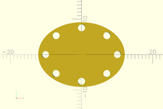

I created a oval by using scale().  I would like to position screw holes
along the oval, but I can't see how to use scale() to change the x/y
values for translate().
Thanks

To do that you put scale outside (in front of) the translate.  But I
wouldn't recommend it: the scale will turn your screw hole into ovals, so
you'll need a second scale inside to undo it and turn them back into
circles, which seems like a complicated and error-prone way to do things.

I would use trigonometry. Here’s a short code snippet to give you an idea.
scale = 0.75;
r = 10; // radius of holes
eps = 0.001;
$fn = 60;
linear_extrude(1)
scale([1,0.75,1])
circle(r + 2);
 for (i=[0:45:359])
     x = cos(i) * r;
     y = sin(i) * r * scale;
     translate([x,y, -eps])
     linear_extrude(1 + 2 * eps)
     circle(1);

That's essentially the solution I was suggesting written out in detail.  I
wonder if OP had in mind that the holes were being created without explicit
trig, like maybe for(ang=[0:45:359]) rotate([0,0,ang])
translate([radius,0,0]) hole().  If that's how you're placing holes then an
approach like that doesn't work because the coordinates are hidden by the
rotate.

See, I was just assuming that you were starting with the point centers
where you wanted the holes.  In BOSL2 you can still use rot() to produce
those without needing explicit trig.  So something like
pts = [for(ang=lerpn(0,360,8,endpoint=false) zrot(ang,[a,0])];
Then you can loop over pts and translate them with an x factor, or even use
xscale in the loop.
Jordan, There is no "easy" way to put holes evenly along an ellipse.  That
requires ellipse arc length which is well known as a problem with no closed
form solution.  Furthermore, if you want constant inset, the solution is no
longer even an ellipse.    That's why I suggested the method I did:  inset
an elliptical path with the BOSL2 offset function and then use path_copies
to put holes on it at uniform spacing, which "solves" the ellipse arc
length problem by using the path and directly measuring the lengths of all
the segments.
include<BOSL2/std.scad>
$fs=.1;
$fa=1;
a=10;
b=7;
path = ellipse([a,b]);
inset = offset(path, delta=-1.5);
polygon(path);
color("black")
path_copies(inset, n=8,closed=true) circle(d=1);
