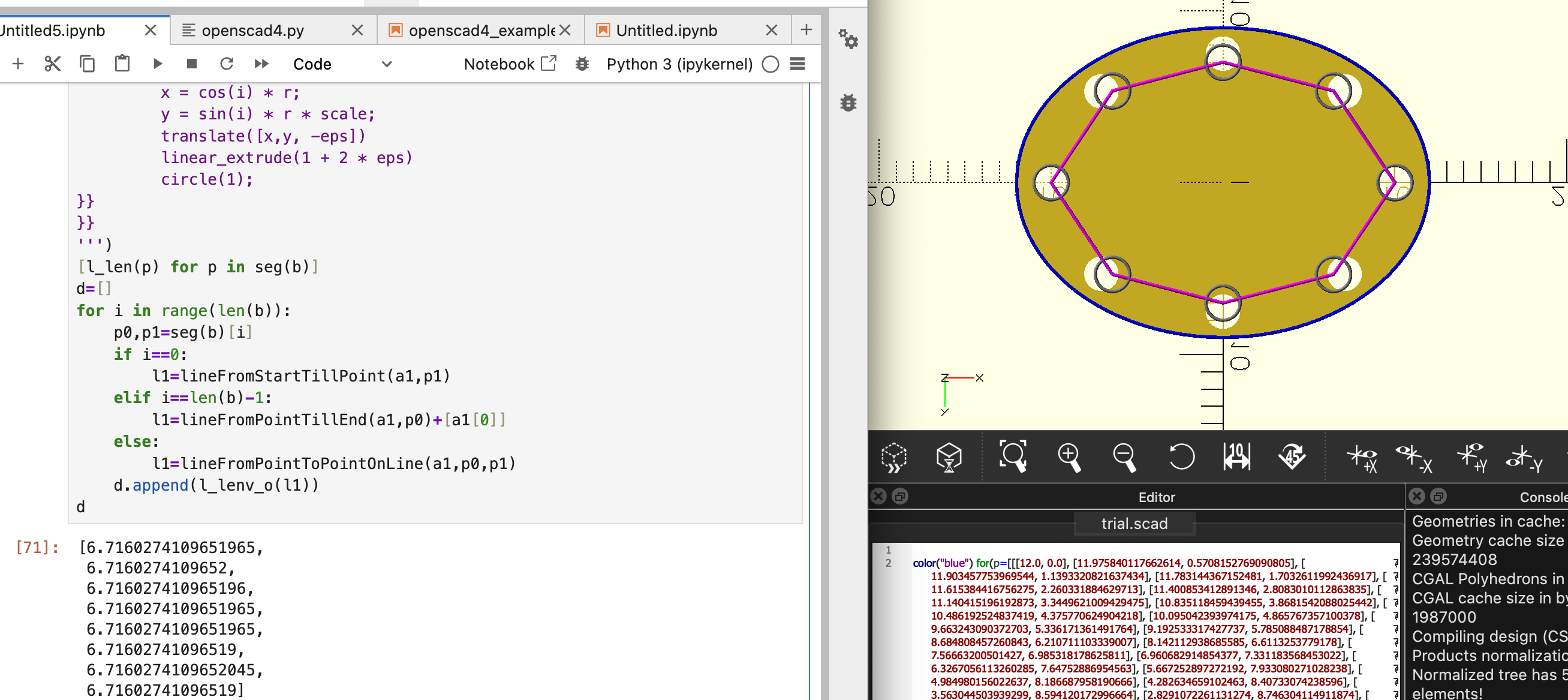

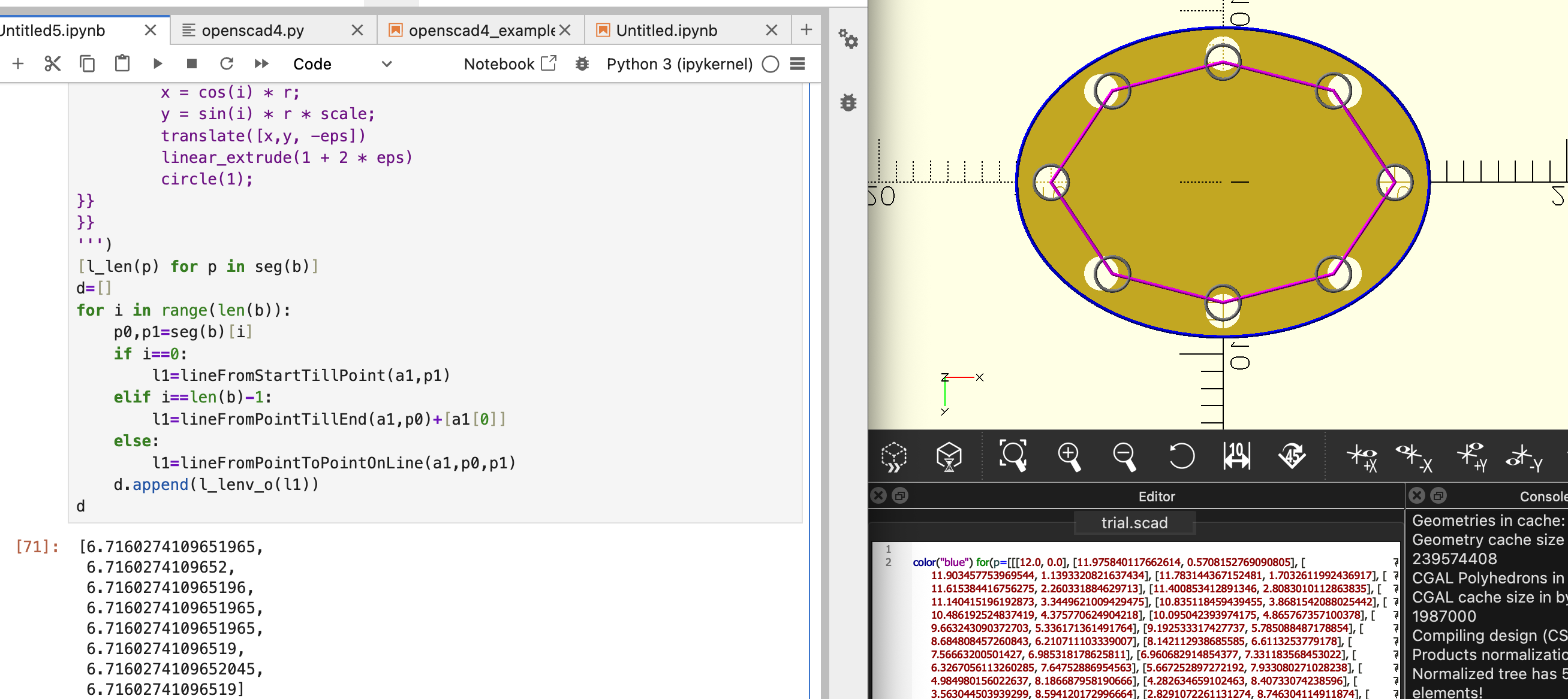

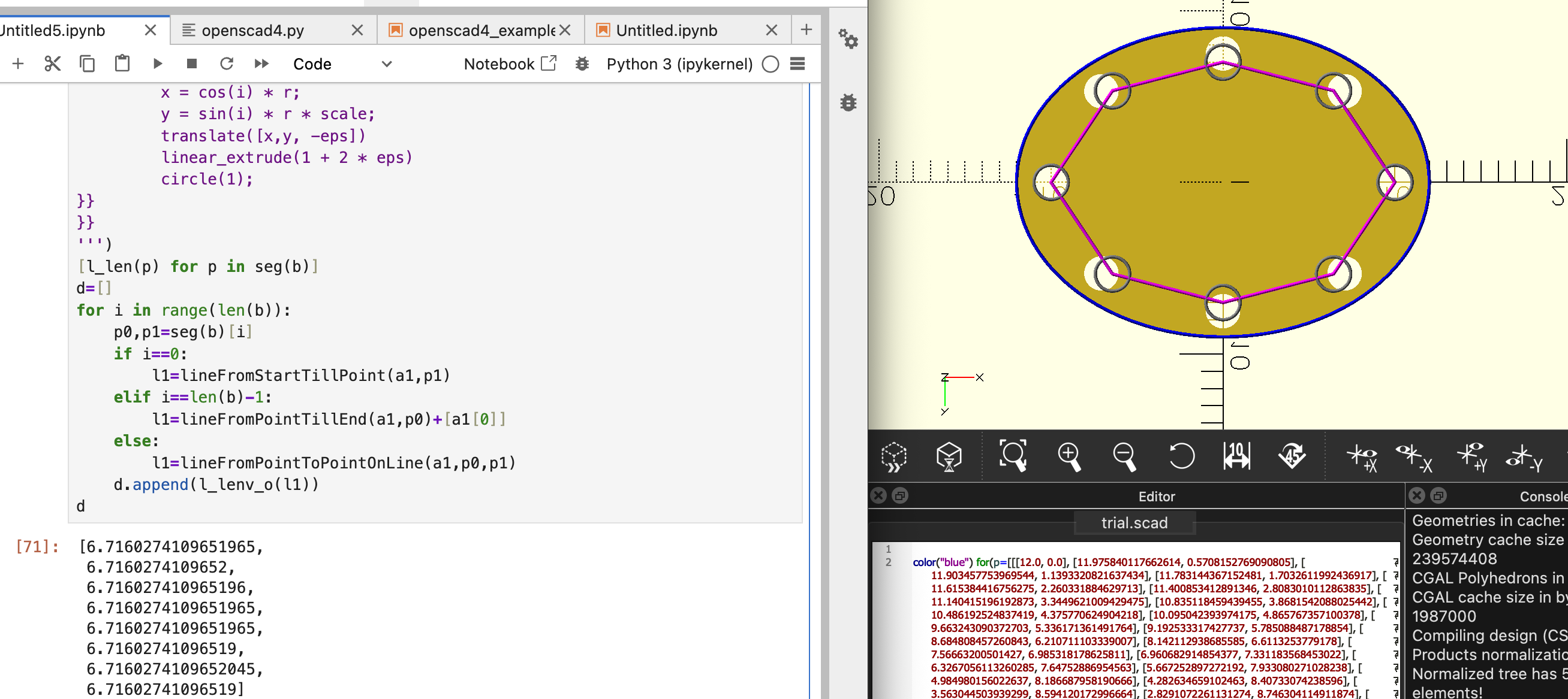

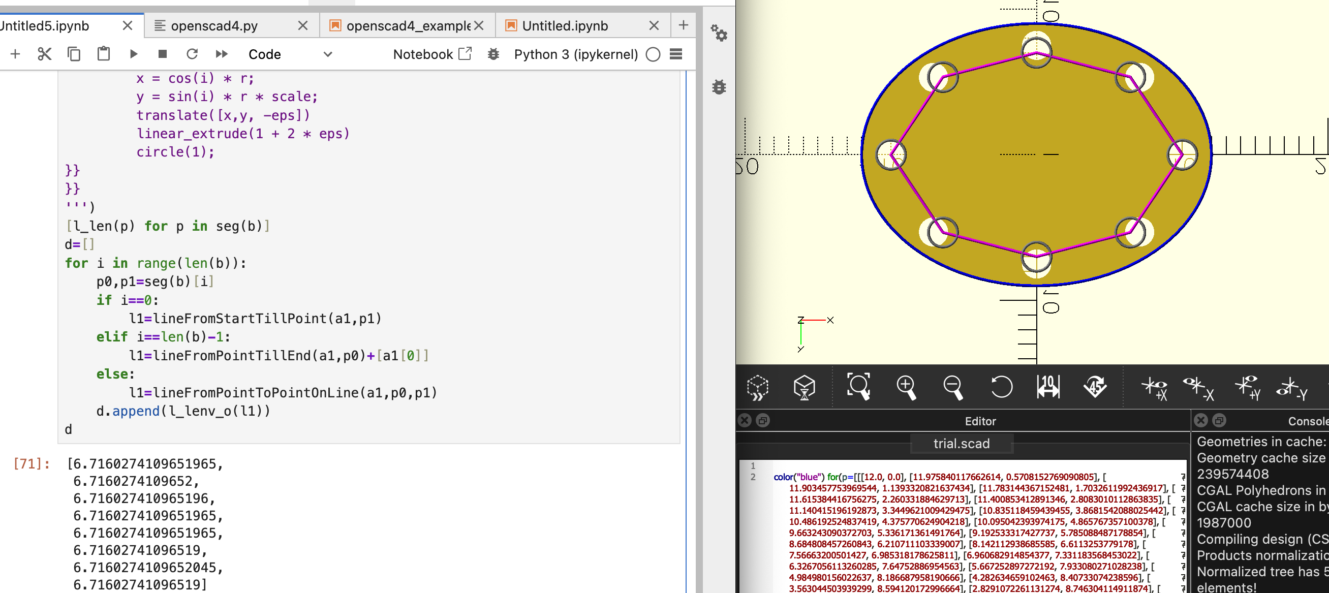

It seems the solution by Mr.Mark is not equally spaced circles
Below the superimposed picture you can see the difference.
The marked circles are equally spaced to >10 decimal points.
[image: Screenshot 2026-04-29 at 9.46.19 PM.png]

It seems the solution by Mr.Mark is not equally spaced circles Below the superimposed picture you can see the difference. The marked circles are equally spaced to >10 decimal points. [image: Screenshot 2026-04-29 at 9.46.19 PM.png] On Wed, 29 Apr 2026 at 16:38, jon jonbondy.com via Discuss < discuss@lists.openscad.org> wrote: > Interesting that something so apparently simple is not. > > > On 4/28/2026 9:45 PM, Jordan Brown wrote: > > On 4/28/2026 6:01 PM, Jon Bondy via Discuss wrote: > >> > >> Yes. Exactly. I wanted to use a for() and rotate() to spread the > >> holes around the circle and then scale() it to get them in the right > >> location. Nice concept. Not easy to implement. > >> > >> Mark's trig approach seems like the best so far > >> > > Note that the trig approach does not yield evenly spaced holes, except > > in some distorted-angle sense. > > > > > > I messed around for a while trying to find a for()-rotate() answer, > > but failed. It seems like there ought to be one, probably pretty > > ugly, but I'm not coming up with it. > > > > > > > _______________________________________________ > OpenSCAD mailing list > To unsubscribe send an email to discuss-leave@lists.openscad.org
This is asking AI to write code that already exists in libraries including BOSL2. It looks like the same solution as path_copies. On Wed, Apr 29, 2026 at 12:53 Raymond West via Discuss < discuss@lists.openscad.org> wrote: > after a bit of my description and explanation, deepseek came up with the > following, for equally spaced points around an ellipse > > // ===== User parameters ===== > dp = 200; // Diameter of original circle > num_points = 7; // Number of equally spaced points > start_angle_deg = 90; // Starting angle in degrees (0 = right, 90 = > top) > step_deg =0 .1; // Integration step in degrees (smaller = > more accurate, but more recursions) > ellipse_smoothness = 120; // $fn for the ellipse (higher = smoother) > > // ===== Ellipse geometry (scale([1,1.5]) circle) ===== > a = dp / 2; // semi‑axis X = 100 > b = 1.5 * dp / 2; // semi‑axis Y = 150 > > // Point on ellipse for angle in degrees > function pt(phi_deg) = [a * cos(phi_deg), b * sin(phi_deg)]; > > // Derivative with respect to degrees (includes PI/180 conversion) > function dx_dphi(phi_deg) = -a * sin(phi_deg) * PI/180; > function dy_dphi(phi_deg) = b * cos(phi_deg) * PI/180; > function ds(phi_deg) = norm([dx_dphi(phi_deg), dy_dphi(phi_deg)]); > > // Build list of phi from 0 to 360 degrees (inclusive) > phi_list = [ for (i = [0:step_deg:360]) i ]; > > // Recursively compute cumulative arc lengths (depth = len(phi_list)-1 ≈ > 180) > function cum_arcs(i = 0, cum = 0, result = [0]) = > i >= len(phi_list)-1 ? result : > let( dphi = phi_list[i+1] - phi_list[i], > ds_mid = (ds(phi_list[i]) + ds(phi_list[i+1])) / 2, > new_cum = cum + ds_mid * dphi ) > cum_arcs(i+1, new_cum, concat(result, [new_cum])); > > arc_cum = cum_arcs(); // cumulative arc lengths > total_len = arc_cum[len(arc_cum)-1]; // full circumference > step_len = total_len / num_points; // arc length between points > > // Linear search to find phi for a given target arc length > function phi_for_arc(target, idx = 0) = > idx >= len(arc_cum)-1 ? phi_list[len(phi_list)-1] : > target <= arc_cum[idx+1] ? > let( t = (target - arc_cum[idx]) / (arc_cum[idx+1] - arc_cum[idx]) > ) > phi_list[idx] + t * (phi_list[idx+1] - phi_list[idx]) : > phi_for_arc(target, idx+1); > > // Generate points equally spaced by arc length, starting at > start_angle_deg. > // We offset the target arc lengths so that the first point lies at > start_angle_deg. > // First find the arc length from 0 to start_angle_deg: > start_arc = phi_for_arc(start_angle_deg) ? > // phi_for_arc returns phi, not arc. We need arc at that phi. Use > linear interpolation. > let( idx = floor(start_angle_deg / step_deg), > t = (start_angle_deg - phi_list[idx]) / (phi_list[idx+1] - > phi_list[idx]), > arc = arc_cum[idx] + t * (arc_cum[idx+1] - arc_cum[idx]) ) arc : > 0; > > points = [ for (k = [0:num_points-1]) > let( target = start_arc + k * step_len ) > let( wrapped = target % total_len ) > pt(phi_for_arc(wrapped)) ]; > > // ===== Draw the smoothed ellipse ===== > scale([1, 1.5]) circle(d = dp, $fn = ellipse_smoothness); > > // ===== Draw the points ===== > color("red") > for (p = points) translate(p) circle(r = 2.5, $fn = 16); > > // ===== Debug output ===== > echo("Total circumference =", total_len); > echo("Step length =", step_len); > echo("Start angle =", start_angle_deg, "degrees"); > echo("Points (x,y):"); > for (p = points) echo(p); > On 29/04/2026 17:22, Sanjeev Prabhakar via Discuss wrote: > > It seems the solution by Mr.Mark is not equally spaced circles > Below the superimposed picture you can see the difference. > The marked circles are equally spaced to >10 decimal points. > > [image: Screenshot 2026-04-29 at 9.46.19 PM.png] > > > On Wed, 29 Apr 2026 at 16:38, jon jonbondy.com via Discuss < > discuss@lists.openscad.org> wrote: > >> Interesting that something so apparently simple is not. >> >> >> On 4/28/2026 9:45 PM, Jordan Brown wrote: >> > On 4/28/2026 6:01 PM, Jon Bondy via Discuss wrote: >> >> >> >> Yes. Exactly. I wanted to use a for() and rotate() to spread the >> >> holes around the circle and then scale() it to get them in the right >> >> location. Nice concept. Not easy to implement. >> >> >> >> Mark's trig approach seems like the best so far >> >> >> > Note that the trig approach does not yield evenly spaced holes, except >> > in some distorted-angle sense. >> > >> > >> > I messed around for a while trying to find a for()-rotate() answer, >> > but failed. It seems like there ought to be one, probably pretty >> > ugly, but I'm not coming up with it. >> > >> > >> > >> _______________________________________________ >> OpenSCAD mailing list >> To unsubscribe send an email to discuss-leave@lists.openscad.org > > > _______________________________________________ > OpenSCAD mailing list > To unsubscribe send an email to discuss-leave@lists.openscad.org > > _______________________________________________ > OpenSCAD mailing list > To unsubscribe send an email to discuss-leave@lists.openscad.org
Wed, Apr 29, 2026 9:23 PM
That is all that most folk do, find something that already exists.
That is why the cheap llms are better at python, than openscad, say,
since there is far more of it out there. The fun then comes in sorting
the good from the bad. fwiw, deepseek logs where it is looking, what
it tests, revises etc. I think it has more emphasis on its neuralnet,
or euivalent.
