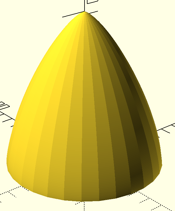

On the subject of rocket nosecones, I created an OpenSCAD model some time ago
to generate Haack series shapes:
https://www.thingiverse.com/thing:804129
These shapes are calculated to minimize drag in supersonic flows, so not
something that is functionally useful for model rockets. Still, I thought it
might be of interest.
Some work would need to be done to make it suitable for fitting to a rocket.
Of course I only see this post AFTER I wrote my own.  :)
Well, I might as well post it:
pi = 3.1415926536;
function haack(x, L, R, C) = let(
h = acos(1-(2x/L))
) (R/sqrt(pi)) * sqrt(h
pi/180 - sin(2h)/2 + Cpow(sin(h),3));
function haack_series(L, R, C, steps) = [
for(i = [0:steps]) let(x = i*L/steps) [x, haack(x, L, R, C)]
// L is the length of the nosecone.
// R is the radius of the nosecone base.
// C should be 0 for a Von-Kármán ogive.
// steps is the granularity of the shape along the length.
module haack_nosecone(L, R, C=0, steps=100) {
pts=concat(
haack_series(L, R, C, steps),
[[L, R], [L, 0], [0, 0]]
translate([0,0,L]) {
rotate_extrude(angle=360, convexity=2) {
rotate([0,0,-90]) polygon(points=pts);
haack_nosecone(L=80, R=50, C=0);

Thanks for the code. I'll have to tinker with it a while. I also found this
code on another discussion forum, I added the sphere and was trying to merge
it with the cone.
// rotate-extrude test
// by Oliver Fenn
$fn=64; // Bem .: 2nd power
// Shaping function x from [x0: xe], steadily increasing in [x0: xe]
x0=0.0;
xe=1.0;
// Examples:
// x, xx, xxx,
// 1-sin(acos(x)), 1-cos(90x), 1-cos(180x), sin(90x)
// log(x+1), 1-1/(x+1)
function f(x) = 1-sin(acos(x)); // ball, at half the height of the diameter!
// Two-dimensional polygon determined by f (x), x from [x0: xe]
module shape (start, end, to)
steps = (end-start)/to;
polygon
for(x=[start:steps:(end+steps)])
(x<=end)?[x-start, f(x)-f(start)]:[0, f(end)-f(start)]
} // shape
// cone over radius and height
module cone_r (rad, height)
hfact = height/(f(xe)-f(x0));
translate([34, 34, height])
mirror([0, 0, 1])
scale([rad/(xe-x0), rad/(xe-x0), hfact]) // Scale the cone to size
rotate_extrude()
shape(x0, xe, $fn);
} // cone_r
// construction
//added by FourthDr
translate([34,34,112.5])
sphere(3., $fn=100);
cone_r(16.945, 114.94);
// join cone_r and sphere
