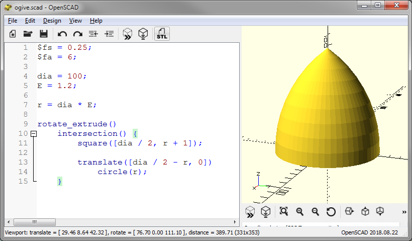

Tue, Sep 4, 2018 8:03 AM
I had to look up https://en.wikipedia.org/wiki/Ogive. Looks like you can
rotate_extrude the intersection of a circle and a square.
On 4 September 2018 at 08:21, Troberg troberg.anders@gmail.com wrote:

Tue, Sep 4, 2018 10:31 AM
From the diagram on Wikipedia I saw that half the cross section of an ogive
is the intersection of a circle and a rectangle.
To blunt the point you need to position another circle that is tangential
to the first one and truncate the ogive at the tangential point and then
hull it with a semi circle.
Using the formula here: http://mathworld.wolfram.com/TangentCircles.html

Or, if you have access to a CAD program that creates DXF files you could draw
the ogive shape as a cross section of a shell and import it.
http://forum.openscad.org/file/t1309/ogive.jpg
Or, if you have access to a CAD program that creates DXF files you could draw the ogive shape as a cross section of a shell and import it. <http://forum.openscad.org/file/t1309/ogive.jpg> -- Sent from: http://forum.openscad.org/
