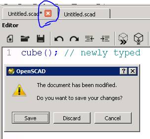

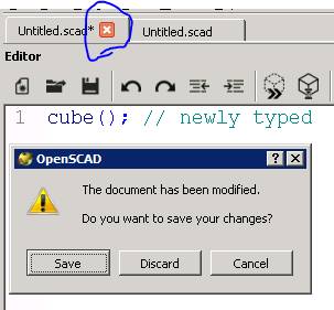

OK I have been an idiot and whilst distracted by my other half I closed all open windows and not just the one - loosing about an hours work in Openscad.
So in hope more than anticipation I looked in my  Documents/Openscad/backups folder and nothing has been saved there since 2020.  Just checked my Privacy Preferences and Openscad does have write access to my documents folder.
Is autosave switched off in the development line, or have I misunderstood when autosave operates ?  I had loaded macOS 220114 this morning….

Do you se something like this when you F5 or F6 with unsaved changes?
Saved backup file: C:/Users/MeB/Documents/OpenSCAD/backups/unsaved-backup-ncSSIhWS.scad
Also closing with unsaved changes should get:
Do you?

One issue is that now if you use the customiser it marks the document as
changed, when it isn't, so I get used to ignoring those warnings as I never
save customiser settings.

Not on Mac - there is the “*” in the file title - the problem arose because I opened the second file from finder which opens it in a separate window and not in a tab - so I had two windows open and not two tabs.
I went to OpenScad-> Quit Openscad on the active window which had no changes expecting it to quit that window and it quit both windows simultaneously without a save prompt for all of the changed data in the other window….
