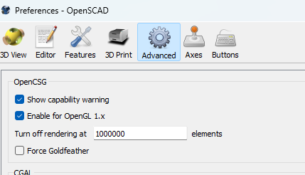

I realize that this code is long, but when I try to make it simpler, the
bug fails to occur.
The bug is that if the for() at the end is [0:0], it works, but [0:1]
blows up with the following (and OpenSCAD is dead and has to be
restarted).  Seems simple enough.  Making one works, making two is
fatal.  I'm sure the problem is simple, but not to me, at the moment.
Thanks

WARNING: Normalized tree is growing past 200000 elements. Aborting
normalization.
Execution aborted

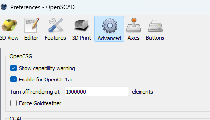

Just set a higher limit in preferences.

nop head:
Thanks.
This is what happens for [0:0]:
Saved backup file:
C:/Users/jon/OneDrive/Documents/OpenSCAD/backups/test-backup-loVopDsc.scad
Used file cache size: 1 files
ECHO: 23.25
Geometries in cache: 2
Geometry cache size in bytes: 26408
CGAL Polyhedrons in cache: 0
CGAL cache size in bytes: 0
Normalized tree has 2686 elements!
Compile and preview finished.
Total rendering time: 0:00:00.487
So, 26K in geometry cache and 2.5K elements for one object.
Then everything explodes for 2 objects?!?
And OpenSCAD dies?!?
This seems very extreme for a minor change in geometry.
I hope others chime in.

I have a much higher limit set in preferences, and your code works fine.

I have a much higher limit set in preferences, and your code works fine. On 2026-01-21 08:23, nop head via Discuss wrote: > Just set a higher limit in preferences. > > On Tue, 20 Jan 2026 at 21:15, Jon Bondy via Discuss <discuss@lists.openscad.org> wrote: > > I realize that this code is long, but when I try to make it simpler, the bug fails to occur. > > The bug is that if the for() at the end is [0:0], it works, but [0:1] blows up with the following (and OpenSCAD is dead and has to be restarted).  Seems simple enough. Making one works, making two is fatal.  I'm sure the problem is simple, but not to me, at the moment. > > Thanks > > Jon > > > > Parsing design (AST generation)... > > Used file cache size: 1 files > > Compiling design (CSG Tree generation)... > > ECHO: 23.25 > > Compiling design (CSG Products generation)... > > Geometries in cache: 2 > > Geometry cache size in bytes: 26408 > > CGAL Polyhedrons in cache: 0 > > CGAL cache size in bytes: 0 > > Compiling design (CSG Products normalization)... > > WARNING: Normalized tree is growing past 200000 elements. Aborting normalization. > > > Execution aborted > > > > > > > include <BOSL2/std.scad> > > eps = 0.01; > $fa = 3; > $fs = 0.2; > inches = 25.4; > slop = 0.3;                // printing slop > > hth = 6.88;                // thickness along curve horizontal thickness > vth = 4.83;                // actual vertical thickness > ll = 21.25;                // link length > // angles and diameters for rotation that creates the curved shape > id = 18.07; > od = id + hth; > ad = (id + od) / 2;        // average diameter > an = round(asin(ll/ad))/2;    // angle corresponding to "ll" > aSp = 12;                // space between axels > xSp = ll + 2.0;            // spacing of links > echo(xSp); > pd = 2.62 + slop;        // pin diameter > > //  clearance around axle: I used 0.7, but metal printing needs 1.5 > fmp = 0.0;                // more clearance For Metal Printing (0.8) > clrc = 0.0;                // clearance for clasp > clra = 0.0;                // clearance for axles > > module LinkShape() >     // hull() rotated cylinders to make curved shape >     for (a = [-an/2:1:an/2]) >         rotate([0, 0, a]) >             translate([ad, 0, 0]) >                 cylinder(h = vth, d = hth); > *LinkShape(); > > module AxelHoles(sc) { >     // "sc" allows cylinder diameter to be scaled for holes vs pins >     aa = 0.40 * an;        // axle hole angles >     for (a = [-aa, aa]) >         rotate([0, 0, a]) >             translate([ad, 0, -eps]) >                 cylinder(h = vth + 2*eps, d = pd*sc); >     } > > module Link(cutHoles) >     rotate([0, -90, 90]) >         //           Y >         translate([-ad, 0, 0]) { >             difference() { >                 LinkShape(); >                 if (cutHoles) >                     AxelHoles(1); >                 } >             } > *Link(true); > > module PinAlignmentJig() { >     difference() { > *        translate([-12.5, -7.5, 0]) >             cube([25, 15, 2*vth+1]); >         // link shape >         translate([0, 0, 2*vth - eps]) >             scale([1.2, 1.4, 2.0]) >                 rotate([90, 0, 0]) >                     Link(false); >         // the bottom link >         translate([0, 0, vth - eps]) >             rotate([90, 0, 0]) >                 scale(1.04) >                     Link(false); >         // the top link >         translate([0, 0, 2*vth + 1 + eps]) >             rotate([90, 0, 0]) >                 scale(1.04) >                     Link(false); >         // holes >         translate([0, 21.51, -2]) >             rotate([0, 0, -90]) >                 scale([1, 1, 9]) >                     AxelHoles(1); >         } >     } > *PinAlignmentJig(); > > module PinAlignmentJigs() { >     for (i = [0:1]) >         translate([0, i*20, 0]) >             PinAlignmentJig(); >     } > !PinAlignmentJigs(); > > > <http://www.avg.com/email-signature?utm_medium=email&utm_source=link&utm_campaign=sig-email&utm_content=emailclient> Virus-free.www.avg.com <http://www.avg.com/email-signature?utm_medium=email&utm_source=link&utm_campaign=sig-email&utm_content=emailclient> > > <#m_4427835302210338701_DAB4FAD8-2DD7-40BB-A1B8-4E2AA1F9FDF2> > _______________________________________________ > OpenSCAD mailing list > To unsubscribe send an email to discuss-leave@lists.openscad.org > > > _______________________________________________ > OpenSCAD mailing list > To unsubscribe send an email todiscuss-leave@lists.openscad.org -- Cheers, Ken bats059@gmail.com https://vk7krj.com https://vk7krj.com/running.html ---------------------------------------- A baby can be defined as an ego with a noise at one end and a smell at the other. Your job as parents is to teach them to control all three. My job as a grandad is to tell you how you are doing it all wrong!
 the moment.
 Thanks

Thanks. I looked in Preferences for "normalized tree" and could not find anything. What tab is this setting in, and what is it called, please? Jon On 1/20/2026 4:31 PM, Ken via Discuss wrote: > I have a much higher limit set in preferences, and your code works fine. > > > On 2026-01-21 08:23, nop head via Discuss wrote: >> Just set a higher limit in preferences. >> >> On Tue, 20 Jan 2026 at 21:15, Jon Bondy via Discuss >> <discuss@lists.openscad.org> wrote: >> >> I realize that this code is long, but when I try to make it >> simpler, the bug fails to occur. >> >> The bug is that if the for() at the end is [0:0], it works, but >> [0:1] blows up with the following (and OpenSCAD is dead and has >> to be restarted).  Seems simple enough.  Making one works, making >> two is fatal.  I'm sure the problem is simple, but not to me, at >> the moment. >> >> Thanks >> >> Jon >> >> >> >> Parsing design (AST generation)... >> >> Used file cache size: 1 files >> >> Compiling design (CSG Tree generation)... >> >> ECHO: 23.25 >> >> Compiling design (CSG Products generation)... >> >> Geometries in cache: 2 >> >> Geometry cache size in bytes: 26408 >> >> CGAL Polyhedrons in cache: 0 >> >> CGAL cache size in bytes: 0 >> >> Compiling design (CSG Products normalization)... >> >> WARNING: Normalized tree is growing past 200000 elements. >> Aborting normalization. >> >> >> Execution aborted >> >> >> >> >> >> >> include <BOSL2/std.scad> >> >> eps = 0.01; >> $fa = 3; >> $fs = 0.2; >> inches = 25.4; >> slop = 0.3;                // printing slop >> >> hth = 6.88;                // thickness along curve horizontal >> thickness >> vth = 4.83;                // actual vertical thickness >> ll = 21.25;                // link length >> // angles and diameters for rotation that creates the curved shape >> id = 18.07; >> od = id + hth; >> ad = (id + od) / 2;        // average diameter >> an = round(asin(ll/ad))/2;    // angle corresponding to "ll" >> aSp = 12;                // space between axels >> xSp = ll + 2.0;            // spacing of links >> echo(xSp); >> pd = 2.62 + slop;        // pin diameter >> >> //  clearance around axle: I used 0.7, but metal printing needs 1.5 >> fmp = 0.0;                // more clearance For Metal Printing (0.8) >> clrc = 0.0;                // clearance for clasp >> clra = 0.0;                // clearance for axles >> >> module LinkShape() >>     // hull() rotated cylinders to make curved shape >>     for (a = [-an/2:1:an/2]) >>         rotate([0, 0, a]) >>             translate([ad, 0, 0]) >>                 cylinder(h = vth, d = hth); >> *LinkShape(); >> >> module AxelHoles(sc) { >>     // "sc" allows cylinder diameter to be scaled for holes vs pins >>     aa = 0.40 * an;        // axle hole angles >>     for (a = [-aa, aa]) >>         rotate([0, 0, a]) >>             translate([ad, 0, -eps]) >>                 cylinder(h = vth + 2*eps, d = pd*sc); >>     } >> >> module Link(cutHoles) >>     rotate([0, -90, 90]) >>         //           Y >>         translate([-ad, 0, 0]) { >>             difference() { >>                 LinkShape(); >>                 if (cutHoles) >>                     AxelHoles(1); >>                 } >>             } >> *Link(true); >> >> module PinAlignmentJig() { >>     difference() { >> *        translate([-12.5, -7.5, 0]) >>             cube([25, 15, 2*vth+1]); >>         // link shape >>         translate([0, 0, 2*vth - eps]) >>             scale([1.2, 1.4, 2.0]) >>                 rotate([90, 0, 0]) >>                     Link(false); >>         // the bottom link >>         translate([0, 0, vth - eps]) >>             rotate([90, 0, 0]) >>                 scale(1.04) >>                     Link(false); >>         // the top link >>         translate([0, 0, 2*vth + 1 + eps]) >>             rotate([90, 0, 0]) >>                 scale(1.04) >>                     Link(false); >>         // holes >>         translate([0, 21.51, -2]) >>             rotate([0, 0, -90]) >>                 scale([1, 1, 9]) >>                     AxelHoles(1); >>         } >>     } >> *PinAlignmentJig(); >> >> module PinAlignmentJigs() { >>     for (i = [0:1]) >>         translate([0, i*20, 0]) >>             PinAlignmentJig(); >>     } >> !PinAlignmentJigs(); >> >> >> <https://urldefense.proofpoint.com/v2/url?u=http-3A__www.avg.com_email-2Dsignature-3Futm-5Fmedium-3Demail-26utm-5Fsource-3Dlink-26utm-5Fcampaign-3Dsig-2Demail-26utm-5Fcontent-3Demailclient&d=DwMFaQ&c=euGZstcaTDllvimEN8b7jXrwqOf-v5A_CdpgnVfiiMM&r=AsrE-c7ZR7B2Kyr3qgfvvppkCEBVsNmwEMndcrRSuOI&m=LwQfy2WcECey79_-nTEY2tcrp1ms20giK3igoGllV6y74lTTqIU0mW2WDI0xUumd&s=h_DosXQnxYNa2mfc3F183RfFXsir0Qfi_FZGiTpSAtE&e=> >> Virus-free.www.avg.com >> <https://urldefense.proofpoint.com/v2/url?u=http-3A__www.avg.com_email-2Dsignature-3Futm-5Fmedium-3Demail-26utm-5Fsource-3Dlink-26utm-5Fcampaign-3Dsig-2Demail-26utm-5Fcontent-3Demailclient&d=DwMFaQ&c=euGZstcaTDllvimEN8b7jXrwqOf-v5A_CdpgnVfiiMM&r=AsrE-c7ZR7B2Kyr3qgfvvppkCEBVsNmwEMndcrRSuOI&m=LwQfy2WcECey79_-nTEY2tcrp1ms20giK3igoGllV6y74lTTqIU0mW2WDI0xUumd&s=h_DosXQnxYNa2mfc3F183RfFXsir0Qfi_FZGiTpSAtE&e=> >> >> >> <#m_4427835302210338701_DAB4FAD8-2DD7-40BB-A1B8-4E2AA1F9FDF2> >> _______________________________________________ >> OpenSCAD mailing list >> To unsubscribe send an email to discuss-leave@lists.openscad.org >> >> >> _______________________________________________ >> OpenSCAD mailing list >> To unsubscribe send an email todiscuss-leave@lists.openscad.org > > -- > Cheers, Ken > bats059@gmail.com > https://vk7krj.com > https://vk7krj.com/running.html > ---------------------------------------- > A baby can be defined as an ego with a noise at one end and a smell at the other. > Your job as parents is to teach them to control all three. > My job as a grandad is to tell you how you are doing it all wrong! > > _______________________________________________ > OpenSCAD mailing list > To unsubscribe send an email todiscuss-leave@lists.openscad.org -- This email has been checked for viruses by AVG antivirus software. www.avg.com
Tue, Jan 20, 2026 10:04 PM
On Tue, 20 Jan 2026 at 21:53, Jon Bondy via Discuss <
Thanks.

[image: image.png] On Tue, 20 Jan 2026 at 21:53, Jon Bondy via Discuss < discuss@lists.openscad.org> wrote: > Thanks. > > I looked in Preferences for "normalized tree" and could not find anything. > > What tab is this setting in, and what is it called, please? > > Jon > > > On 1/20/2026 4:31 PM, Ken via Discuss wrote: > > I have a much higher limit set in preferences, and your code works fine. > > > On 2026-01-21 08:23, nop head via Discuss wrote: > > Just set a higher limit in preferences. > > On Tue, 20 Jan 2026 at 21:15, Jon Bondy via Discuss < > discuss@lists.openscad.org> wrote: > >> I realize that this code is long, but when I try to make it simpler, the >> bug fails to occur. >> >> The bug is that if the for() at the end is [0:0], it works, but [0:1] >> blows up with the following (and OpenSCAD is dead and has to be >> restarted). Seems simple enough. Making one works, making two is fatal. >> I'm sure the problem is simple, but not to me, at the moment. >> >> Thanks >> >> Jon >> >> >> >> Parsing design (AST generation)... >> >> Used file cache size: 1 files >> >> Compiling design (CSG Tree generation)... >> >> ECHO: 23.25 >> >> Compiling design (CSG Products generation)... >> >> Geometries in cache: 2 >> >> Geometry cache size in bytes: 26408 >> >> CGAL Polyhedrons in cache: 0 >> >> CGAL cache size in bytes: 0 >> >> Compiling design (CSG Products normalization)... >> >> WARNING: Normalized tree is growing past 200000 elements. Aborting >> normalization. >> >> >> Execution aborted >> >> >> >> >> >> >> include <BOSL2/std.scad> >> >> eps = 0.01; >> $fa = 3; >> $fs = 0.2; >> inches = 25.4; >> slop = 0.3; // printing slop >> >> hth = 6.88; // thickness along curve horizontal thickness >> vth = 4.83; // actual vertical thickness >> ll = 21.25; // link length >> // angles and diameters for rotation that creates the curved shape >> id = 18.07; >> od = id + hth; >> ad = (id + od) / 2; // average diameter >> an = round(asin(ll/ad))/2; // angle corresponding to "ll" >> aSp = 12; // space between axels >> xSp = ll + 2.0; // spacing of links >> echo(xSp); >> pd = 2.62 + slop; // pin diameter >> >> // clearance around axle: I used 0.7, but metal printing needs 1.5 >> fmp = 0.0; // more clearance For Metal Printing (0.8) >> clrc = 0.0; // clearance for clasp >> clra = 0.0; // clearance for axles >> >> module LinkShape() >> // hull() rotated cylinders to make curved shape >> for (a = [-an/2:1:an/2]) >> rotate([0, 0, a]) >> translate([ad, 0, 0]) >> cylinder(h = vth, d = hth); >> *LinkShape(); >> >> module AxelHoles(sc) { >> // "sc" allows cylinder diameter to be scaled for holes vs pins >> aa = 0.40 * an; // axle hole angles >> for (a = [-aa, aa]) >> rotate([0, 0, a]) >> translate([ad, 0, -eps]) >> cylinder(h = vth + 2*eps, d = pd*sc); >> } >> >> module Link(cutHoles) >> rotate([0, -90, 90]) >> // Y >> translate([-ad, 0, 0]) { >> difference() { >> LinkShape(); >> if (cutHoles) >> AxelHoles(1); >> } >> } >> *Link(true); >> >> module PinAlignmentJig() { >> difference() { >> * translate([-12.5, -7.5, 0]) >> cube([25, 15, 2*vth+1]); >> // link shape >> translate([0, 0, 2*vth - eps]) >> scale([1.2, 1.4, 2.0]) >> rotate([90, 0, 0]) >> Link(false); >> // the bottom link >> translate([0, 0, vth - eps]) >> rotate([90, 0, 0]) >> scale(1.04) >> Link(false); >> // the top link >> translate([0, 0, 2*vth + 1 + eps]) >> rotate([90, 0, 0]) >> scale(1.04) >> Link(false); >> // holes >> translate([0, 21.51, -2]) >> rotate([0, 0, -90]) >> scale([1, 1, 9]) >> AxelHoles(1); >> } >> } >> *PinAlignmentJig(); >> >> module PinAlignmentJigs() { >> for (i = [0:1]) >> translate([0, i*20, 0]) >> PinAlignmentJig(); >> } >> !PinAlignmentJigs(); >> >> >> >> <https://urldefense.proofpoint.com/v2/url?u=http-3A__www.avg.com_email-2Dsignature-3Futm-5Fmedium-3Demail-26utm-5Fsource-3Dlink-26utm-5Fcampaign-3Dsig-2Demail-26utm-5Fcontent-3Demailclient&d=DwMFaQ&c=euGZstcaTDllvimEN8b7jXrwqOf-v5A_CdpgnVfiiMM&r=AsrE-c7ZR7B2Kyr3qgfvvppkCEBVsNmwEMndcrRSuOI&m=LwQfy2WcECey79_-nTEY2tcrp1ms20giK3igoGllV6y74lTTqIU0mW2WDI0xUumd&s=h_DosXQnxYNa2mfc3F183RfFXsir0Qfi_FZGiTpSAtE&e=> >> Virus-free.www.avg.com >> <https://urldefense.proofpoint.com/v2/url?u=http-3A__www.avg.com_email-2Dsignature-3Futm-5Fmedium-3Demail-26utm-5Fsource-3Dlink-26utm-5Fcampaign-3Dsig-2Demail-26utm-5Fcontent-3Demailclient&d=DwMFaQ&c=euGZstcaTDllvimEN8b7jXrwqOf-v5A_CdpgnVfiiMM&r=AsrE-c7ZR7B2Kyr3qgfvvppkCEBVsNmwEMndcrRSuOI&m=LwQfy2WcECey79_-nTEY2tcrp1ms20giK3igoGllV6y74lTTqIU0mW2WDI0xUumd&s=h_DosXQnxYNa2mfc3F183RfFXsir0Qfi_FZGiTpSAtE&e=> >> <#m_-2402670767783250449_m_4427835302210338701_DAB4FAD8-2DD7-40BB-A1B8-4E2AA1F9FDF2> >> _______________________________________________ >> OpenSCAD mailing list >> To unsubscribe send an email to discuss-leave@lists.openscad.org > > > _______________________________________________ > OpenSCAD mailing list > To unsubscribe send an email to discuss-leave@lists.openscad.org > > > -- > Cheers, Kenbats059@gmail.comhttps://vk7krj.com <https://urldefense.proofpoint.com/v2/url?u=https-3A__vk7krj.com&d=DwMFaQ&c=euGZstcaTDllvimEN8b7jXrwqOf-v5A_CdpgnVfiiMM&r=AsrE-c7ZR7B2Kyr3qgfvvppkCEBVsNmwEMndcrRSuOI&m=LwQfy2WcECey79_-nTEY2tcrp1ms20giK3igoGllV6y74lTTqIU0mW2WDI0xUumd&s=mifxEm6ej2QUS3pb9wTEAJ8V0YN0bIleVL9MqQBWLYA&e=>https://vk7krj.com/running.html <https://urldefense.proofpoint.com/v2/url?u=https-3A__vk7krj.com_running.html&d=DwMFaQ&c=euGZstcaTDllvimEN8b7jXrwqOf-v5A_CdpgnVfiiMM&r=AsrE-c7ZR7B2Kyr3qgfvvppkCEBVsNmwEMndcrRSuOI&m=LwQfy2WcECey79_-nTEY2tcrp1ms20giK3igoGllV6y74lTTqIU0mW2WDI0xUumd&s=G8vDxhcGbADfB1e8dcCUC0Qr5LqlxJYhmKBWhjoiqo8&e=> > ---------------------------------------- > A baby can be defined as an ego with a noise at one end and a smell at the other. > Your job as parents is to teach them to control all three. > My job as a grandad is to tell you how you are doing it all wrong! > > > _______________________________________________ > OpenSCAD mailing list > To unsubscribe send an email to discuss-leave@lists.openscad.org > > _______________________________________________ > OpenSCAD mailing list > To unsubscribe send an email to discuss-leave@lists.openscad.org

Having changed rendering elements from 100,000 to 1,000,000, it now works.
And the normalized tree has ... 5,372 elements.
How does this compare to 100,000?
 anything.
 works fine.

Having changed rendering elements from 100,000 to 1,000,000, it now works. And the normalized tree has ... 5,372 elements. How does this compare to 100,000? On 1/20/2026 5:04 PM, nop head via Discuss wrote: > image.png > > > On Tue, 20 Jan 2026 at 21:53, Jon Bondy via Discuss > <discuss@lists.openscad.org> wrote: > > Thanks. > > I looked in Preferences for "normalized tree" and could not find > anything. > > What tab is this setting in, and what is it called, please? > > Jon > > > On 1/20/2026 4:31 PM, Ken via Discuss wrote: >> I have a much higher limit set in preferences, and your code >> works fine. >> >> >> On 2026-01-21 08:23, nop head via Discuss wrote: >>> Just set a higher limit in preferences. >>> >>> On Tue, 20 Jan 2026 at 21:15, Jon Bondy via Discuss >>> <discuss@lists.openscad.org> wrote: >>> >>> I realize that this code is long, but when I try to make it >>> simpler, the bug fails to occur. >>> >>> The bug is that if the for() at the end is [0:0], it works, >>> but [0:1] blows up with the following (and OpenSCAD is dead >>> and has to be restarted).  Seems simple enough.  Making one >>> works, making two is fatal.  I'm sure the problem is simple, >>> but not to me, at the moment. >>> >>> Thanks >>> >>> Jon >>> >>> >>> >>> Parsing design (AST generation)... >>> >>> Used file cache size: 1 files >>> >>> Compiling design (CSG Tree generation)... >>> >>> ECHO: 23.25 >>> >>> Compiling design (CSG Products generation)... >>> >>> Geometries in cache: 2 >>> >>> Geometry cache size in bytes: 26408 >>> >>> CGAL Polyhedrons in cache: 0 >>> >>> CGAL cache size in bytes: 0 >>> >>> Compiling design (CSG Products normalization)... >>> >>> WARNING: Normalized tree is growing past 200000 elements. >>> Aborting normalization. >>> >>> >>> Execution aborted >>> >>> >>> >>> >>> >>> >>> include <BOSL2/std.scad> >>> >>> eps = 0.01; >>> $fa = 3; >>> $fs = 0.2; >>> inches = 25.4; >>> slop = 0.3;                // printing slop >>> >>> hth = 6.88;                // thickness along curve >>> horizontal thickness >>> vth = 4.83;                // actual vertical thickness >>> ll = 21.25;                // link length >>> // angles and diameters for rotation that creates the curved >>> shape >>> id = 18.07; >>> od = id + hth; >>> ad = (id + od) / 2;        // average diameter >>> an = round(asin(ll/ad))/2;    // angle corresponding to "ll" >>> aSp = 12;                // space between axels >>> xSp = ll + 2.0;            // spacing of links >>> echo(xSp); >>> pd = 2.62 + slop;        // pin diameter >>> >>> //  clearance around axle: I used 0.7, but metal printing >>> needs 1.5 >>> fmp = 0.0;                // more clearance For Metal >>> Printing (0.8) >>> clrc = 0.0;                // clearance for clasp >>> clra = 0.0;                // clearance for axles >>> >>> module LinkShape() >>>     // hull() rotated cylinders to make curved shape >>>     for (a = [-an/2:1:an/2]) >>>         rotate([0, 0, a]) >>>             translate([ad, 0, 0]) >>>                 cylinder(h = vth, d = hth); >>> *LinkShape(); >>> >>> module AxelHoles(sc) { >>>     // "sc" allows cylinder diameter to be scaled for holes >>> vs pins >>>     aa = 0.40 * an;        // axle hole angles >>>     for (a = [-aa, aa]) >>>         rotate([0, 0, a]) >>>             translate([ad, 0, -eps]) >>>                 cylinder(h = vth + 2*eps, d = pd*sc); >>>     } >>> >>> module Link(cutHoles) >>>     rotate([0, -90, 90]) >>>         //           Y >>>         translate([-ad, 0, 0]) { >>>             difference() { >>>                 LinkShape(); >>>                 if (cutHoles) >>>                     AxelHoles(1); >>>                 } >>>             } >>> *Link(true); >>> >>> module PinAlignmentJig() { >>>     difference() { >>> *        translate([-12.5, -7.5, 0]) >>>             cube([25, 15, 2*vth+1]); >>>         // link shape >>>         translate([0, 0, 2*vth - eps]) >>>             scale([1.2, 1.4, 2.0]) >>>                 rotate([90, 0, 0]) >>>                     Link(false); >>>         // the bottom link >>>         translate([0, 0, vth - eps]) >>>             rotate([90, 0, 0]) >>>                 scale(1.04) >>>                     Link(false); >>>         // the top link >>>         translate([0, 0, 2*vth + 1 + eps]) >>>             rotate([90, 0, 0]) >>>                 scale(1.04) >>>                     Link(false); >>>         // holes >>>         translate([0, 21.51, -2]) >>>             rotate([0, 0, -90]) >>>                 scale([1, 1, 9]) >>>                     AxelHoles(1); >>>         } >>>     } >>> *PinAlignmentJig(); >>> >>> module PinAlignmentJigs() { >>>     for (i = [0:1]) >>>         translate([0, i*20, 0]) >>>             PinAlignmentJig(); >>>     } >>> !PinAlignmentJigs(); >>> >>> >>> <https://urldefense.proofpoint.com/v2/url?u=http-3A__www.avg.com_email-2Dsignature-3Futm-5Fmedium-3Demail-26utm-5Fsource-3Dlink-26utm-5Fcampaign-3Dsig-2Demail-26utm-5Fcontent-3Demailclient&d=DwMFaQ&c=euGZstcaTDllvimEN8b7jXrwqOf-v5A_CdpgnVfiiMM&r=AsrE-c7ZR7B2Kyr3qgfvvppkCEBVsNmwEMndcrRSuOI&m=LwQfy2WcECey79_-nTEY2tcrp1ms20giK3igoGllV6y74lTTqIU0mW2WDI0xUumd&s=h_DosXQnxYNa2mfc3F183RfFXsir0Qfi_FZGiTpSAtE&e=> >>> Virus-free.www.avg.com >>> <https://urldefense.proofpoint.com/v2/url?u=http-3A__www.avg.com_email-2Dsignature-3Futm-5Fmedium-3Demail-26utm-5Fsource-3Dlink-26utm-5Fcampaign-3Dsig-2Demail-26utm-5Fcontent-3Demailclient&d=DwMFaQ&c=euGZstcaTDllvimEN8b7jXrwqOf-v5A_CdpgnVfiiMM&r=AsrE-c7ZR7B2Kyr3qgfvvppkCEBVsNmwEMndcrRSuOI&m=LwQfy2WcECey79_-nTEY2tcrp1ms20giK3igoGllV6y74lTTqIU0mW2WDI0xUumd&s=h_DosXQnxYNa2mfc3F183RfFXsir0Qfi_FZGiTpSAtE&e=> >>> >>> >>> <#m_-2402670767783250449_m_4427835302210338701_DAB4FAD8-2DD7-40BB-A1B8-4E2AA1F9FDF2> >>> _______________________________________________ >>> OpenSCAD mailing list >>> To unsubscribe send an email to discuss-leave@lists.openscad.org >>> >>> >>> _______________________________________________ >>> OpenSCAD mailing list >>> To unsubscribe send an email todiscuss-leave@lists.openscad.org >> >> -- >> Cheers, Ken >> bats059@gmail.com >> https://vk7krj.com <https://urldefense.proofpoint.com/v2/url?u=https-3A__vk7krj.com&d=DwMFaQ&c=euGZstcaTDllvimEN8b7jXrwqOf-v5A_CdpgnVfiiMM&r=AsrE-c7ZR7B2Kyr3qgfvvppkCEBVsNmwEMndcrRSuOI&m=LwQfy2WcECey79_-nTEY2tcrp1ms20giK3igoGllV6y74lTTqIU0mW2WDI0xUumd&s=mifxEm6ej2QUS3pb9wTEAJ8V0YN0bIleVL9MqQBWLYA&e=> >> https://vk7krj.com/running.html <https://urldefense.proofpoint.com/v2/url?u=https-3A__vk7krj.com_running.html&d=DwMFaQ&c=euGZstcaTDllvimEN8b7jXrwqOf-v5A_CdpgnVfiiMM&r=AsrE-c7ZR7B2Kyr3qgfvvppkCEBVsNmwEMndcrRSuOI&m=LwQfy2WcECey79_-nTEY2tcrp1ms20giK3igoGllV6y74lTTqIU0mW2WDI0xUumd&s=G8vDxhcGbADfB1e8dcCUC0Qr5LqlxJYhmKBWhjoiqo8&e=> >> ---------------------------------------- >> A baby can be defined as an ego with a noise at one end and a smell at the other. >> Your job as parents is to teach them to control all three. >> My job as a grandad is to tell you how you are doing it all wrong! >> >> _______________________________________________ >> OpenSCAD mailing list >> To unsubscribe send an email todiscuss-leave@lists.openscad.org > _______________________________________________ > OpenSCAD mailing list > To unsubscribe send an email to discuss-leave@lists.openscad.org > > > _______________________________________________ > OpenSCAD mailing list > To unsubscribe send an email todiscuss-leave@lists.openscad.org -- This email has been checked for viruses by AVG antivirus software. www.avg.com

As nop head showed, in "Preferences- Advanced- Turn off rendering at", just set a very large number. I went for broke and put in 1000000000, it seems to work ok- or at least, I have had no more problems with that particular error since then🙂
On 2026-01-21 08:52, Jon Bondy wrote:
Thanks.
