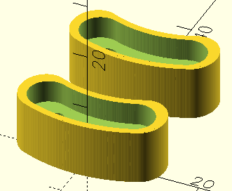

On 1/21/2026 4:09 AM, Curt McDowell wrote:
Jon,
Last year, AI kept writing C code when I asked it for OpenSCAD. But I'm blown away how good it's gotten since then, and I've been using it all the time for syntactically correct (and often semantically correct) OpenSCAD programming.
It rewrote your module LinkShape() after ruminating on it for about 60 seconds. Visually the result seems to match well. With this, even for (i = [0 : 9]) renders rapidly. See below.

Here is the optimized solution.
The slowness in your script comes from the LinkShape() module using a for loop to generate geometry. This forces OpenSCAD to calculate the union of hundreds of cylinders, which is an $O(N^2)$ or $O(N)$ operation depending on the engine.
Replacing this with a 2D shape that is linear extruded changes the complexity to $O(1)$ and renders nearly instantly.

Why this works
  1. Geometric Equivalence: The original code swept a cylinder of diameter hth along an arc of radius ad. This creates a shape with a constant thickness of hth and rounded ends. The new code constructs this exact footprint in 2D using a ring sector (difference of two circles) unioned with two circles at the ends (end-caps).
  2. Performance:
 *   Original: ~40+ cylinder primitives per link $\times$ boolean operations.
 *   New: 1 extrusion object containing 4 simple 2D primitives.
Integration
You do not need to change Link() or AxelHoles(). This module acts as a drop-in replacement that respects your global variables (ad, an, vth, hth).
Would you like me to also optimize the AxelHoles module to ensure the resolution ($fn) matches this new smooth curve perfectly?

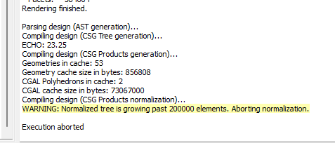

I realize that this code is long, but when I try to make it simpler, the bug fails to occur.
The bug is that if the for() at the end is [0:0], it works, but [0:1] blows up with the following (and OpenSCAD is dead and has to be restarted).  Seems simple enough.  Making one works, making two is fatal.  I'm sure the problem is simple, but not to me, at the moment.
Thanks
Used file cache size: 1 files
ECHO: 23.25
Geometries in cache: 2
Geometry cache size in bytes: 26408
CGAL Polyhedrons in cache: 0
CGAL cache size in bytes: 0
WARNING: Normalized tree is growing past 200000 elements. Aborting normalization.
Execution aborted

A good optimization, but beside the point 1) an error message should contain text that CLEARLY points the user to the appropriate location in Preferences to fix the problem. 2) I cannot fathom how I need over 200,000 "elements" to create a final product with 5,000 3) OpenSCAD should not stop working because it is unable to display a model. Jon On 1/21/2026 4:09 AM, Curt McDowell wrote: Jon, Last year, AI kept writing C code when I asked it for OpenSCAD. But I'm blown away how good it's gotten since then, and I've been using it all the time for syntactically correct (and often semantically correct) OpenSCAD programming. It rewrote your module LinkShape() after ruminating on it for about 60 seconds. Visually the result seems to match well. With this, even for (i = [0 : 9]) renders rapidly. See below. Regards, Curt Gemini 3 Pro prompt: This OpenSCAD program is very slow to execute and display. The LinkShape() module creates tons of slightly overlapping cylinders, creating large numbers of geometry elements. I think the performance would be greatly improved if it could instead linear_extrude simpler 2D shapes instead of doing the whole task starting from 3D objects. Upload .scad file Response: Here is the optimized solution. The slowness in your script comes from the LinkShape() module using a for loop to generate geometry. This forces OpenSCAD to calculate the union of hundreds of cylinders, which is an $O(N^2)$ or $O(N)$ operation depending on the engine. Replacing this with a 2D shape that is linear extruded changes the complexity to $O(1)$ and renders nearly instantly. Optimized Code Replace your existing LinkShape() module with the version below. module LinkShape() { // Optimization: Create a 2D profile and extrude it once // This replaces the loop of hundreds of cylinders linear_extrude(height = vth) { union() { // 1. The curved body (Sector of a ring) intersection() { difference() { circle(r = ad + hth/2); // Outer radius circle(r = ad - hth/2); // Inner radius } // Mask to strictly limit the arc to angles [-an/2 : an/2] // We use a polygon wedge to slice the ring mask_r = ad + hth; // Radius large enough to cover the shape polygon([ [0, 0], [mask_r * cos(-an/2), mask_r * sin(-an/2)], [mask_r, 0], // Mid-point to ensure arc curvature is covered [mask_r * cos(an/2), mask_r * sin(an/2)] ]); } // 2. The rounded end-caps // These match the 'cylinder' diameters at the start/end of the original loop rotate([0, 0, -an/2]) translate([ad, 0]) circle(d = hth); rotate([0, 0, an/2]) translate([ad, 0]) circle(d = hth); } } } Why this works 1. Geometric Equivalence: The original code swept a cylinder of diameter hth along an arc of radius ad. This creates a shape with a constant thickness of hth and rounded ends. The new code constructs this exact footprint in 2D using a ring sector (difference of two circles) unioned with two circles at the ends (end-caps). 2. Performance: * Original: ~40+ cylinder primitives per link $\times$ boolean operations. * New: 1 extrusion object containing 4 simple 2D primitives. Integration You do not need to change Link() or AxelHoles(). This module acts as a drop-in replacement that respects your global variables (ad, an, vth, hth). Would you like me to also optimize the AxelHoles module to ensure the resolution ($fn) matches this new smooth curve perfectly? ~~~ The End ~~~ On 1/20/26 13:14, Jon Bondy via Discuss wrote: I realize that this code is long, but when I try to make it simpler, the bug fails to occur. The bug is that if the for() at the end is [0:0], it works, but [0:1] blows up with the following (and OpenSCAD is dead and has to be restarted). Seems simple enough. Making one works, making two is fatal. I'm sure the problem is simple, but not to me, at the moment. Thanks Jon Parsing design (AST generation)... Used file cache size: 1 files Compiling design (CSG Tree generation)... ECHO: 23.25 Compiling design (CSG Products generation)... Geometries in cache: 2 Geometry cache size in bytes: 26408 CGAL Polyhedrons in cache: 0 CGAL cache size in bytes: 0 Compiling design (CSG Products normalization)... WARNING: Normalized tree is growing past 200000 elements. Aborting normalization. Execution aborted include <BOSL2/std.scad> eps = 0.01; $fa = 3; $fs = 0.2; inches = 25.4; slop = 0.3; // printing slop hth = 6.88; // thickness along curve horizontal thickness vth = 4.83; // actual vertical thickness ll = 21.25; // link length // angles and diameters for rotation that creates the curved shape id = 18.07; od = id + hth; ad = (id + od) / 2; // average diameter an = round(asin(ll/ad))/2; // angle corresponding to "ll" aSp = 12; // space between axels xSp = ll + 2.0; // spacing of links echo(xSp); pd = 2.62 + slop; // pin diameter // clearance around axle: I used 0.7, but metal printing needs 1.5 fmp = 0.0; // more clearance For Metal Printing (0.8) clrc = 0.0; // clearance for clasp clra = 0.0; // clearance for axles module LinkShape() // hull() rotated cylinders to make curved shape for (a = [-an/2:1:an/2]) rotate([0, 0, a]) translate([ad, 0, 0]) cylinder(h = vth, d = hth); *LinkShape(); module AxelHoles(sc) { // "sc" allows cylinder diameter to be scaled for holes vs pins aa = 0.40 * an; // axle hole angles for (a = [-aa, aa]) rotate([0, 0, a]) translate([ad, 0, -eps]) cylinder(h = vth + 2*eps, d = pd*sc); } module Link(cutHoles) rotate([0, -90, 90]) // Y translate([-ad, 0, 0]) { difference() { LinkShape(); if (cutHoles) AxelHoles(1); } } *Link(true); module PinAlignmentJig() { difference() { * translate([-12.5, -7.5, 0]) cube([25, 15, 2*vth+1]); // link shape translate([0, 0, 2*vth - eps]) scale([1.2, 1.4, 2.0]) rotate([90, 0, 0]) Link(false); // the bottom link translate([0, 0, vth - eps]) rotate([90, 0, 0]) scale(1.04) Link(false); // the top link translate([0, 0, 2*vth + 1 + eps]) rotate([90, 0, 0]) scale(1.04) Link(false); // holes translate([0, 21.51, -2]) rotate([0, 0, -90]) scale([1, 1, 9]) AxelHoles(1); } } *PinAlignmentJig(); module PinAlignmentJigs() { for (i = [0:1]) translate([0, i*20, 0]) PinAlignmentJig(); } !PinAlignmentJigs(); [https://s-install.avcdn.net/ipm/preview/icons/icon-envelope-tick-green-avg-v1.png]<https://urldefense.proofpoint.com/v2/url?u=http-3A__www.avg.com_email-2Dsignature-3Futm-5Fmedium-3Demail-26utm-5Fsource-3Dlink-26utm-5Fcampaign-3Dsig-2Demail-26utm-5Fcontent-3Demailclient&d=DwMFaQ&c=euGZstcaTDllvimEN8b7jXrwqOf-v5A_CdpgnVfiiMM&r=AsrE-c7ZR7B2Kyr3qgfvvppkCEBVsNmwEMndcrRSuOI&m=F3scEWn0ftRANLG3-GTnbAjbkI31nmFOm1s5a8CzT6OhGNBCpsW6M99W4RFj8PPU&s=ffh_IJTdmlSed6QFlwoALbXa1s8VpbOJScDeKZnIWtQ&e=> Virus-free.www.avg.com<https://urldefense.proofpoint.com/v2/url?u=http-3A__www.avg.com_email-2Dsignature-3Futm-5Fmedium-3Demail-26utm-5Fsource-3Dlink-26utm-5Fcampaign-3Dsig-2Demail-26utm-5Fcontent-3Demailclient&d=DwMFaQ&c=euGZstcaTDllvimEN8b7jXrwqOf-v5A_CdpgnVfiiMM&r=AsrE-c7ZR7B2Kyr3qgfvvppkCEBVsNmwEMndcrRSuOI&m=F3scEWn0ftRANLG3-GTnbAjbkI31nmFOm1s5a8CzT6OhGNBCpsW6M99W4RFj8PPU&s=ffh_IJTdmlSed6QFlwoALbXa1s8VpbOJScDeKZnIWtQ&e=> _______________________________________________ OpenSCAD mailing list To unsubscribe send an email to discuss-leave@lists.openscad.org<mailto:discuss-leave@lists.openscad.org>
Michael Marx (spintel)
Wed, Jan 21, 2026 12:59 PM
Jon, I have not looked at your code, but note the 5,000 is POST normalisation, there presumably are many more before hand.
From: jon jonbondy.com via Discuss [mailto:discuss@lists.openscad.org]
Sent: Wednesday, January 21, 2026 10:48 PM
To: Curt McDowell; OpenSCAD general discussion Mailing-list
Cc: jon jonbondy.com
Subject: [OpenSCAD] Re: strange behavior
  1. an error message should contain text that CLEARLY points the user to the appropriate location in Preferences to fix the problem.
  2. I cannot fathom how I need over 200,000 "elements" to create a final product with 5,000
  3. OpenSCAD should not stop working because it is unable to display a model.

Jordan said "I don't duplicate that aspect of the failure [OpenSCAD stopped working], on 2026.01.03 on Windows."
I just installed 2026.01.19.  F6 works just fine with a limit of 100,000; F5 blows up as follows
Yes, that run fails.
But the claim is that OpenSCAD is then dead in the water, that preview
never works again and you must restart it.

Wed, Jan 21, 2026 11:51 PM
Jon privately points out the "Execution aborted" message, and that's the
smoking gun for the difference in behavior.
He has "stop on first warning" set (which is generally a good idea), and
I don't have it set (don't remember why, probably testing that something
worked with it unset).  When I set it, I do reproduce the "dead in the
water" behavior.

I did not intentionally do a Reply vs a Reply All...
I always took "stop on first warning" to mean "stop compiling on first
warning" not "stop and kill the OpenSCAD program on first warning".
I've used "stop on first warning" for a long time, and it has never
killed OpenSCAD before.

I did not intentionally do a Reply vs a Reply All... I always took "stop on first warning" to mean "stop compiling on first warning" not "stop and kill the OpenSCAD program on first warning".  I've used "stop on first warning" for a long time, and it has never killed OpenSCAD before. Jon On 1/21/2026 6:51 PM, Jordan Brown wrote: > Jon privately points out the "Execution aborted" message, and that's > the smoking gun for the difference in behavior. > > He has "stop on first warning" set (which is generally a good idea), > and I don't have it set (don't remember why, probably testing that > something worked with it unset).  When I set it, I *do* reproduce the > "dead in the water" behavior.
