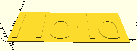

I happened to need something simple and stupid - label plates to go on a
bunch of similar print jobs - and so threw together a small
customizer-friendly program to make them.  It takes advantage of my
soon-to-integrate (fingers crossed) text metrics functions to
automatically size the plate around the text.
Here's that program, a preview of what you can do with that function:
// Note this requires a textmetrics() capable OpenSCAD.
// Text to print
text = "Hello";
baseplate = true;
base_t = 0.3;
text_t = 0.3;
if (baseplate) {
    tm = textmetrics(text);
    translate(tm.position - [1,1]) cube(concat(tm.size + [2,2], base_t));
linear_extrude(height=text_t+(baseplate ? base_t : 0)) text(text);
and what that program defaults to producing:

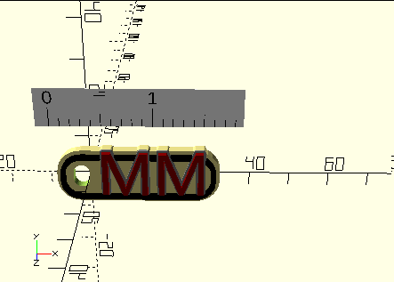

It uses some very clever hull, offset, and intersection tricks to
simulate some of the same effects.  Interestingly, it does not
actually know how large the text is!
As a tidbit about the trickery it has to go through, to generate this image:
it has to generate the "MM" text 18 times.
When I have a little more time, I'll see what it would be like if it
used textmetrics().
This is the basic trick that it uses to get a box that's the right width:
big = 1000;
height = 10;	// font size
s = "Hello";
    square([big, height]);
    hull() {
        translate([0,-big]) text(s);
        translate([0, big]) text(s);
You can do additional variations on that by shifting the text left and
right to make a margin, and by doing an offset on the result to round
the corners of the box.
