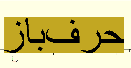

Also in addition textmetrics() works on the actually shaped
glyphs, including ligatures for character combinations like "fi"
which is almost impossible to capture otherwise. While for some
languages like English, that's not too problematic, it's quite
critical for others e.g., Farsi (written in Persian calligraphy).

I suspect that Pruss's work will get the wrong results for "difficult"
in fonts with ligatures - Palatino, for instance - because it doesn't
know about the "ffi" ligature.
(BTW, before or after my work, the "spacing" parameter doesn't work
right with those cases.  "spacing" doesn't work well with any
proportionally-spaced fonts.)
Here's "HarfBuzz", the font layout engine's name, as written in Persian,
with a textmetric-measured box around it:
