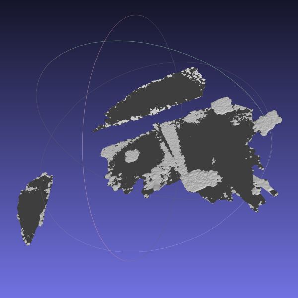

If you can get somewhere to test various scanners, or get on 'sale or
return', then I don't think you would buy the creality gear. The ferret
comes in a nice case, seems to be well thought out, the software
interface looks nice, but in fact it is only 'a polished turd'. I've
just attempted four scans of a raspberry pi. None worked in any fashion
that would be useful. The software goes through various steps, and
generates an .obj file from the initial point cloud. That takes some
time. At the end, you end up with something, from which you can just
discern the object, mainly because a coloured photo is mapped over the
surface, and it will need a lot of repairs/post processing. I have a
70MB .obj file, that openscad will not open  - it says WARNING: Index
P:/Docs/openscad/t3.obj out of range in Line 2243791
In meshlab, it shows as an unrecognisable grey blob.
Possibly, If I spent a few more weeks practising, made a
turntable/scanning rig/whatever, then it may produce something more
useful, but it is just not worth the effort. For printed circuit boards,
for the purpose of designing cases, then mine or Nophead's methods are

The other aspect, is many of the cheap scanners do not handle black or
shiny parts too well, which occur on most pcbs. If you want it for
scanning people or pets, hair is a problem. Vehicles, you'll need
something else.
Hope I've not put you off. 😕

It might be possible to convert the point cloud into voxels, convert
the voxel into a mesh, and do some post-processing on the mesh. If
the target features are cube like (flat surfaces, right angles,
etc.), this may work well.
I suspect this (the post-processing) is still a PHD level research
project to "do it right". For a human it is trivially easy to
recognize: Oh, that's supposed to be a flat surface, and that other
thing is a smooth curve.

There is no right answer to this sort of postprocessing, only heuristics.
If you assume the ground truth are mostly flat surfaces, it is possible to
fill in small holes, voxels make it easier to do this kind of operations
because you won't get invalid meshes from it. It can be far from the ground
truth, but it can never be invalid geometry.
And I'm not saying it is easy to recognize in software that the input is a
flat surface or smooth curve, this is difficult. What I am saying is if you
assume the target is like this, you can write heuristics to target it.
State-of-the-art mesh reconstruction from scanned data often requires both
point-cloud as well as visual data. With visual data it is easier to figure
out continuous surfaces, given the lighting condition is good. But even
with all these, it can still be hard to obtain a full scan when your input
have valleys, and it may require stiching multiple scans together. In that
case, the visual information can help as well by locating feature points
using computer vision methods. There are PhDs and companies working on
this, but they target more general cases and have very different
requirements.
Re. PhD level research, a lot of issues important to openscad users are
like that. Good mesh simplification, mesh repair to recover manifoldness
and remove overlaps, faster mesh offset, generic ways to implement fillet.
There are literatures out there, but a lot of them are missing details, or
are problematic in some ways. It is not like PhD level research is
something much harder than our regular development...
