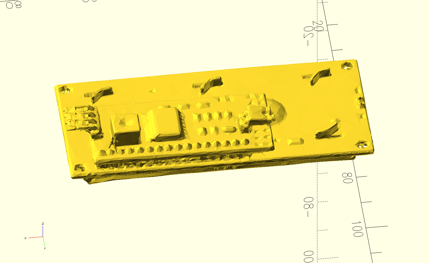

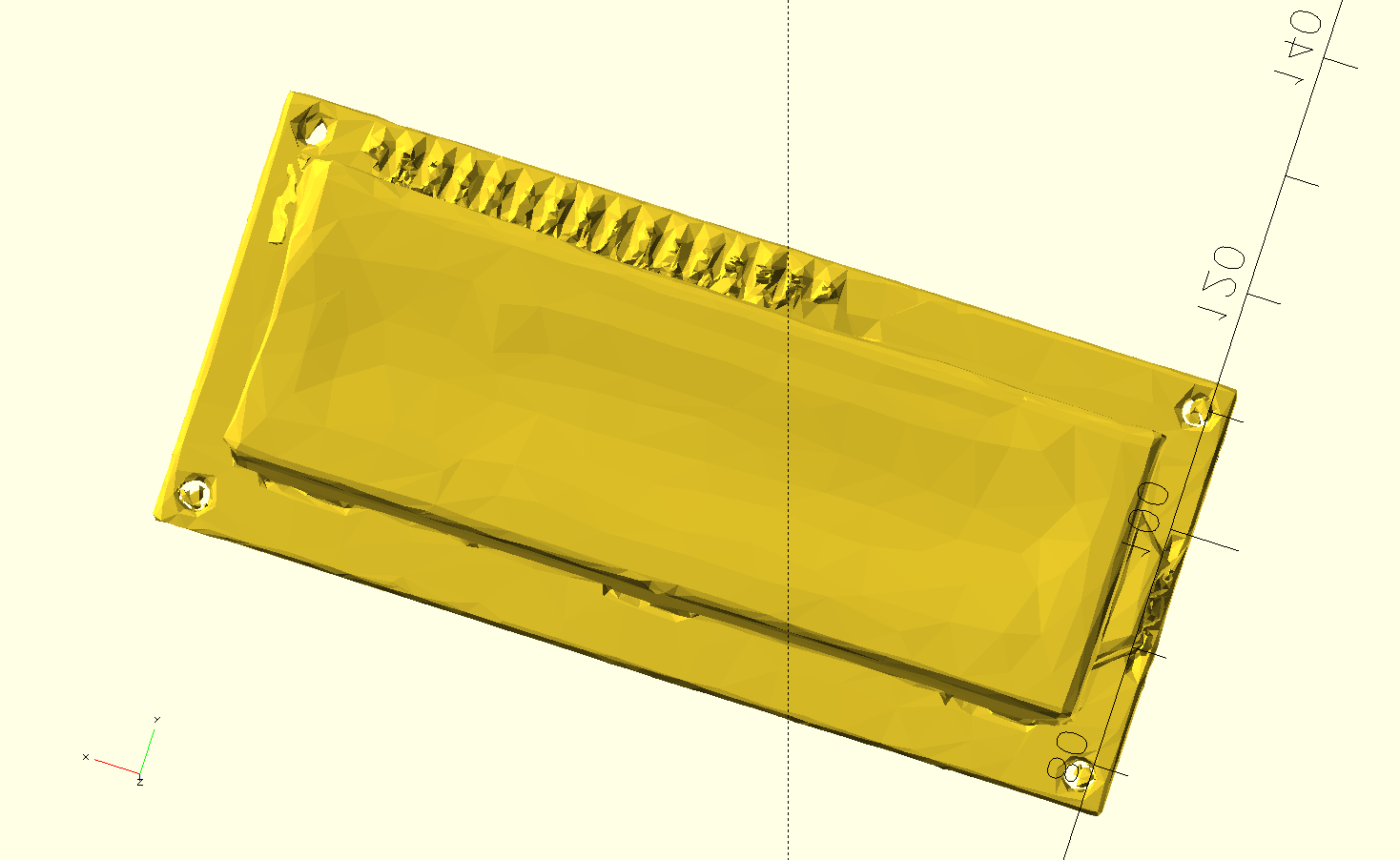

So, my RevoPoint Miraco Pro arrived yesterday and I played with it most of
today.  It seems to work... OK.  I guess that I had higher expectations
than I should have.
The main purpose for getting it was to easily/quickly model complicated
electronics parts and assemblies so that I did not need to model them
myself in native OpenSCAD.  My first target was a 1602 LCD display with
attached controller board. After learning the Miraco, it still took several
iterations in PrusaSlicer to simplify and correct errors until I got an OBJ
with enough detail AND could be imported into OpenSCAD in a reasonable
amount of time:
[image: LCD1602bottom.png]
[image: de947e2e-edc1-4f69-a699-ea045760e08f.png]
This is a 589KB OBJ file with 17,654 faces.  It imports into OpenSCAD on my
Windows machine in 2.9 seconds.

Nice job.  I am seeing a number of artifacts, but with some tweaking of the
settings and more experience with the unit, it will get much better.

Thanks!  My biggest disappointment was that when I used the Revo Scan 5
software to simplify the mesh, it then became non-manifold and OpenScad
didn't like it. I expected Revo Scan to be better than that.

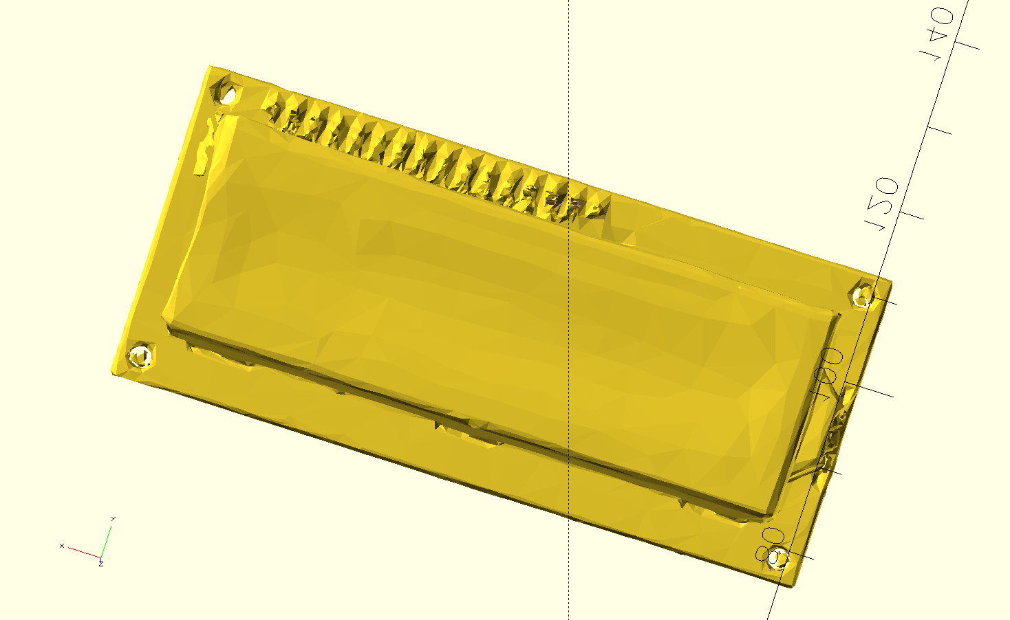

Thanks! My biggest disappointment was that when I used the Revo Scan 5 software to simplify the mesh, it then became non-manifold and OpenScad didn't like it. I expected Revo Scan to be better than that. On Sun, Dec 1, 2024 at 9:39 AM John David <ebo.2112@gmail.com> wrote: > Nice job. I am seeing a number of artifacts, but with some tweaking of > the settings and more experience with the unit, it will get much better. > > On Sat, Nov 30, 2024 at 8:16 PM Leonard Martin Struttmann via Discuss < > discuss@lists.openscad.org> wrote: > >> So, my RevoPoint Miraco Pro arrived yesterday and I played with it most >> of today. It seems to work... OK. I guess that I had higher expectations >> than I should have. >> >> The main purpose for getting it was to easily/quickly model complicated >> electronics parts and assemblies so that I did not need to model them >> myself in native OpenSCAD. My first target was a 1602 LCD display with >> attached controller board. After learning the Miraco, it still took several >> iterations in PrusaSlicer to simplify and correct errors until I got an OBJ >> with enough detail AND could be imported into OpenSCAD in a reasonable >> amount of time: >> >> [image: LCD1602bottom.png] >> [image: de947e2e-edc1-4f69-a699-ea045760e08f.png] >> >> This is a 589KB OBJ file with 17,654 faces. It imports into OpenSCAD on >> my Windows machine in 2.9 seconds. >> >> >> On Fri, Nov 22, 2024 at 10:06 AM jon jonbondy.com <jon@jonbondy.com> >> wrote: >> >>> If you limit your Blender use to smoothing, it works fine. The rest of >>> the UI just irritates me beyond description. There are YouTube videos >>> about how to use Blender just for smoothing. >>> >>> >>> On 11/22/2024 10:19 AM, Leonard Martin Struttmann wrote: >>> >>> Jon, >>> >>> <feeble attempt at humor>"BLENDER!", he cried. "Oh, NO!!!" Not >>> that!"</humor> >>> >>> Yeah, I tried Blender several years ago for a tensegrity tower project >>> and found it... unwieldy. I guess that I may need to revisit it. Or, >>> perhaps, MeshLab. >>> >>> Thanks! >>> >>> Len >>> >>> On Fri, Nov 22, 2024 at 6:08 AM Jon Bondy via Discuss < >>> discuss@lists.openscad.org> wrote: >>> >>>> The RevoPoint software converts point clouds into some intermediate >>>> data and then into mesh. You can control each of the >>>> conversions/transitions between each data form, and can use external >>>> software to process each, in addition to the RevoPoint software. >>>> >>>> I use Blender (dragged there kicking and screaming) to smooth out scans >>>> once they are in mesh form. Anything that automatically smooths everything >>>> will also reduce detail >>>> >>>> Jon >>>> On 11/21/2024 11:48 PM, pca006132 via Discuss wrote: >>>> >>>> There is no right answer to this sort of postprocessing, only >>>> heuristics. If you assume the ground truth are mostly flat surfaces, it is >>>> possible to fill in small holes, voxels make it easier to do this kind of >>>> operations because you won't get invalid meshes from it. It can be far from >>>> the ground truth, but it can never be invalid geometry. >>>> And I'm not saying it is easy to recognize in software that the input >>>> is a flat surface or smooth curve, this is difficult. What I am saying is >>>> if you assume the target is like this, you can write heuristics to target >>>> it. State-of-the-art mesh reconstruction from scanned data often requires >>>> both point-cloud as well as visual data. With visual data it is easier to >>>> figure out continuous surfaces, given the lighting condition is good. But >>>> even with all these, it can still be hard to obtain a full scan when your >>>> input have valleys, and it may require stiching multiple scans together. In >>>> that case, the visual information can help as well by locating feature >>>> points using computer vision methods. There are PhDs and companies working >>>> on this, but they target more general cases and have very different >>>> requirements. >>>> >>>> Re. PhD level research, a lot of issues important to openscad users are >>>> like that. Good mesh simplification, mesh repair to recover manifoldness >>>> and remove overlaps, faster mesh offset, generic ways to implement fillet. >>>> There are literatures out there, but a lot of them are missing details, or >>>> are problematic in some ways. It is not like PhD level research is >>>> something much harder than our regular development... >>>> >>>> On Fri, Nov 22, 2024 at 12:09 PM Leonard Martin Struttmann via Discuss < >>>> discuss@lists.openscad.org> wrote: >>>> >>>>> Roger, you are probably right, but, <sarcasm> isn't that the unspoken >>>>> promise of AI? To relieve us humans of the burden of doing these things >>>>> ourselves? </sarcasm> Who knows? >>>>> >>>>> In any event, I ordered a Miraco Pro today. I will report back here >>>>> after I've had some time to play with it. >>>>> >>>>> Thanks! Len >>>>> >>>>> >>>>> >>>>> On Thu, Nov 21, 2024 at 9:26 PM Rogier Wolff via Discuss < >>>>> discuss@lists.openscad.org> wrote: >>>>> >>>>>> On Thu, Nov 21, 2024 at 08:04:53PM +0800, Chun Kit LAM via Discuss >>>>>> wrote: >>>>>> >>>>>> > It might be possible to convert the point cloud into voxels, convert >>>>>> > the voxel into a mesh, and do some post-processing on the mesh. If >>>>>> > the target features are cube like (flat surfaces, right angles, >>>>>> > etc.), this may work well. >>>>>> >>>>>> I suspect this (the post-processing) is still a PHD level research >>>>>> project to "do it right". For a human it is trivially easy to >>>>>> recognize: Oh, that's supposed to be a flat surface, and that other >>>>>> thing is a smooth curve. >>>>>> >>>>>> Roger. >>>>>> >>>>>> -- >>>>>> ** R.E.Wolff@BitWizard.nl ** https://www.BitWizard.nl/ ** >>>>>> +31-15-2049110 ** >>>>>> ** Delftechpark 11 2628 XJ Delft, The Netherlands. KVK: >>>>>> 27239233 ** >>>>>> f equals m times a. When your f is steady, and your m is going down >>>>>> your a** is going up. -- Chris Hadfield about flying up the space >>>>>> shuttle. >>>>>> ** 'a' for accelleration. >>>>>> _______________________________________________ >>>>>> OpenSCAD mailing list >>>>>> To unsubscribe send an email to discuss-leave@lists.openscad.org >>>>>> >>>>> _______________________________________________ >>>>> OpenSCAD mailing list >>>>> To unsubscribe send an email to discuss-leave@lists.openscad.org >>>>> >>>> >>>> _______________________________________________ >>>> OpenSCAD mailing list >>>> To unsubscribe send an email to discuss-leave@lists.openscad.org >>>> >>>> >>>> >>>> <http://www.avg.com/email-signature?utm_medium=email&utm_source=link&utm_campaign=sig-email&utm_content=emailclient> >>>> Virus-free.www.avg.com >>>> <http://www.avg.com/email-signature?utm_medium=email&utm_source=link&utm_campaign=sig-email&utm_content=emailclient> >>>> <#m_-6381106329078966213_m_3045179401418616933_m_-1138463494526674595_m_-7348258836865286824_DAB4FAD8-2DD7-40BB-A1B8-4E2AA1F9FDF2> >>>> _______________________________________________ >>>> OpenSCAD mailing list >>>> To unsubscribe send an email to discuss-leave@lists.openscad.org >>>> >>> _______________________________________________ >> OpenSCAD mailing list >> To unsubscribe send an email to discuss-leave@lists.openscad.org >> >
JJ
jon jonbondy.com
Sun, Dec 1, 2024 4:11 PM
The Revo Scan software can close holes, if you can find the feature.
On Sun, Dec 1, 2024 at 9:39 AM John David <ebo.2112@gmail.commailto:ebo.2112@gmail.com> wrote:
Nice job.  I am seeing a number of artifacts, but with some tweaking of the settings and more experience with the unit, it will get much better.
On Sat, Nov 30, 2024 at 8:16 PM Leonard Martin Struttmann via Discuss <discuss@lists.openscad.orgmailto:discuss@lists.openscad.org> wrote:
So, my RevoPoint Miraco Pro arrived yesterday and I played with it most of today.  It seems to work... OK.  I guess that I had higher expectations than I should have.
The main purpose for getting it was to easily/quickly model complicated electronics parts and assemblies so that I did not need to model them myself in native OpenSCAD.  My first target was a 1602 LCD display with attached controller board. After learning the Miraco, it still took several iterations in PrusaSlicer to simplify and correct errors until I got an OBJ with enough detail AND could be imported into OpenSCAD in a reasonable amount of time:
[LCD1602bottom.png]
[de947e2e-edc1-4f69-a699-ea045760e08f.png]
This is a 589KB OBJ file with 17,654 faces.  It imports into OpenSCAD on my Windows machine in 2.9 seconds.
