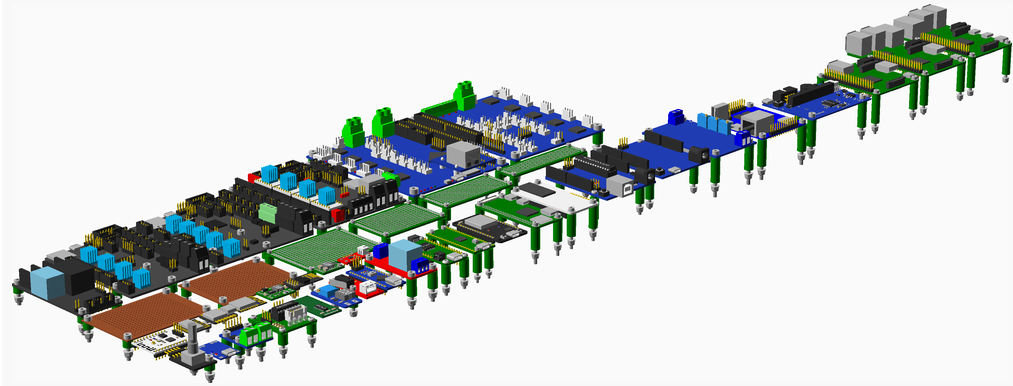

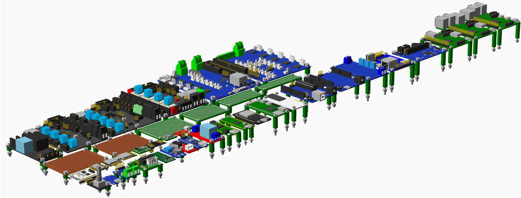

nop: Your library is awesome, and I intend on using it for modeling some of
the wiring.  But, there are still parts/assemblies that aren't there and,
even though I thoroughly enjoy modelling these in OpenSCAD, I was trying to
save some time.
For my own boards, I can export a 3D model of the board from EasyEDA and
then quickly run that through Prusaslicer to repair.  The resulting model
is not good enough to F6, but it >IS< good enough to preview and that's
generally what I need for case design.
With all of the current AI craze, I wish I knew how to train an AI to
quickly, reliably repair OBJ and STl 3D models so that they were viable for
OpenSCAD.
