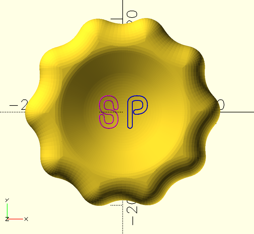

and here is mine:
[image: Screenshot 2025-02-15 at 8.24.12 PM.png]
[image: Screenshot 2025-02-15 at 8.23.02 PM.png]

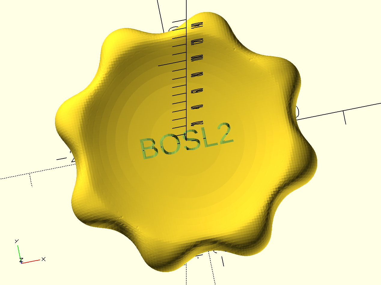

I was a little annoyed that Angus ignored OpenSCAD in his YouTube review
of free CAD solutions for 3d printing.
Here's my attempt at a coin using the new metaballs() function in the
BOSL2 library for OpenSCAD.    The version pictured is an F6 render that
took about a minute and a half.
If you increase voxel_size to 1 in line 10, it takes about 15 seconds for
an F6 render.
include <BOSL2/isosurface.scad>
h1 = 10;
r1 = 25;
r2 = 5;
d1 = r1 * 2;
isovalue = 1;
voxel_size = 0.5;
infl = 0.2;
cut = 10;
function tmat(ang) = move(cylindrical_to_xyz(r1,ang,0));
metaballs([
IDENT, mb_disk(h1,r1),
up(r1-2), mb_sphere(r1*4, influence = 1, negative = true, cutoff = r1+2),
for (ang = [0:45:315])
each [tmat(ang), mb_sphere(r2, influence = infl, negative = true, cutoff =
cut)]
voxel_size, [[-d1,-d1,-h1], [d1,d1,h1]], isovalue);
text3d(h = h1/2, "BOSL2", size = 4, center = true);

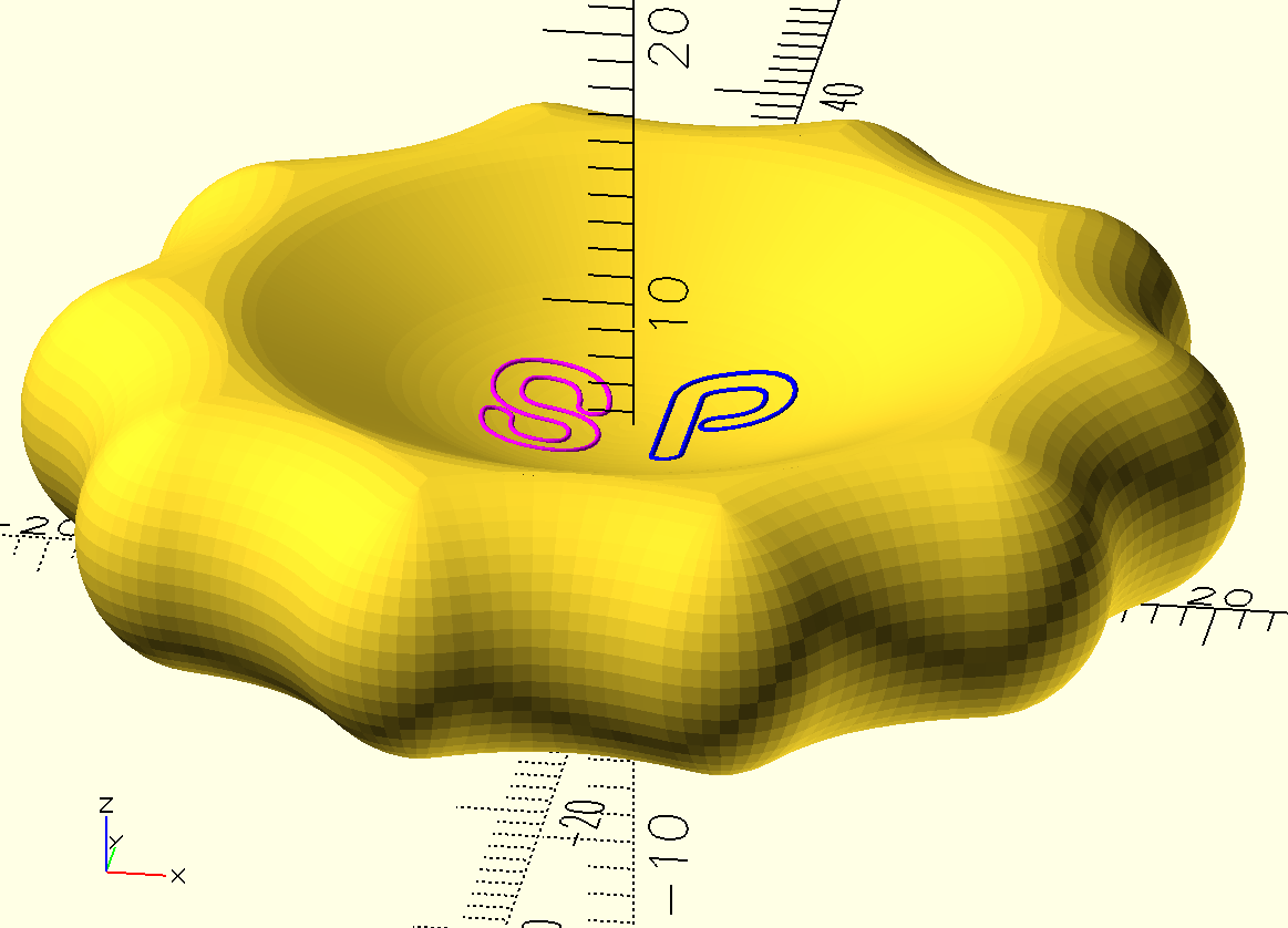

below is the python code and it takes around 19 sec to calculate:
from openscad2 import *
i_t=time.time()
s1=pts([[0,-1],[5,0],[4,2],[5,0]])
s2=l_(concatenate([translate([i,0,0],s1) for i in
arange(0,180,18)]))+[[180,-1,0]]
path=c23(arc(20,0,360,s=len(s2)-1))
s3=extrude_wave2path(s2,path)
s4=rot2d(-4,bspline_closed(s3,2,200))
l1=[[0,0],[25,0]]
l2=[rot2d(i,l1) for i in arange(0,360,36)]
c1=circle(5,[-5,5])
c2=circle(20,[-20,25.5],s=200)
p0=[-15,0]
p1=tcct(5,20,[-5,5],[-20,25.5])
sec=[[-15,0]]+lineFromPointTillEnd(c1,[-5,0],1)+lineFromStartTillPoint(c1,p1[0],1)+
lineFromPointToPointOnLine(flip(c2),p1[1],[-18,5],5)
sol=prism(s4,sec)
lineFromPointToPointOnLine(flip(c2),p1[1],[-20,5],5)
sol1=prism(circle(20,s=200),sec)
sol2=sol[:27]+sol1[27:]
s=pts([[0,4],[0,-4],[6,0],[0,6],[-6,0],[0,6],[6,0],[0,-4]])
s=bspline_open(s,2,50)
s=scl2d(surround(s,1,10),.5)
p=pts([[0,10],[0,2],[6.5,0],[0,-6],[-4,0]])
p=[[0,0]]+bspline_open(p,2,20)
p=translate_2d([6.2,0],scl2d(surround(p,1,10),.5))
s,p=[translate([-6,-2.5,15],p) for p in [s,p]]
sol2=[p+[p[0]] for p in sol2]
s,p=[plos(sol2,p,[0,0,-1]) for p in [s,p]]
f.write(f'''
include<dependencies2.scad>
color("blue")p_line3dc({s},.2);
color("magenta")p_line3dc({p},.2);
{swp(sol2)}
f_t=time.time()
f_t-i_t

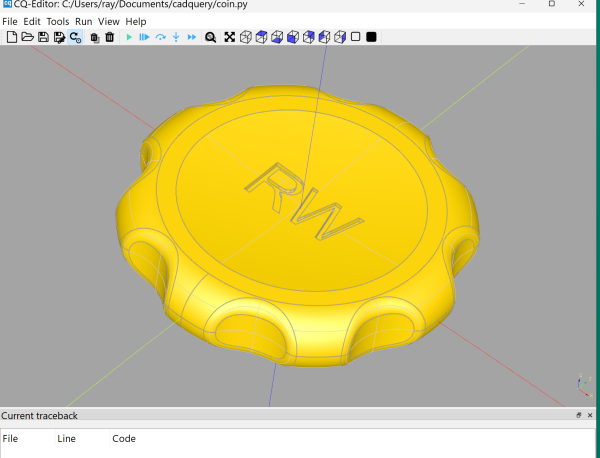

I've attached my cadquery code from last September

I thought you may be interested, Sanjeev.
I installed the cq editor, but used it mainly for viewing the code that
I generated with visual studio code, since It does the automatic reload
and preview. I think I also generated the coin in openscad too, but not
found it yet.

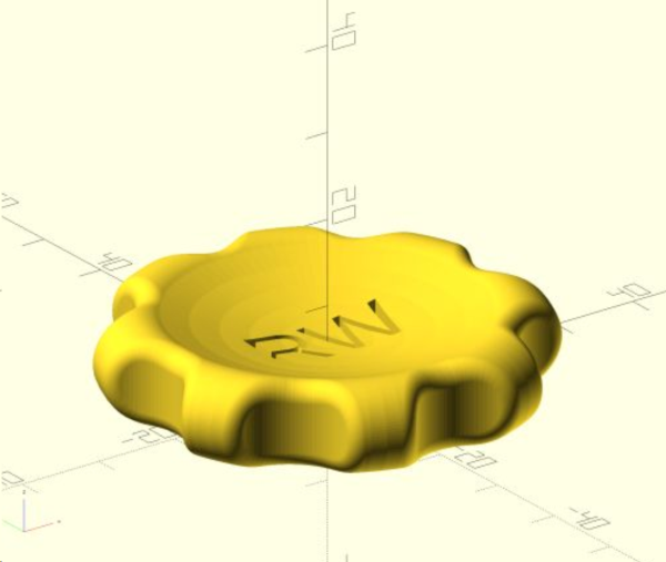

My openscad solution was posted on 4th March. I set the $fn value to a
higher value - it took 1.5 hours to render, and I posted the result on
5th March, 2024.
It's good to forget some things.

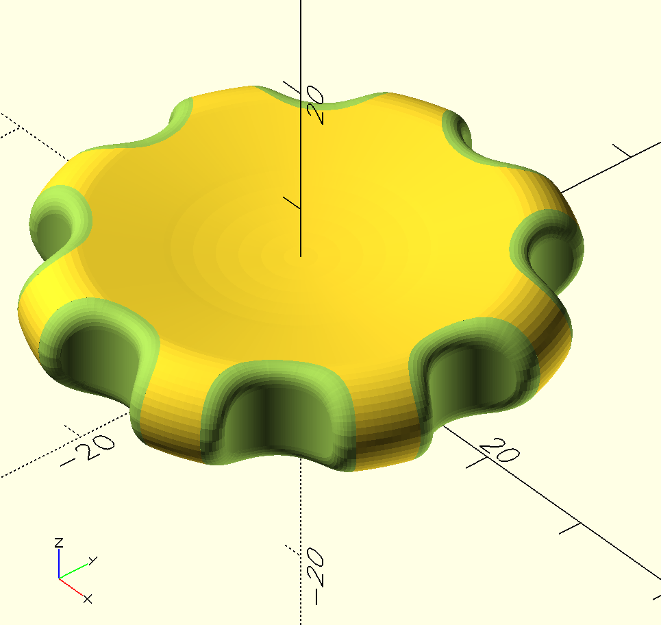

here is another one inspired by RW. It takes 4 sec to calculate and render.
[image: Screenshot 2025-02-17 at 7.21.56 AM.png]
python code:
i_t=time.time()
c1=circle(4,[-4,4])
c2=circle(50,[-20,55.9],s=200)
p0=[-15,0]
p1=tcct(4,50,[-4,4],[-20,55.9])
path=[[-15,0]]+lineFromPointTillEnd(c1,[-4,0],1)+lineFromStartTillPoint(c1,p1[0],1)+
lineFromPointToPointOnLine(flip(c2),p1[1],[-20,6],5)
sol=prism(circle(20,s=200),path)
sol1=translate([20,0,-1],linear_extrude(circle(4,s=200),12))
l1=ip_sol2sol(sol,sol1)
l2=ip_sol2sol(sol,sol1,-1)
l1=flip(l1)+l2
l2=o_3d(l1,sol,-1.5)
l3=o_3d(l1,sol1,-1.5)
f1=cpo(convert_3lines2fillet(l2,l3,l1))[:-1]
f2=surface_offset(f1,-1)
sol2=swp_prism_h(f2,f1)
f.write(f'''
//color("blue")for(p={[l1,l2,l3]})p_line3d(p,.2);
difference(){{
{swp(sol)}
for(i=[0:360/8:359])
rotate([0,0,i]){{
{swp(sol1)}
{swp_c(sol2)}
f_t=time.time()
f_t-i_t
here is another one inspired by RW. It takes 4 sec to calculate and render. [image: Screenshot 2025-02-17 at 7.21.56 AM.png] python code: from openscad2 import * i_t=time.time() c1=circle(4,[-4,4]) c2=circle(50,[-20,55.9],s=200) p0=[-15,0] p1=tcct(4,50,[-4,4],[-20,55.9]) path=[[-15,0]]+lineFromPointTillEnd(c1,[-4,0],1)+lineFromStartTillPoint(c1,p1[0],1)+ \ lineFromPointToPointOnLine(flip(c2),p1[1],[-20,6],5) sol=prism(circle(20,s=200),path) sol1=translate([20,0,-1],linear_extrude(circle(4,s=200),12)) l1=ip_sol2sol(sol,sol1) l2=ip_sol2sol(sol,sol1,-1) l1=flip(l1)+l2 l2=o_3d(l1,sol,-1.5) l3=o_3d(l1,sol1,-1.5) f1=cpo(convert_3lines2fillet(l2,l3,l1))[:-1] f2=surface_offset(f1,-1) sol2=swp_prism_h(f2,f1) with open('trial.scad','w+') as f: f.write(f''' include<dependencies2.scad> //color("blue")for(p={[l1,l2,l3]})p_line3d(p,.2); difference(){{ {swp(sol)} for(i=[0:360/8:359]) rotate([0,0,i]){{ {swp(sol1)} {swp_c(sol2)} }} }} ''') f_t=time.time() f_t-i_t

Revised code to comply with changes in BOSL2 metaballs().
h1 = 10;
r1 = 25;
r2 = 5;
v_size = 0.75;
N=7;
metaballs([
up(r1-2), mb_sphere(r1*4, negative = true, cutoff = r1+2),
for(M=zrot_copies(n=N))
each [M*right(r1), mb_sphere(r2, influence = 0.2, negative = true, cutoff = 10)]
[[-r1,-r1,-h1/2], [r1,r1,h1/2]], v_size, show_stats = true);
Renders in 5 Seconds on an M3pro Mac Mini.
Revised code to comply with changes in BOSL2 metaballs().\ \ `include <BOSL2/std.scad>`\ `include <BOSL2/isosurface.scad>`\ `h1 = 10;`\ `r1 = 25;`\ `r2 = 5;`\ `v_size = 0.75;`\ `N=7;`\ `difference() {`\ ` metaballs([`\ ` IDENT, mb_disk(h1,r1), `\ ` up(r1-2), mb_sphere(r1*4, negative = true, cutoff = r1+2),`\ ` for(M=zrot_copies(n=N)) `\ ` each [M*right(r1), mb_sphere(r2, influence = 0.2, negative = true, cutoff = 10)]`\ ` ],`\ ` [[-r1,-r1,-h1/2], [r1,r1,h1/2]], v_size, show_stats = true);`\ ` text3d(h = h1/2, "BOSL2", size = 4, center = true); `\ `}`\ \ \ Renders in 5 Seconds on an M3pro Mac Mini.
