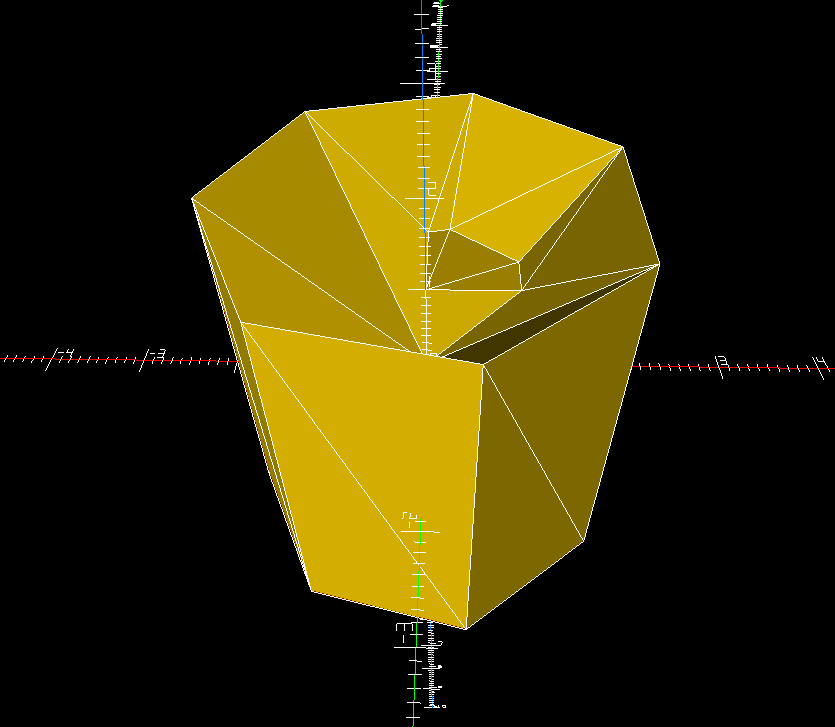

rotate_extrude(){
polygon([ [0,0],[2,-2], [2,2] ]);
This works fine in OpenSCAD 2019.03.31 and it can be exported
successfully to various formats, including OFF (sing1.off, vertices=15
faces=28) and STL (sing1.stl, vertices=84 faces=28).
The assertion occurs in OpenSCAD if you try to union with a cube:
rotate_extrude(){
cube(1);
Or this way, it also gives an assertion
import("./sing1.stl");
cube(1);
Now, if you import the OpenSCAD-generated model into AngelCAD
(OFF-version) and union it with a cube as above and save it as test2.off:
// AngelCAD code.
shape@ main_shape()
polyhedron p("./sing1.off");
return p + cube(1);
In this case there is no problem, it works fine as shown in enclosed PNG
image, and
$ polyfix test2.off
Parameters:
input_file = test2.off
polyhedron 0 ================= volume=29.4181, dtol=0.01, atol=1e-06,
maxiter=10
iteration 0: vertices=20 faces=38
total changes=0
no warnings
Summary:
polyhedron 0: vertices=20 faces=38 : no warnings
Therefore, the problem seen in OpenSCAD is not really in rotate_extrude,
but how the model is interpreted when subject to union using CGAL. The
same union using Carve works fine as should be expected.

rotate_extrude(){
rotate_extrude(){
cube(1);
cube(1);
// AngelCAD code.
shape@ main_shape()
return p + cube(1);
image, and
$ polyfix test2.off
Parameters:
maxiter=10
total changes=0
no warnings
Summary:
