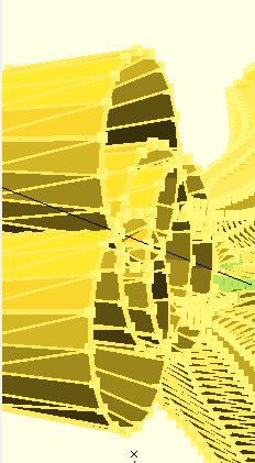

Nop_head: when I did my original hypDome() {code given earlier in the
thread} it looked hollow but that could be some weird artifact.  I am using
the 2018 release of OpenSCAD (not the latest one) and I see this:
For a shell with thickness I simply make a new function that assigns
coshPolygon() to a vector, then I make a second vector taking the elements
of the first vector (in reverse order) and subtracting the "thickness" from
the y value (which isn't exactly correct as it should be on an angle with
both x & y values altered).
