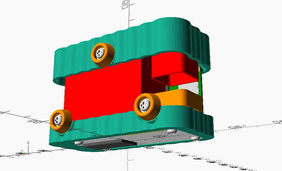

Yes I have seen your video but what would the screen look like for the design I am working on at the moment?
It is 350 lines of code and it has taken me a couple of days. I am the worlds worst typist but that is not what takes the time. It is working out how the parts are going to fit together without clashes.
On Fri, 25 Oct 2019 at 12:14, William F. Adams via Discuss discuss@lists.openscad.org wrote:

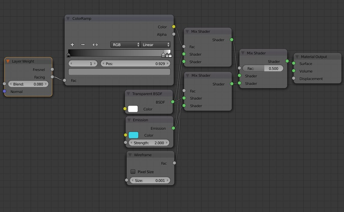

I know that OpenSCAD is a "CAD" program, but I got into it in order to
make art. In the 3D computer graphics business, the most popular interface
for programming languages aimed at artists is "node and wire" syntax. For
example, Blender has this.
I'm not claiming that node+wire is the "best" graphical syntax. However,
here are the benefits:
  • You don't have to memorize module names. You can select a module from
    a hierarchical menu, or find a module using keyword search,
    and then a node is created which calls the module.
  • You don't need to memorize module parameters.
    The parameters are all laid out for you in the node.
  • You can continuously tweak numeric parameters using a slider.
    You can use a colour picker to tweak a colour parameter.
For me, the ability to tweak module parameters using a slider and get real
time feedback in the preview window is a game changer. It makes me much
productive in certain tasks. For other people, not having to memorize
syntax is the key feature.

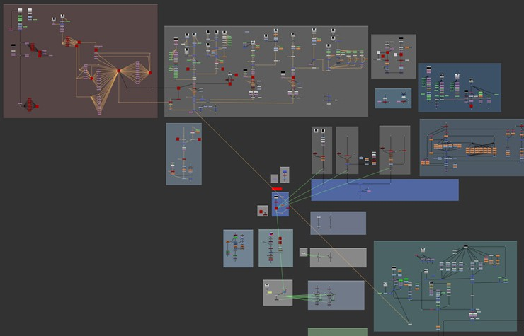

@nophead: The problem is it is too sparse because typically one line of code becomes a box. So what happens to a design that is 350 lines?
If you have text and graphics and direct manipulation, then you can build a better user interface than what you can build using text and a keyboard alone. So it becomes a matter of user interface design.
2D layout can pack more information onto the screen then 1 dimensional text layout. A zooming user interface, plus hierarchical structure, can allow you to manage programs containing thousands of nodes.
Nuke (by Foundry) has an overview pane that shows the entire program zoomed out, and an edit pane where you are zoomed in to part of the program. A zooming user interface can display fewer details of a node when you are zoomed out (eg, only the module name) and more details when you are zoomed in (eg, the module name and the parameters).
Here's one way to represent hierarchy using node+wire. It would be better if each supernode had an optional title that is visible when zoomed out:

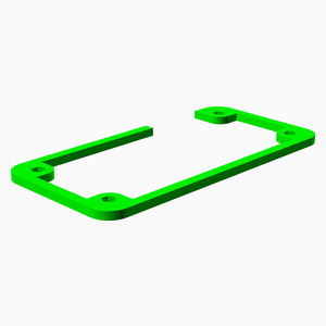

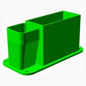

Not sure what your definition of "real" part is, but I've worked up some
projects using BlockSCAD:
https://community.carbide3d.com/t/design-into-3d-games-chinese-checkers/16056
https://community.carbide3d.com/t/design-into-3d-boxes-magazine-storage/16238
For the latter, I actually worked through posting screengrabs of bits of the
code as I worked, so maybe proves the concept?
Two features which help in BlockSCAD are the ability to collapse blocks and
their contents, and to create modules. If it just had robust support for the
customizer I'd be goodl.

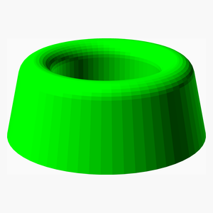

I suspect that you are not the type of user I have in mind for ClikScad.
Indeed as far as I can see none of the recent Threads in this Fourm have
been posted by newbies looking for assistance.
My mind is very firmly focused on the person who would like to design the
occasional part for their 3D printer without needing to take the trouble and
the time to learn a 3D drawing product. I think OpenSCAD provides an
excellent platform for that.
/And I have to confess that I don't understand the purpose of a model as
complex as yours - though it looks very impressive. In my mind I would model
each of the parts separately so I could print them one at a time and I see
no problem doing that with ClikScad./
...R

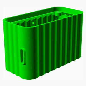

I always create full assembled models because a) I have to fit the plastic
parts around other off the shelf parts and b) my framework creates a full
bill of materials and assembly instructions. This is totally necessary
because a lot of my designs have hundreds of parts. and dozens of sub
assemblies. I often spend more time modelling the vitamins than I do the
printed parts.
This design is a case for an Enviro+ environmental sensors board that plugs
into an RPI Zero at right angles. There is also a particle counter module
and a tiny fan. Getting all the parts into a small space was a challenge
and the only way to do it is to model it as an assembly. I use the
customiser to switch different bits on an off in the view so I can see
inside.
The case is is a library item that is fully parametric. I can specify
arbitrary additions and subtractions as children. I added the optional
waves to see if it reduces the tendency to warp but I also like the
aesthetic. It does make it more difficult to have holes in the sides
because you can't have wavy bridges, so all apertures have 45 degree
chamfered surrounds that build out to a straight edge that can be bridged.
This is the BOM it produced.

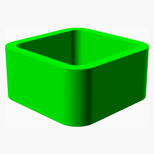

And here are the printed parts that I designed:
[image: bulkhead.png]
[image: enviro_plus_case.png]
[image: enviro_plus_case_base.png]
[image: fan_jacket.png]
[image: foot.png]
The is quite small for my projects. The last one has 637 vitamins, 62
printed parts and 12 routed parts in 28 assemblies.
