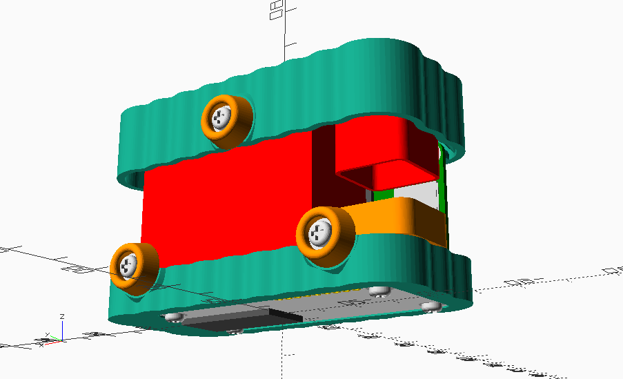

Fri, Oct 25, 2019 11:30 AM
Yes I have seen your video but what would the screen look like for the
design I am working on at the moment?
It is 350 lines of code and it has taken me a couple of days. I am the
worlds worst typist but that is not what takes the time. It is working out
how the parts are going to fit together without clashes.
