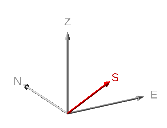

 Thanks, everyone, for your answers.
 On 2023-03-21 2:38 p.m., Adrian Mariano wrote:
 The question I ask is why the interest specifically in inverting
 a rotation of that form?
 It seemed like a handy way to define a direction for a vector
 arrow so that's how I started off. Overall, my project is to use
 OpenSCAD to create a diagram in the viewport with arrows for the
 axes, an arrow towards toward the sun, and various other elements
 that I'll add later.
 I have labels as part of the arrow objects and I want those labels
 to appear face on to the viewport irrespective of the viewport
 rotation. Therefore as I construct the objects I rotate the labels
 using $vpr then un-rotate them according to my arrow rotation,
 then I apply that rotation to the whole object.
 Using Curt's module, I got I've got my code going (see code below
 with a copy of the viewport image). I just have to redo the
 preview each time I change the viewport rotation. I plan to
 animate the output, eventually.
 If anyone is willing to spell it out for me, I'd still like to
 know how to get r2 from r1, as in my original question? My math
 isn't up to understanding the Wikipedia explanation of rotation
 matrices, nor in particular, how to turn a 3x3 rotation matrix
 into the corresponding vector variable that I would give to
 OpenSCAD's rotate.
 Steve
 $fn= 30;
 module undo_rotate(v) rotate([-v.x, 0, 0]) rotate([0, -v.y, 0])
 rotate([0, 0, -v.z]) children();
 module arrow(rotation, length, label) {
    rotate(rotation) union() {
       cylinder(h=length, d = 0.75);
       translate([0, 0, length]) cylinder(r1 = 1, r2 = 0, h = 3);
       translate([0, 0, length + 7]) undo_rotate(rotation)
 rotate($vpr) linear_extrude(1, center=true) text(label,
 valign="center", halign="center", size=3);
 color("silver", 0.1) union() {
     arrow([0, 90, 0], 30, "E");
     arrow([-90, 0, 0], 30, "N");
     arrow([0, 0, 0], 30, "Z");
 color("red") arrow([25,-45, 65], 30, "S");
