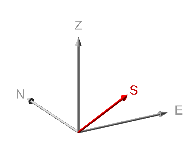

It seemed like a handy way to define a direction for a vector arrow so
that's how I started off. Overall, my project is to use OpenSCAD to create
a diagram in the viewport with arrows for the axes, an arrow towards toward
the sun, and various other elements that I'll add later.
I have labels as part of the arrow objects and I want those labels to
appear face on to the viewport irrespective of the viewport rotation.
Therefore as I construct the objects I rotate the labels using $vpr then
un-rotate them according to my arrow rotation, then I apply that rotation
to the whole object.
Using Curt's module, I got I've got my code going (see code below with a
copy of the viewport image). I just have to redo the preview each time I
change the viewport rotation. I plan to animate the output, eventually.
If anyone is willing to spell it out for me, I'd still like to know how to
get r2 from r1, as in my original question? My math isn't up to
understanding the Wikipedia explanation of rotation matrices, nor in
particular, how to turn a 3x3 rotation matrix into the corresponding vector
variable that I would give to OpenSCAD's rotate.
Steve
$fn= 30;
module undo_rotate(v) rotate([-v.x, 0, 0]) rotate([0, -v.y, 0]) rotate([0,
0, -v.z]) children();
module arrow(rotation, length, label) {
rotate(rotation) union() {
cylinder(h=length, d = 0.75);
translate([0, 0, length]) cylinder(r1 = 1, r2 = 0, h = 3);
translate([0, 0, length + 7]) undo_rotate(rotation) rotate($vpr)
linear_extrude(1, center=true) text(label, valign="center",
halign="center", size=3);
color("silver", 0.1) union() {
arrow([0, 90, 0], 30, "E");
arrow([-90, 0, 0], 30, "N");
arrow([0, 0, 0], 30, "Z");
color("red") arrow([25,-45, 65], 30, "S");

Using BOSL2, there are a couple ways you can do the opposite rotation.  If you use matrices, you can do it thus:
r1 = rot([30, 40, 50]);
r2 = matrix_inverse(r1);
color("green") cylinder(h=50);
rotate(r1) color("orange") cylinder(h=50);
rotate(r2) rotate(r1) color("red") cylinder(h=50);
More simply, however, is to use the rot(..., reverse=true) module:
r1 = [30, 40, 50];
rot(r1) color("orange") cylinder(h=50);
rot(r1, reverse=true) rot(r1) color("red") cylinder(h=50);
-Revar

I err.  The rotate()s in the first example should be multmatrix().
  • Revar
to get r2 from r1, as in my original question? My math isn't up to
Steve
$fn= 30;
rotate([0, 0, -v.z]) children();
