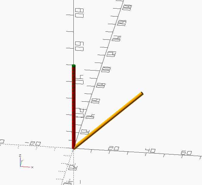

Hi everyone,
I have a small problem relating to how to use OpenSCAD to 'unrotate'
things. I hope someone here can help me ...
Say I have an object that I have rotated to a new position. I want to
get it back to where it started. However, rotating back with a negated
version of the first rotation doesn't bring an object back to its
original position. The following code sample shows the issue: the red
cylinder does not end up superimposed over the green cylinder.
r1 = [30, 40, 50];
r2 = -r1;
color("green") cylinder(h=50);
rotate(r1) color("orange") cylinder(h=50);
rotate(r2) rotate(r1) color("red") cylinder(h=50);
I realize this is because of the way rotation matrices/vectors works but
I don't know enough about the algebra to get to the solution for
myself.  I also understand that I can break the reverse process down
into three steps to get the desired result by using rotate([-r1.x,0,0])
rotate([0,-r1.y, 0]) rotate([0,0,-r1.z])  rotate(r1) color("red")
cylinder(h=50);
Doing it with three steps is a cumbersome fix, so I want to generate the
required r2 directly from r1.  How do I do that?
Thanks,
Steve

Tue, Mar 21, 2023 9:24 PM
I can do it with NopSCADlib as follows;
include <NopSCADlib/lib.scad>
r1 = [30, 40, 50];
r2 = vec3(invert(rotate(r1)) * [1, 0, 0, 0]);
//r2 = -r1;
I.e. I convert the rotation vector to a matrix and then invert it and
multiply by a unit vector in the x direction. If the matrix is only
rotations you can replace the matrix inversion with transpose(), I.e. swap
the rows and columns.

Tue, Mar 21, 2023 9:38 PM
Similar methods work in BOSL2, of course.  The question I ask is why the
interest specifically in inverting a rotation of that form?  I personally
find the Euler angle rotations very un-intuitive and never rotate by more
than one axis at a time.  Then inverting is easy.  You can do this easily
in BOSL2 by multiplying the matrices of all the rotations together to get
one rotation matrix if you like.  You can then apply it (and its transpose,
the inverse) using multmatrix().
The only other intuitive representation for rotations is to pick an
arbitrary axis and rotate around that, and in that case, the inverse
rotation is again immediately obvious.

Tue, Mar 21, 2023 9:43 PM
You could write a separate module to undo the rotation. The example
below breaks the process into three steps as you suggested, but those
steps are abstracted out once by an easy-to-understand module. Most
importantly, the points where you call the module look as simple an
intuitive as can be.
module undo_rotate(v)
    rotate([-v.x, 0, 0])
        rotate([0, -v.y, 0])
            rotate([0, 0, -v.z])
undo_rotate([30, 40, 50])
        cube([10, 20, 30]);
Personally, I avoid using the multiple-angle form of rotate() because it
obscures the type and order of rotations being performed. The
broken-down version is not so cumbersome really, and is clearer.

r2 = euler(invert(rotate(r1)));
rotate(r2) rotate(r1) color("red") cylinder(h=49);
euler() converts a rotation matrix back to a vector.

Should have been r2 = vec3(invert(rotate(r1)) * [0, 0, 0, 1]);
Still wrong, too much wine. Try this r1 = [30, 40, 50]; r2 = euler(invert(rotate(r1))); color("green") cylinder(h=50); rotate(r1) color("orange") cylinder(h=50); rotate(r2) rotate(r1) color("red") cylinder(h=49); euler() converts a rotation matrix back to a vector. [image: image.png] On Tue, 21 Mar 2023 at 21:38, nop head <nop.head@gmail.com> wrote: > Actually that was incorrect. > Should have been r2 = vec3(invert(rotate(r1)) * [0, 0, 0, 1]); > > > >

Why not just make it a module?
module unrotate(angle) rotate([-angle[0], 0, 0]) rotate([0, -angle[1], 0]) rotate([0, 0, -angle[2]]) children();

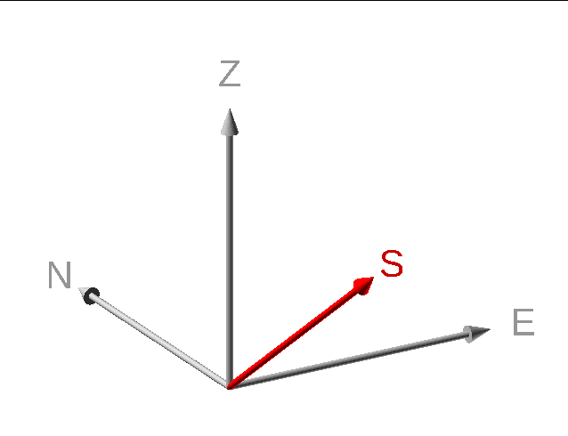

Thanks, everyone, for your answers.

The question I ask is why the interest specifically in inverting a
It seemed like a handy way to define a direction for a vector arrow so
that's how I started off. Overall, my project is to use OpenSCAD to
create a diagram in the viewport with arrows for the axes, an arrow
towards toward the sun, and various other elements that I'll add later.
I have labels as part of the arrow objects and I want those labels to
appear face on to the viewport irrespective of the viewport rotation.
Therefore as I construct the objects I rotate the labels using $vpr then
un-rotate them according to my arrow rotation, then I apply that
rotation to the whole object.
Using Curt's module, I got I've got my code going (see code below with a
copy of the viewport image). I just have to redo the preview each time I
change the viewport rotation. I plan to animate the output, eventually.
If anyone is willing to spell it out for me, I'd still like to know how
to get r2 from r1, as in my original question? My math isn't up to
understanding the Wikipedia explanation of rotation matrices, nor in
particular, how to turn a 3x3 rotation matrix into the corresponding
vector variable that I would give to OpenSCAD's rotate.
Steve
$fn= 30;
module undo_rotate(v) rotate([-v.x, 0, 0]) rotate([0, -v.y, 0])
rotate([0, 0, -v.z]) children();
