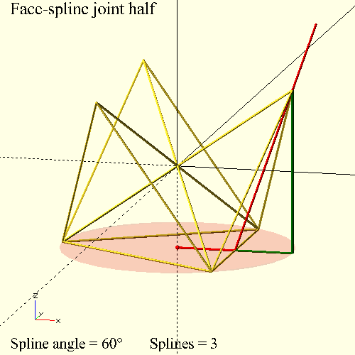

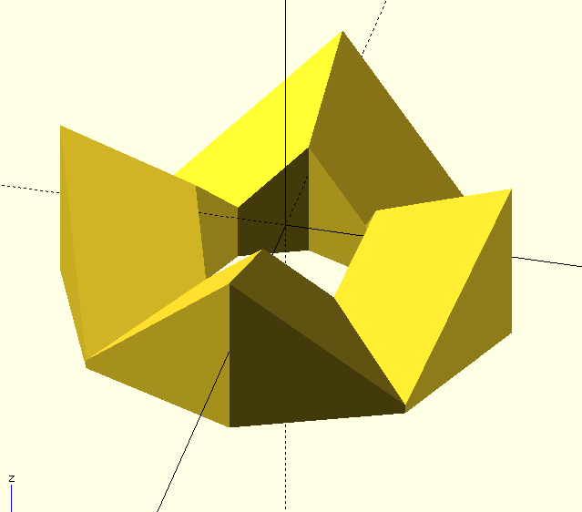

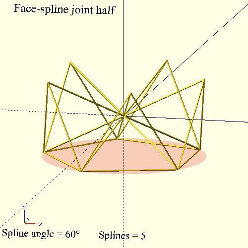

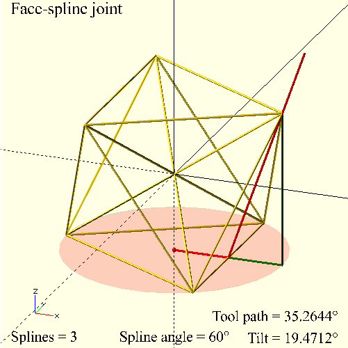

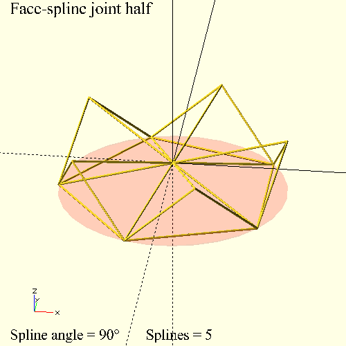

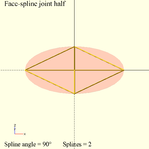

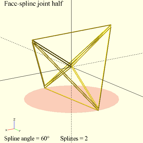

I've done a few extra calculations, and for a slope of 4.2885 degrees
then 60 degrees becomes 59.861 perpendicular to the horizontal. Since
the angles on both pieces will be the same, then afaik, they will still
mesh with the flanks of the teeth contacting each other. The teeth on
the sample that I printed were 90 degrees, and the slope was 2.4881
degrees, which would give a much less change in angle. In practice, for
sharper teeth, then simply flatten the peaks a bit more, if they tend to
bottom out. Fwiw, it is unlikely that I will be building aircraft
engines/whatever, not even for Boeing.

Yes, it is is 60 degree perpendicular to the path of the bottom of the
groove. It does not matter in many cases, since two identical units
will still mesh with each other and self centre. Back in the day, if
precision fitting was required, then most likely Prussian blue and
hand scraping would be the requirement. It would be possible to fine
adjust the angle, (increase it) by having the wheel at at a slight
angle to the traversing path (but then you get slightly curved
flanks.) Since the angle of the groove to the centre is shallow, the
difference from 60 degree, say, will be small, but could be
significant in high load situations. A simple way to overcome that,
with minimum effort, if it is not essential that both parts have
identically shaped mating surfaces, would be to generate one, and
difference from the other, so to speak, but I don't think that would
be a design for a Hirth joint.
Of course, similar 'errors' occur all over the place, thread cutting
for example, where the 60degree thread angle, in many cases, pays no
attention to the thread pitch.

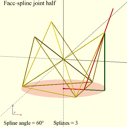

Was your failed joint an FDM print?  What scale and tooth count?  One thing
about these joints for FDM printing is that the stress is parallel to the
layer lines, so they aren't going to be able to take massive loads.  I
guess you could print a 4 tooth version on its side with no supports and it
might be stronger?  The four tooth one has an octagonal perimeter.

Also, sharp angles break easily. Adding a chamfer (yeah, I know) will help.

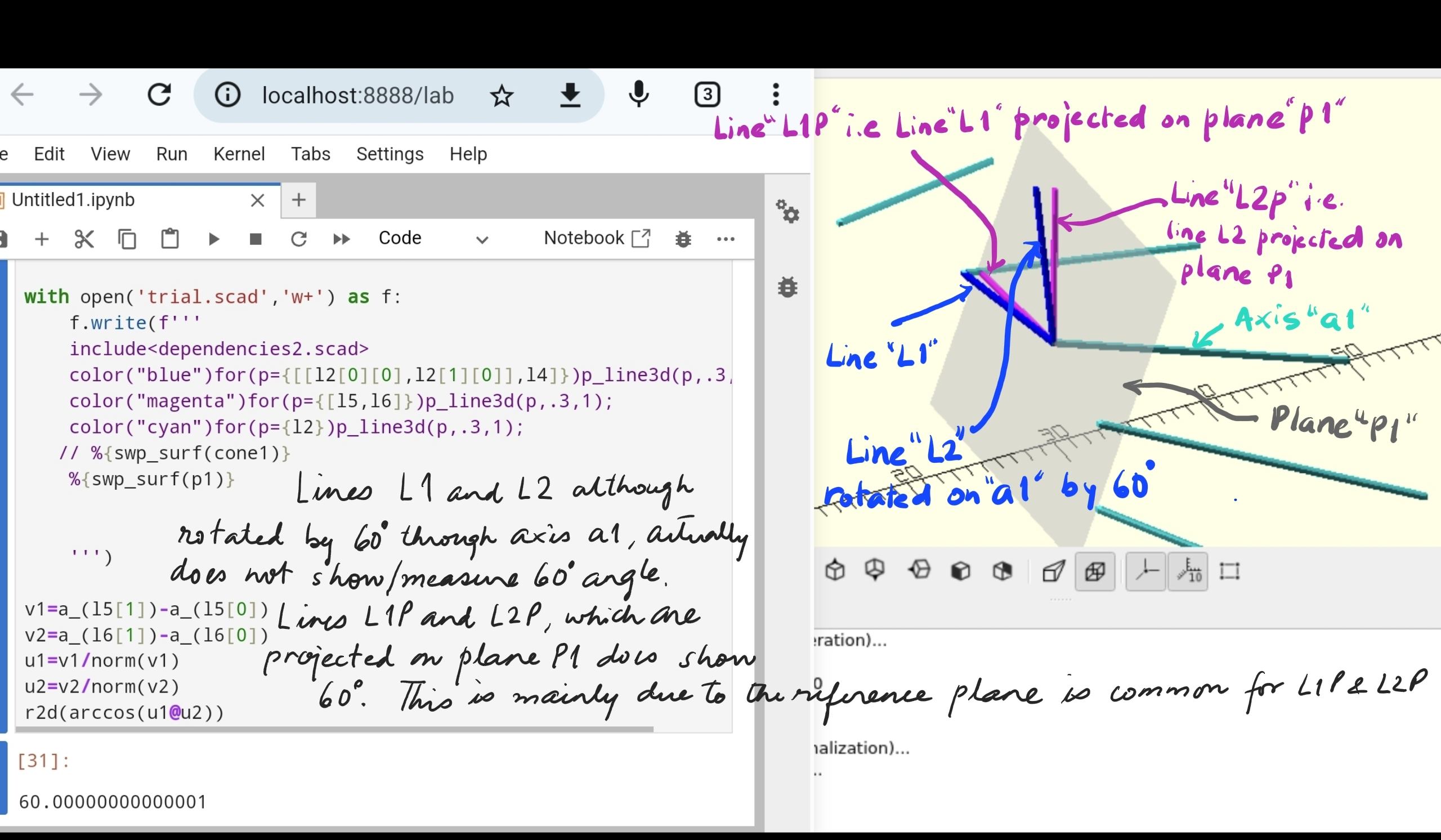

I think the error in angles are due to the frame of reference on which it
is checked.
Consider 3 cases
Case 1:
Draw a line [[0,0,0],[-10,0,0]]
Rotate it by 60 degree with y-axis as rotation axis
Project this line on x-y plane top-down and check the angle between these 2
lines and it is perfect 60 deg
Case 2:
Now change the line to [[0,0,0],[-10,-10,0]]
lines and this will show 37 something deg
Case 3:
Keep the line to [[0,0,0],[-10,-10,0]]
Project this line first on y-z plane and cosider this as line 1 and then
project this line 1 on x-y plane and check the angle between these 2 lines
and this will show again 60 deg
Since in hirth coupling the tooth angle is on many different planes it is
difficult to measure it in the right reference.
Maybe this could be the reason of distortion, which is actually not
distortion, but we do not have 1 right reference to check this angle.

I think the error in angles are due to the frame of reference on which it is checked. Consider 3 cases Case 1: Draw a line [[0,0,0],[-10,0,0]] Rotate it by 60 degree with y-axis as rotation axis Project this line on x-y plane top-down and check the angle between these 2 lines and it is perfect 60 deg Case 2: Now change the line to [[0,0,0],[-10,-10,0]] Rotate it by 60 degree with y-axis as rotation axis Project this line on x-y plane top-down and check the angle between these 2 lines and this will show 37 something deg Case 3: Keep the line to [[0,0,0],[-10,-10,0]] Rotate it by 60 degree with y-axis as rotation axis Project this line first on y-z plane and cosider this as line 1 and then project this line 1 on x-y plane and check the angle between these 2 lines and this will show again 60 deg Since in hirth coupling the tooth angle is on many different planes it is difficult to measure it in the right reference. Maybe this could be the reason of distortion, which is actually not distortion, but we do not have 1 right reference to check this angle. On Tue, 19 Nov, 2024, 7:27 pm gene heskett via Discuss, < discuss@lists.openscad.org> wrote: > On 11/18/24 10:22, John David wrote: > > Also, as someone had mentioned before, it would be good to be able to > > modify the tooth profile so it is rounded at the bottom, and truncated > > at the top - this relieves potential stress points on the bottom of the > > teeth, and allows a little clearance for dust, etc., on the top, and its > > mating surface. > > > > Gene, best of success machining a few. Should be a challenge to set up > > the first time, but crankable once the details are worked out. Please > > share pictures if you go ahead with machining them. > > > > Cheers! > > > > EBo -- > > > > On Mon, Nov 18, 2024 at 8:54 AM gene heskett via Discuss > > <discuss@lists.openscad.org <mailto:discuss@lists.openscad.org>> wrote: > > > > On 11/18/24 06:33, Raymond West via Discuss wrote: > > > > > > On 17/11/2024 21:44, Adrian Mariano via Discuss wrote: > > >> Ray, so if I understand your description, you have the blank > you're > > >> grinding mounted at an angle and you then use your 60 deg > grinding > > >> wheel to grind the groove, which due to the angled mount, tapers > > from > > >> full depth at the edge to zero depth in the center. Is that > > right? If > > >> the answer is yes, then it appears to me that the result is NOT > > a 60 > > >> deg angle on the teeth, because the cutter meets the workpiece > > at an > > >> angle, the effective tooth angle is modified by that angle at > which > > >> the blank is tilted. > > > > > > > > > Yes, it is is 60 degree perpendicular to the path of the bottom > > of the > > > groove. It does not matter in many cases, since two identical > > units will > > > still mesh with each other and self centre. Back in the day, if > > > precision fitting was required, then most likely Prussian blue > > and hand > > > scraping would be the requirement. It would be possible to fine > > adjust > > > the angle, (increase it) by having the wheel at at a slight angle > > to the > > > traversing path (but then you get slightly curved flanks.) Since > the > > > angle of the groove to the centre is shallow, the difference from > 60 > > > degree, say, will be small, but could be significant in high load > > > situations. A simple way to overcome that, with minimum effort, > > if it is > > > not essential that both parts have identically shaped mating > > surfaces, > > > would be to generate one, and difference from the other, so to > > speak, > > > but I don't think that would be a design for a Hirth joint. > > > > > > Of course, similar 'errors' occur all over the place, thread > > cutting for > > > example, where the 60degree thread angle, in many cases, pays no > > > attention to the thread pitch. > > > > > This is something I've contemplated in actual machining, where there > > are > > different tools depending on the tpi, but there is quite a broad > range > > of threads that can be cut with the same carbide chip, in my case > from > > 1/2-13 to something in the 3/8-50 range using G76, including a couple > > cases of taper for squeezing a rosette socket onto a ball screw. Been > > working that way for a decade+ in my 11x54 Sheldon of WW-II vintage. > I > > would assume any pitch ramping needed would be incorporated in the > > larger tooling I've never acquired. I did early on buy a 60 degree > > cutter for bigger holes, but have never used it, lots of math > involved > > as but it is .750" in diameter. I'd assume a 1" hole would be the > > smallest it could cut threads in. Big limited by the Y table of ones > > mill. At least 5.5" on my grizzly go704. I have a bigger mill but it > > hasn't the torque to turn that thing. > > > This migght be a good time to redo my annual sermon on adjusting > backgears on sheldons. I've posted variations of it about annually > > 1. To check if you need to do anything, start the spindle in backgear, > the pull the handle pin and START to disengage it. If the machine has a > rumble that goes away when the shift handle is lifted an inch, you have > a potentially gear breaking miss-adjustmet. The gear that will break > will eventually sheer off a whole tooth close to the root of the tooth, > is the smallest at the rear of the spindle. > . > 2. If the rumble goes away, it needs adjusted, Remove the chuck as its > hiding a screwdriver slot in the right end of the backgears shaft that > handle rotates, Then there is a clamp bolt at the root of the shift > handle, put it in gear and loosen that bolt. If not too dirty, 3/4 turn > of the bolt s/b sufficient to let that shaft be turned say 5 degrees > counter-clockwise with the biggest flat blade screwdriver you have in > the right hand end of that shaft. ping the backgear with that > screwdriver, if you turned it far enough to sound like the teachers > school bell, you're good, if its just a dull tink, its still too tight, > turn it another degree or 2. When it rings like a bell, retighten the > clamp bolt you loosened, and remount the chuck, you are done. > > I haven't a clue why its over-engaged now, headstock casting shrinkage > being one possibility after all these years (80+ for many of these) is > my best guess. One could also put it in gear, and with the spindle > stopped, ping the backgear cluster, a dull tunk tells you its too tight, > rings like a bell, you're fine. This has been found in everyone of these > machines I've since checked but I simply refuse to believe they shipped > that way new, so casting shrinkage, bringing them closer together > remains the next best guess. It only takes 5 thou to be too tight. > > Cheers, Gene Heskett, CET. > -- > "There are four boxes to be used in defense of liberty: > soap, ballot, jury, and ammo. Please use in that order." > -Ed Howdershelt (Author, 1940) > If we desire respect for the law, we must first make the law respectable. > - Louis D. Brandeis > _______________________________________________ > OpenSCAD mailing list > To unsubscribe send an email to discuss-leave@lists.openscad.org >
mikeonenine (at) web.de
Wed, Nov 20, 2024 3:51 AM
Adrian Mariano wrote:
Yes, the distances are to the center of the sides, not to corners.  Think
about arranging 2n triangles (alternating point up/point down) on a regular
2n-gon.  You need the side length of the 2n-gon, which you will want to
compute based on the distance to the center of the side.  The rotation is
around the line halfway up the triangle, which is why you want to work
based on distance to center of side and not distance to corner.  You then
compute the distance to the regular n-gon as distance to side and that
rotation can then be calculated.
I could not figure out how to make this construction work for nonzero cone
angles.  It was one of the reasons I switched to Bob's method.  I'm not
sure I agree that this approach is any less "pure."
By correction for spline angle do you mean to create teeth that actually
have the nominal angle?  I'm not sure such correction is as easy as you
think, because suppose you say, the triangle is tilted at angle theta, and
therefore I need to apply this certain correction to find the right
adjusted tooth angle.  You make this adjustment...and oops, the tilt angle
of the triangle is now different with the new tooth angle.  So you still
don't have the desired result.
On Sun, Nov 17, 2024 at 10:43 PM Caddiy via Discuss <
You have to measure the radius of the two polygons by their internal
length, so there is a cos(180/n) or cos(180/2n) factor there.
The distance from the centre to the middle of a side rather than to an
angle?
A nice thing about Bob's approach is that when you project onto a
cylinder, you
naturally construct the model at the correct size and shape with the
points
on the cylinder, so then if you don't mind a polygonal result (or at
larger
tooth counts it really doesn't matter) there's no reason to bother
intersecting with a cylinder.
It shouldn’t be too difficult to correct for an exact spline angle.
Intersecting with a cylinder is perhaps not the purist’s approach, but it
is on a level of proficiency that I can cope with.
Your method works nicely when the outer corners of the splines are positioned around the circumference of a cylinder and the desired spline angle (included angle around the ridge, usually 60° or 90°) can be set, courtesy of Mr. Pythagoras:
h=sqrt(pow(r*sin(360/n/2) / tan(a/2), 2) - pow(r*(1-cos(360/n/2)), 2));
It all fits and I have checked for 60° and 90° spline angles. It even does n=2 * 90°, which comes out flat.
Having gained a better understanding of how it works, i will have to see if it can be adapted to my original approach with tilted splines.
angle?
cylinder, you
points
larger

Explanation of incorrect angles showing

I did ponder the idea of trying to compute a correction factor to the tooth angle, but given the uncertainty about what the right angle actually is, and also uncertainty on my part about how to actually compute that correction factor, I didn't pursue this idea.  Wouldn't angle between adjacent flanks be equivalent to angle on the tooth, which is basically the other angle between flanks?  In the case of no cone angle these angles must be the same because the part mates with itself.
Another thing is that my code supports skewing the teeth so you can make teeth with one face vertical, for example.  This distorts the angle.  I didn't see a compelling reason the angle needs to be "correct".  Here an example of what you get if you ask for 60 degrees with maximal skew:
<image.png>
If I change the tooth angle to try to achieve actual 60 deg at the tops I get something like this
<image.png>
Note that the tooth height has radically changed.  From a design perspective, I think it's maybe nicer for a user to be able to skew the teeth while keeping the tooth height fixed, rather than having these parameters coupled.
In the case of very high cone angle (here 75 deg), weird stuff happens and I get shapes like this:
<image.png>
where the adjacent teeth flanks become coplanar, and then if I push cone angle higher (85 deg here) the "valley" between the teeth becomes a second ridge
<image.png>
It's not clear if forms like this are useful for anything.  The construction still works, producing a mating shape that looks like this:
<image.png>
But clearly the tooth angle measured at the tooth ridge or the complement of the angle between the flanks is wildly different from the requested 60 deg.  I'll note also that the very high cone angles look less weird when the tooth count is high, though the tooth angle is still wildly different from what was requested.  This is 75 deg angle with lots of teeth:
<image.png>
I'm not going to show another image, but if I line it up along a ridge by eye the tooth ridge angle looks like around 120 deg.  But note how the triangles running around the baes actually look like 60 deg triangles.

I have a concept that seems promising, but doing the trigonometry is like trying to swing from tree to tree in a dense jungle in a fog, so I have given up for the time being.
