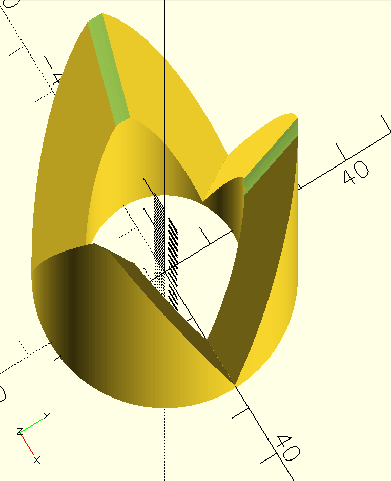

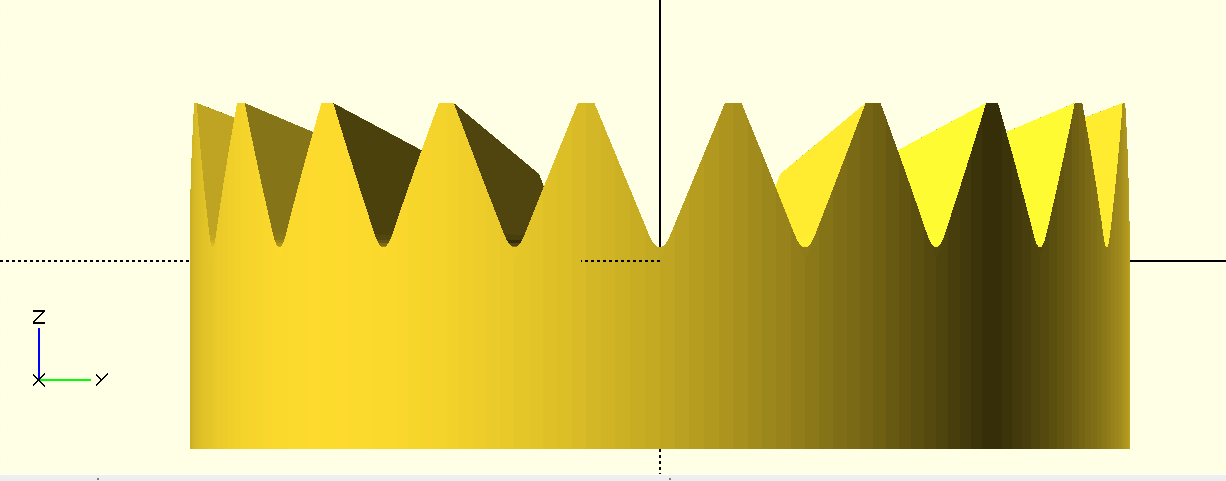

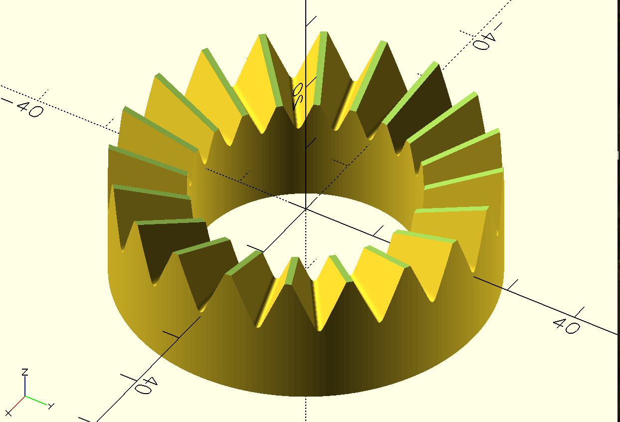

Sat, Nov 23, 2024 7:14 AM
I have revised my code based on various discussions and now the teeth angle
exactly matches with the defined angle.
This is the angle between the 2 teeth viewed from the direction of the
cutter path.
The explanation of the process of designing is complicated, but I have
attached a trial.py file which has the code for this.
Also as per my understanding till now, it is not possible to have an
inclusive teeth angle of
[image: Screenshot 2024-11-23 at 12.17.07 PM.png]
[image: Screenshot 2024-11-23 at 12.18.17 PM.png]
teeth angle of 5 deg with cone angle of 0 deg, at higher cone angles it is
not possible to go below 70 deg for 3 teeth case
[image: Screenshot 2024-11-23 at 12.32.55 PM.png]
