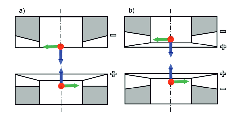

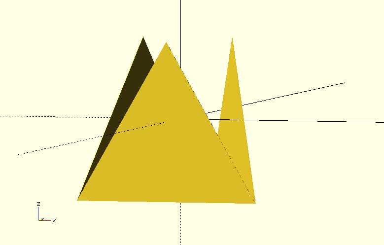

My model is based on three 60° triangles linear_extruded down to the origin, as in b) in the other diagram. The 60° triangles give 90° splines. It works if the splines are tilted slightly, but I have not been able so far to calculate a value. It looks like I won’t need to!

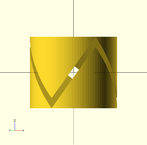

I would confirm that, the centreline being at half spline height. But with
3 splines, they only touch in the middle - see screenshot of joint with 90°
splines (included angle around the ridge, flank to flank).

View of joint straight through between two splines.

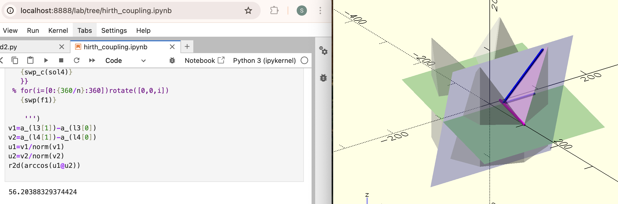

I started with the approach you are using of projecting vertical
triangles.  The way to understand the fix is to imagine the mating part,
with an upside-down triangle, filling the gap.  What constraint is required
for them to mate?  If you place such triangles in a vertical position you
can ensure that they mate at their center point by placing the centers on a
2n-gon.  But then there will be a gap between the bases of the triangles.
To fix that you need to tilt the triangles inward so their bases meet to
form a regular n-gon.  You can calculate the required tilt based on the
side length of the n-gon as a function or radius.  I ultimately abandoned
this design strategy in favor of Bob's approach based on representing the
triangles in spherical coordinates and projecting them onto a cylinder,
which is generally more intuitive, though there is an annoying complication
of having to do interpolation on the cylinder for things like calculating
the chamfer points.

a 4 tooth case with 60 deg tooth angle and 15 deg cone angle shows a
measured tooth angle of 56.2 deg.
I am surprised why it is like this?
[image: Screenshot 2024-11-18 at 7.43.53 AM.png]
3D geometry is full of surprises - that’s no surprise!
Your cone angle seems to be having a strange effect on your tooth angle.
Sanjeev Prabhakar wrote: > a 4 tooth case with 60 deg tooth angle and 15 deg cone angle shows a > measured tooth angle of 56.2 deg. > I am surprised why it is like this? > > \[image: Screenshot 2024-11-18 at 7.43.53 AM.png\] 3D geometry is full of surprises - that’s no surprise! Your cone angle seems to be having a strange effect on your tooth angle.
