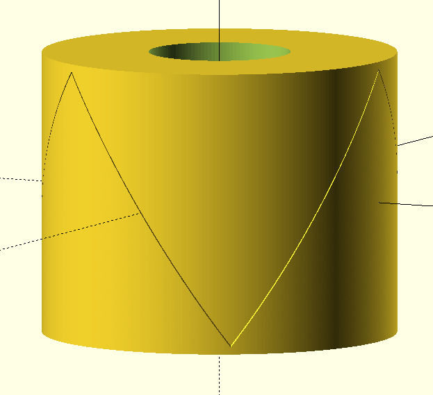

I have checked again, the tooth angles in both inner side and outer side
are exactly 80.6 and the distortion is not due to the projection on the
cylinder, it is due to the cone angle and compound effect of the 2 angles.
In my case when I keep the cone angle at 32.5 deg all the angles exactly
match the defined numbers.

Sanjeev, I didn't see that you stated what your definition of "cone angle"
is.  In my case, it's not an angle you can easily see in the model, since
it is through the CENTER of the tooth.  And yes, the deviation I was
describing with cone angle in my model is due to the effect of compound
angles, that is, if you measure tooth angle as angle between the planes of
the tooth then that changes with rising cone angle because of the compound
angle effect.
Why is 32.5 degrees a magical cone angle for your model?

Oh I think the explanation I sent earlier had some pictures which exceeded
the acceptable size for mails here and did not reach anyone.
The angle tooth makes with x-y plane is the angle of the tooth.
32.5 is only for the case where tooth angle is 80 degree, number of teeth
are 50 and cone angle if set to 32.5.
For different configurations this might change.
Also I did not try to measure the angle if tooth face is intersected by a
vertical plane perpendicular to tooth line joining the inner and outer
points.
Maybe that would be correct angle. But I am not sure

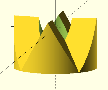

Regarding tooth angle, I attempted to measure it at the tooth ridge with
nominal tooth angle set to 60 and zero cone angle.  With four teeth I get
76.8 deg instead of 60 deg.  With 44 teeth I get 60.16 deg.  With 144 teeth
it's 60.01 deg.  If I raise the cone angle to 30 deg then I actually get
60.4 in the 4 tooth case, but in the 44 tooth case it's now 65.5 deg and
with 144 teeth it's 66.8 deg.  Why does the 30 deg cone angle make the 4
tooth case so close to the nominal angle?  It's because the tooth ridge in
this case is very close to parallel to the xy plane, which matches the
design angle reference for the construction of the triangle.    Here's a
picture (4 teeth, 30 deg cone angle, 60 deg nominal tooth angle):
So it seems like the deviation of tooth angle for small tooth count has to
do with fitting the teeth around a circle.  When you have lots of teeth,
it's approximately like fitting the teeth onto a line and nothing weird
happens, but when you curve just 4 teeth around a circle, the angles no
longer add up as expected for flat geometry, resulting in an alteration of
the actual realized tooth angle.  So to produce teeth that match the
nominal angle there are two corrections needed.  One is a correction for
fitting a linear arrangement of triangles around a circle, with increasing
correction as the number of teeth shrinks.  The other one has to do with
cone angle, and at least for my definition of cone angle, the correction
looks like it gets smaller and then larger again as you increase the cone
angle---at least for the small tooth count case.
with nominal tooth angle set to 60 and zero cone angle.  With four
teeth I get 76.8 deg instead of 60 deg. With 44 teeth I get 60.16
deg.  With 144 teeth it's 60.01 deg.   If I raise the cone angle to 30
deg then I actually get 60.4 in the 4 tooth case, but in the 44 tooth
case it's now 65.5 deg and with 144 teeth it's 66.8 deg.   Why does
the 30 deg cone angle make the 4 tooth case so close to the nominal
angle?  It's because the tooth ridge in this case is very close to
parallel to the xy plane, which matches the design angle reference for
the construction of the triangle. Here's a picture (4 teeth, 30 deg
has to do with fitting the teeth around a circle. When you have lots
of teeth, it's approximately like fitting the teeth onto a line and
nothing weird happens, but when you curve just 4 teeth around a
circle, the angles no longer add up as expected for flat geometry,
resulting in an alteration of the actual realized tooth angle.  So to
produce teeth that match the nominal angle there are two corrections
needed.  One is a correction for fitting a linear arrangement of
triangles around a circle, with increasing correction as the number of
teeth shrinks.  The other one has to do with cone angle, and at least
for my definition of cone angle, the correction looks like it gets
smaller and then larger again as you increase the cone angle---at

Mon, Nov 18, 2024 12:16 AM
I'm not sure what you mean about "with 3 splines they only touch in the
middle".  That's only true if the model is wrong, like so many of my early
attempts.  With a correct model this is not the case, of course.  What
model gave you the behavior in question?  Or do you mean the model
constructed as described by Ray?  It may be the case that an improper fit
was good enough for machinists making these joints with lots of teeth?  For
my current code I get the image below, where I separated the parts by a
tiny amount to show the gap.  I'm pretty sure Bob's model also gives the
same result, namely that parts mate exactly along the entire joint
surface.  Our models are designed mathematically to ensure that they mate
exactly.  I realized that I never really examined Ray's model because I
couldn't get it to render in either OpenSCAD I had (not the stable nor the
dev) and preview was unusably slow on my machine.
