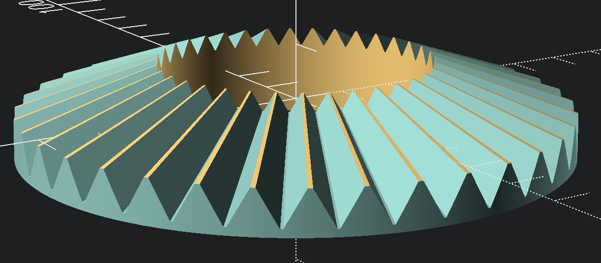

I’ve attached my code that I now believe is debugged and working reliably. It supports all the way down to N=2 (teeth). Depending on N it renders in .25 to .5 s. Preview is similar.
When N = 2 or 3 this is an edge condition that required a lot of testing and work. The other area that caused the most problems was when the “coned” argument was at or around half the tooth height (as measured at the outer radius.) Around this point any auxiliary shapes you use to add a base, add or subtract a chamfer etc, switch from concave to convex or vice versa.
One file is Customizer enabled and serves as the test platform for the second file where all the working code is. The test file also includes some visualization aids that I wrote to help see exactly what is going on.
A note about the anchors. They are all relative to the entire joint. This makes it easier to position both parts in a larger assembly in a way that insures the parts mesh exactly.

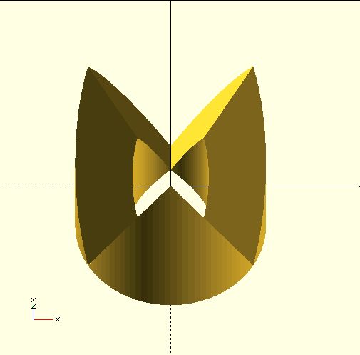

If you want to identify a specific case for reproducing a problem with
skin() I can take a look at it, but I couldn't find anything obviously
wrong in a brief bit of fiddling with parameters.

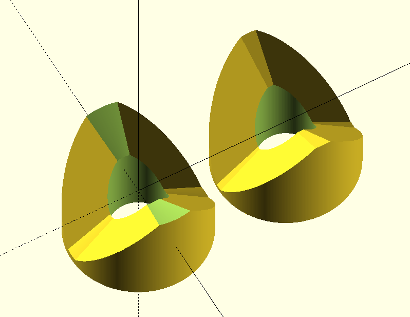

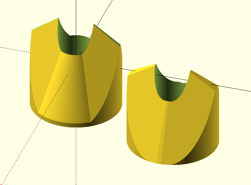

It's interesting how rather different our hirth joints can look for similar
parameters.  For 2 teeth, with no cone angle/distance they are pretty
similar:
but with an extreme cone setting (I was trying to set it to the tooth
height to create the problem you described) they are rather different:
Note that mine are symmetric in that a single module produces both halves
and you specify conical with an angle, and then use the negative angle to
make the mate.

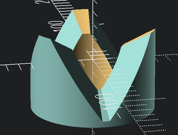

-Bob

At the trough it should be a fillet rather than chamfer. On the crest it
should be chamfer.
