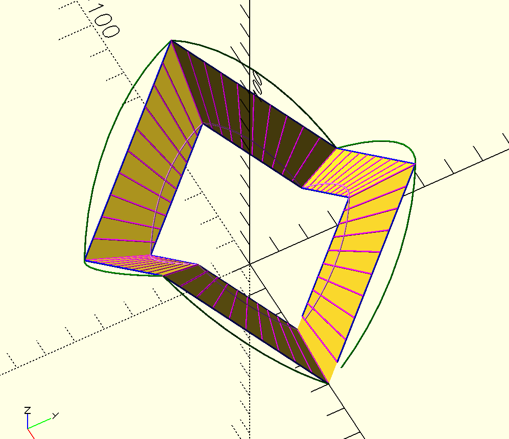

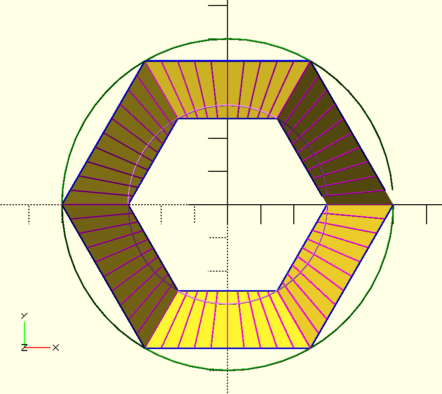

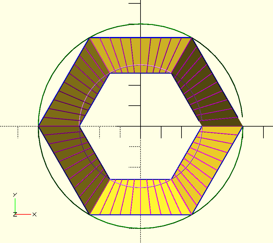

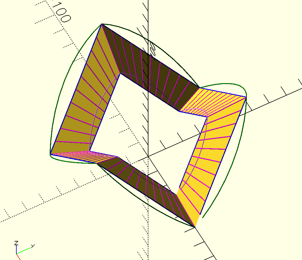

I do not understand the pictures.  Or at least the top one is mystifying.
The bottom one looks like it could describe the process: the projection is
along vectors that originate at the origin and yes, you have a separate
projection onto the inner and outer cylinder.
On Wed, Nov 6, 2024 at 11:24 PM Sanjeev Prabhakar sprabhakar2006@gmail.com
I don't think the straight projection on cylinder will work.
The only way I think this can work is if you project using vectors
considering outer race and inner race, projecting outwards and inwards
respectively on outer and inner cylinder.
picture below can make this clear.
magenta lines are the vectors
[image: Screenshot 2024-11-07 at 9.49.27 AM.png]
[image: Screenshot 2024-11-07 at 9.53.29 AM.png]

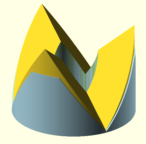

Bob, I did I think exactly the same thing in my code and didn't notice
anything, but now that you mention it, doing chamfers on an angular basis
is of course not going to match doing them on a linear basis.  So that
means the geometry changes a bit if you change the chamfer size.  This
isn't necessarily catastrophic, but is a little unexpected, I suppose.
Generally speaking you can't mate two parts produced with different chamfer
size anyway, so I'm not sure this is crucial to get right.  But in order to
get it right, I think both thetaCA2 and phiCA are going to need to be
computed with trig---either that or there's some complicated way of
computing just one.  The question is whether these two parameters can be
computed independently or are they related in some complicated way.

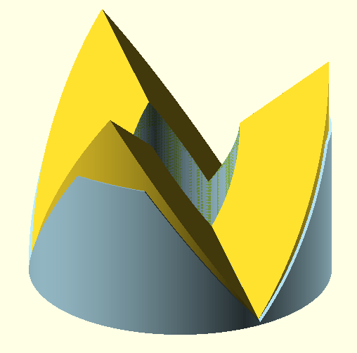

Treated as a 2d problem you are trying to get the angle that corresponds to
a fraction of a chord of the circle, which is a reasonably straight forward
triangle calculation.  I got atan(chamfer*tan(angle)) where angle is
180/tooth_count for the ridge chamfer.  But the chamfered one still doesn't
align with the unchamfered.  For example:
Yellow is unchamfered.  Blue has huge chamfer applied only at ridge (and
slightly larger radius so we can see it clearly).  And we see that the
angle has changed.  I actually got less error with the original
calculation, but that might be because I didn't correct the phi angle only
the theta angle.  (Or maybe I botched the trig.)  So I tried computing a
correction for phi and got ridge_angle-atan(ridge_angle -
chamfer*(tan(ridge_angle)-tan(valley_angle))), but still things don't line
up correctly.  (And the horizontal correction is still worse than not,
which makes me wonder if the horizontal correction needs to take into
account the vertical position of the chamfer somehow.)  Doing the phi
correction alone actually is an improvement over no correction.

I do not understand the pictures. Or at least the top one is mystifying. The bottom one looks like it could describe the process: the projection is along vectors that originate at the origin and yes, you have a separate projection onto the inner and outer cylinder. On Wed, Nov 6, 2024 at 11:24 PM Sanjeev Prabhakar <sprabhakar2006@gmail.com> wrote: > I don't think the straight projection on cylinder will work. > The only way I think this can work is if you project using vectors > considering outer race and inner race, projecting outwards and inwards > respectively on outer and inner cylinder. > picture below can make this clear. > magenta lines are the vectors > [image: Screenshot 2024-11-07 at 9.49.27 AM.png] > [image: Screenshot 2024-11-07 at 9.53.29 AM.png] > > On Thu, 7 Nov, 2024, 8:12 am Adrian Mariano via Discuss, < > discuss@lists.openscad.org> wrote: > >> Bob, I did I think exactly the same thing in my code and didn't notice >> anything, but now that you mention it, doing chamfers on an angular basis >> is of course not going to match doing them on a linear basis. So that >> means the geometry changes a bit if you change the chamfer size. This >> isn't necessarily catastrophic, but is a little unexpected, I suppose. >> Generally speaking you can't mate two parts produced with different chamfer >> size anyway, so I'm not sure this is crucial to get right. But in order to >> get it right, I think both thetaCA2 and phiCA are going to need to be >> computed with trig---either that or there's some complicated way of >> computing just one. The question is whether these two parameters can be >> computed independently or are they related in some complicated way. >> Treated as a 2d problem you are trying to get the angle that corresponds to >> a fraction of a chord of the circle, which is a reasonably straight forward >> triangle calculation. I got atan(chamfer*tan(angle)) where angle is >> 180/tooth_count for the ridge chamfer. But the chamfered one still doesn't >> align with the unchamfered. For example: >> >> [image: image.png] >> >> Yellow is unchamfered. Blue has huge chamfer applied only at ridge (and >> slightly larger radius so we can see it clearly). And we see that the >> angle has changed. I actually got less error with the original >> calculation, but that might be because I didn't correct the phi angle only >> the theta angle. (Or maybe I botched the trig.) So I tried computing a >> correction for phi and got ridge_angle-atan(ridge_angle - >> chamfer*(tan(ridge_angle)-tan(valley_angle))), but still things don't line >> up correctly. (And the horizontal correction is still worse than not, >> which makes me wonder if the horizontal correction needs to take into >> account the vertical position of the chamfer somehow.) Doing the phi >> correction alone actually is an improvement over no correction. >> >> Here's my current code (without any chamfer corrections). It does >> rounding and skew teeth. >> >> module hirth(n, ir, or, id, od, tooth_angle=60, cone_angle=0, chamfer, >> rounding, base=1, crop=false,skew=0, rot=false, orient,anchor,spin) >> { >> ir = get_radius(r=ir,d=id); >> or = get_radius(r=or,d=od); >> dummy = assert(all_positive([ir]), "ir/id must be a positive value") >> assert(all_positive([or]), "or/od must be a positive value") >> assert(is_int(n) && n>1, "n must be an integer larger than 1") >> assert(is_finite(skew) && abs(skew)<=1, "skew must be a number >> between -1 and 1") >> assert(ir<or, "inside radius (ir/id) must be smaller than >> outside radius (or/od)") >> assert(all_positive([tooth_angle]) && >> tooth_angle<360*(n-1)/2/n, str("tooth angle must be between 0 and >> ",360*(n-1)/2/n," for spline with ",n," teeth.")) >> assert(num_defined([chamfer,rounding]) <=1, "Cannot define both >> chamfer and rounding") >> assert(is_undef(chamfer) || all_nonnegative([chamfer]) && >> chamfer<1/2, "chamfer must be a non-negative value smaller than 1/2") >> assert(is_undef(rounding) || all_nonnegative([rounding]) && >> rounding<1/2, "rounding must be a non-negative value smaller than 1/2") >> assert(all_positive([base]), "base must be a positive value") ; >> tooth_height = sin(180/n) / tan(tooth_angle/2); // Normalized tooth >> height >> cone_height = -tan(cone_angle); // Normalized >> height change corresponding to the cone angle >> ridge_angle = atan(tooth_height/2 + cone_height); >> valley_angle = atan(-tooth_height/2 + cone_height); >> angle = 180/n; // Half the angle occupied by each tooth going around >> the circle >> >> factor = crop ? 3 : 1; // Make it oversized when crop is true >> >> profile = is_undef(rounding) || rounding==0 ? >> let( >> chamfer=default(chamfer,0), >> vchamf = chamfer*(ridge_angle-valley_angle), >> pts = [ >> [-angle*(1-chamfer/2), >> valley_angle+vchamf/2], >> [-angle*chamfer, ridge_angle-vchamf] >> ], >> full = deduplicate(concat(pts, reverse(xflip(pts)))) >> ) >> back(valley_angle, >> skew(sxy=skew*angle/(ridge_angle-valley_angle),fwd(valley_angle,full))) >> : let( >> vround=rounding*(ridge_angle-valley_angle), >> profpts = [ >> [ -angle, valley_angle+vround/2], >> [ -angle*(1-rounding/2), >> valley_angle+vround/2], >> [ -angle*rounding, ridge_angle-vround], >> ], >> segs = max(16,segs(or*rounding)), >> full = concat(profpts, reverse(xflip(profpts))), >> skewed = back(valley_angle, >> skew(sxy=skew*angle/(ridge_angle-valley_angle),fwd(valley_angle,full))), >> // Using computed values for the joints >> lead to round-off error issues >> joints = [(skewed[1]-skewed[0]).x, >> (skewed[3]-skewed[2]).x/2, >> (skewed[3]-skewed[2]).x/2,(skewed[5]-skewed[4]).x ], >> roundpts = round_corners(skewed, joint=joints, >> closed=false,$fn=segs) >> ) >> roundpts; >> >> // project spherical coordinate point onto cylinder of radius r >> cyl_proj = function (r,theta_phi) >> [for(pt=theta_phi) >> let(xyz = spherical_to_xyz(1,pt[0], 90-pt[1])) >> r * xyz / norm(point2d(xyz))]; >> >> bottom = >> min([tan(valley_angle)*ir,tan(valley_angle)*or])-base-cone_height*ir; >> safebottom = >> min([tan(valley_angle)*ir/factor,tan(valley_angle)*or*factor])-base-(crop?1:0)-cone_height*ir; >> ang_ofs = !rot ? -skew*angle >> : n%2==0 ? -(angle-skew*angle) - skew*angle >> : -angle*(2-skew)-skew*angle; >> topinner = down(cone_height*ir,[for(ang=lerpn(0,360,n,endpoint=false)) >> each >> zrot(ang+ang_ofs,cyl_proj(ir/factor,profile))]); >> topouter = down(cone_height*ir,[for(ang=lerpn(0,360,n,endpoint=false)) >> each >> zrot(ang+ang_ofs,cyl_proj(factor*or,profile))]); >> botinner = [for(val=topinner) [val.x,val.y,safebottom]]; >> botouter = [for(val=topouter) [val.x,val.y,safebottom]]; >> vert = [topouter, topinner, botinner, botouter]; >> >> anchors = [ >> named_anchor("teeth_bot", [0,0,bottom], DOWN) >> ]; >> attachable(anchor=anchor,spin=spin,orient=orient, r=or, >> h=-2*bottom,anchors=anchors){ >> intersection(){ >> vnf_polyhedron(vnf_vertex_array(vert, reverse=true, >> col_wrap=true, row_wrap=true),convexity=min(10,n)); >> if (crop) >> >> zmove(bottom)tube(or=or,ir=ir,height=4*or,anchor=BOT,$fa=1,$fs=1); >> } >> children(); >> } >> } >> >> >> >> On Wed, Nov 6, 2024 at 7:55 PM Bob Carlson via Discuss < >> discuss@lists.openscad.org> wrote: >> >>> I have established that there is an error in the code fragment. The line >>> >>> thetaCA2 = _toothAngle(hs) * _chamfer(hs)/200; >>> >>> Is where the error lies. What should it be? I was assuming that the >>> theta for the chamfer “shoulder” point would be proportional to the chamfer >>> but it produces a slight error. It is barely noticeable but gets more >>> blatant at low tooth counts and high conic. >>> >>> Anyone see what it should be? I’m guessing there is some trig >>> functions involved,but ... >>> >>> -Bob >>> >>> On Nov 5, 2024, at 10:29, Bob Carlson via Discuss < >>> discuss@lists.openscad.org> wrote: >>> >>> Here is just a code fragment but it gets the point across. >>> >>> IR = _ir(hs); >>> OR = _or(hs) / cos(180/_n(hs)); // OR is the radius of the >>> circumscribing polygon of N >>> >>> // Ridge Chamfer >>> thetaCA2 = _toothAngle(hs) * _chamfer(hs)/200; >>> phiCA = (_grooveAngle(hs) -_ridgeAngle(hs)) * _chamfer(hs)/100; >>> >>> function profileToooth(r) = >>> [spherical2_to_xyz(r, thetaCA2, _ridgeAngle(hs) + >>> phiCA), >>> spherical2_to_xyz(r, _toothAngle(hs)/2, _grooveAngle(hs)), >>> spherical2_to_xyz(r, -_toothAngle(hs)/2, _grooveAngle(hs)), >>> spherical2_to_xyz(r, - thetaCA2, _ridgeAngle(hs) + >>> phiCA) >>> ]; >>> >>> >>> _______________________________________________ >>> OpenSCAD mailing list >>> To unsubscribe send an email to discuss-leave@lists.openscad.org >>> >> _______________________________________________ >> OpenSCAD mailing list >> To unsubscribe send an email to discuss-leave@lists.openscad.org >> >
Thu, Nov 7, 2024 11:23 AM
All the magenta lines are vectors, you can think of them originating from
any side of the line.
Each line intersects a circumscribing cylinder outer or inner and that
forms the circular hirth coupling.

All the magenta lines are vectors, you can think of them originating from any side of the line. Each line intersects a circumscribing cylinder outer or inner and that forms the circular hirth coupling. On Thu, 7 Nov, 2024, 4:40 pm Adrian Mariano, <avm4@cornell.edu> wrote: > I do not understand the pictures. Or at least the top one is mystifying. > The bottom one looks like it could describe the process: the projection is > along vectors that originate at the origin and yes, you have a separate > projection onto the inner and outer cylinder. > > On Wed, Nov 6, 2024 at 11:24 PM Sanjeev Prabhakar < > sprabhakar2006@gmail.com> wrote: > >> I don't think the straight projection on cylinder will work. >> The only way I think this can work is if you project using vectors >> considering outer race and inner race, projecting outwards and inwards >> respectively on outer and inner cylinder. >> picture below can make this clear. >> magenta lines are the vectors >> [image: Screenshot 2024-11-07 at 9.49.27 AM.png] >> [image: Screenshot 2024-11-07 at 9.53.29 AM.png] >> >> On Thu, 7 Nov, 2024, 8:12 am Adrian Mariano via Discuss, < >> discuss@lists.openscad.org> wrote: >> >>> Bob, I did I think exactly the same thing in my code and didn't notice >>> anything, but now that you mention it, doing chamfers on an angular basis >>> is of course not going to match doing them on a linear basis. So that >>> means the geometry changes a bit if you change the chamfer size. This >>> isn't necessarily catastrophic, but is a little unexpected, I suppose. >>> Generally speaking you can't mate two parts produced with different chamfer >>> size anyway, so I'm not sure this is crucial to get right. But in order to >>> get it right, I think both thetaCA2 and phiCA are going to need to be >>> computed with trig---either that or there's some complicated way of >>> computing just one. The question is whether these two parameters can be >>> computed independently or are they related in some complicated way. >>> Treated as a 2d problem you are trying to get the angle that corresponds to >>> a fraction of a chord of the circle, which is a reasonably straight forward >>> triangle calculation. I got atan(chamfer*tan(angle)) where angle is >>> 180/tooth_count for the ridge chamfer. But the chamfered one still doesn't >>> align with the unchamfered. For example: >>> >>> [image: image.png] >>> >>> Yellow is unchamfered. Blue has huge chamfer applied only at ridge (and >>> slightly larger radius so we can see it clearly). And we see that the >>> angle has changed. I actually got less error with the original >>> calculation, but that might be because I didn't correct the phi angle only >>> the theta angle. (Or maybe I botched the trig.) So I tried computing a >>> correction for phi and got ridge_angle-atan(ridge_angle - >>> chamfer*(tan(ridge_angle)-tan(valley_angle))), but still things don't line >>> up correctly. (And the horizontal correction is still worse than not, >>> which makes me wonder if the horizontal correction needs to take into >>> account the vertical position of the chamfer somehow.) Doing the phi >>> correction alone actually is an improvement over no correction. >>> >>> Here's my current code (without any chamfer corrections). It does >>> rounding and skew teeth. >>> >>> module hirth(n, ir, or, id, od, tooth_angle=60, cone_angle=0, chamfer, >>> rounding, base=1, crop=false,skew=0, rot=false, orient,anchor,spin) >>> { >>> ir = get_radius(r=ir,d=id); >>> or = get_radius(r=or,d=od); >>> dummy = assert(all_positive([ir]), "ir/id must be a positive value") >>> assert(all_positive([or]), "or/od must be a positive value") >>> assert(is_int(n) && n>1, "n must be an integer larger than 1") >>> assert(is_finite(skew) && abs(skew)<=1, "skew must be a number >>> between -1 and 1") >>> assert(ir<or, "inside radius (ir/id) must be smaller than >>> outside radius (or/od)") >>> assert(all_positive([tooth_angle]) && >>> tooth_angle<360*(n-1)/2/n, str("tooth angle must be between 0 and >>> ",360*(n-1)/2/n," for spline with ",n," teeth.")) >>> assert(num_defined([chamfer,rounding]) <=1, "Cannot define >>> both chamfer and rounding") >>> assert(is_undef(chamfer) || all_nonnegative([chamfer]) && >>> chamfer<1/2, "chamfer must be a non-negative value smaller than 1/2") >>> assert(is_undef(rounding) || all_nonnegative([rounding]) && >>> rounding<1/2, "rounding must be a non-negative value smaller than 1/2") >>> assert(all_positive([base]), "base must be a positive value") ; >>> tooth_height = sin(180/n) / tan(tooth_angle/2); // Normalized >>> tooth height >>> cone_height = -tan(cone_angle); // Normalized >>> height change corresponding to the cone angle >>> ridge_angle = atan(tooth_height/2 + cone_height); >>> valley_angle = atan(-tooth_height/2 + cone_height); >>> angle = 180/n; // Half the angle occupied by each tooth going >>> around the circle >>> >>> factor = crop ? 3 : 1; // Make it oversized when crop is true >>> >>> profile = is_undef(rounding) || rounding==0 ? >>> let( >>> chamfer=default(chamfer,0), >>> vchamf = chamfer*(ridge_angle-valley_angle), >>> pts = [ >>> [-angle*(1-chamfer/2), >>> valley_angle+vchamf/2], >>> [-angle*chamfer, ridge_angle-vchamf] >>> ], >>> full = deduplicate(concat(pts, reverse(xflip(pts)))) >>> ) >>> back(valley_angle, >>> skew(sxy=skew*angle/(ridge_angle-valley_angle),fwd(valley_angle,full))) >>> : let( >>> vround=rounding*(ridge_angle-valley_angle), >>> profpts = [ >>> [ -angle, valley_angle+vround/2], >>> [ -angle*(1-rounding/2), >>> valley_angle+vround/2], >>> [ -angle*rounding, ridge_angle-vround], >>> ], >>> segs = max(16,segs(or*rounding)), >>> full = concat(profpts, reverse(xflip(profpts))), >>> skewed = back(valley_angle, >>> skew(sxy=skew*angle/(ridge_angle-valley_angle),fwd(valley_angle,full))), >>> // Using computed values for the joints >>> lead to round-off error issues >>> joints = [(skewed[1]-skewed[0]).x, >>> (skewed[3]-skewed[2]).x/2, >>> (skewed[3]-skewed[2]).x/2,(skewed[5]-skewed[4]).x ], >>> roundpts = round_corners(skewed, joint=joints, >>> closed=false,$fn=segs) >>> ) >>> roundpts; >>> >>> // project spherical coordinate point onto cylinder of radius r >>> cyl_proj = function (r,theta_phi) >>> [for(pt=theta_phi) >>> let(xyz = spherical_to_xyz(1,pt[0], 90-pt[1])) >>> r * xyz / norm(point2d(xyz))]; >>> >>> bottom = >>> min([tan(valley_angle)*ir,tan(valley_angle)*or])-base-cone_height*ir; >>> safebottom = >>> min([tan(valley_angle)*ir/factor,tan(valley_angle)*or*factor])-base-(crop?1:0)-cone_height*ir; >>> ang_ofs = !rot ? -skew*angle >>> : n%2==0 ? -(angle-skew*angle) - skew*angle >>> : -angle*(2-skew)-skew*angle; >>> topinner = down(cone_height*ir,[for(ang=lerpn(0,360,n,endpoint=false)) >>> each >>> zrot(ang+ang_ofs,cyl_proj(ir/factor,profile))]); >>> topouter = down(cone_height*ir,[for(ang=lerpn(0,360,n,endpoint=false)) >>> each >>> zrot(ang+ang_ofs,cyl_proj(factor*or,profile))]); >>> botinner = [for(val=topinner) [val.x,val.y,safebottom]]; >>> botouter = [for(val=topouter) [val.x,val.y,safebottom]]; >>> vert = [topouter, topinner, botinner, botouter]; >>> >>> anchors = [ >>> named_anchor("teeth_bot", [0,0,bottom], DOWN) >>> ]; >>> attachable(anchor=anchor,spin=spin,orient=orient, r=or, >>> h=-2*bottom,anchors=anchors){ >>> intersection(){ >>> vnf_polyhedron(vnf_vertex_array(vert, reverse=true, >>> col_wrap=true, row_wrap=true),convexity=min(10,n)); >>> if (crop) >>> >>> zmove(bottom)tube(or=or,ir=ir,height=4*or,anchor=BOT,$fa=1,$fs=1); >>> } >>> children(); >>> } >>> } >>> >>> >>> >>> On Wed, Nov 6, 2024 at 7:55 PM Bob Carlson via Discuss < >>> discuss@lists.openscad.org> wrote: >>> >>>> I have established that there is an error in the code fragment. The line >>>> >>>> thetaCA2 = _toothAngle(hs) * _chamfer(hs)/200; >>>> >>>> Is where the error lies. What should it be? I was assuming that the >>>> theta for the chamfer “shoulder” point would be proportional to the chamfer >>>> but it produces a slight error. It is barely noticeable but gets more >>>> blatant at low tooth counts and high conic. >>>> >>>> Anyone see what it should be? I’m guessing there is some trig >>>> functions involved,but ... >>>> >>>> -Bob >>>> >>>> On Nov 5, 2024, at 10:29, Bob Carlson via Discuss < >>>> discuss@lists.openscad.org> wrote: >>>> >>>> Here is just a code fragment but it gets the point across. >>>> >>>> IR = _ir(hs); >>>> OR = _or(hs) / cos(180/_n(hs)); // OR is the radius of the >>>> circumscribing polygon of N >>>> >>>> // Ridge Chamfer >>>> thetaCA2 = _toothAngle(hs) * _chamfer(hs)/200; >>>> phiCA = (_grooveAngle(hs) -_ridgeAngle(hs)) * _chamfer(hs)/100; >>>> >>>> function profileToooth(r) = >>>> [spherical2_to_xyz(r, thetaCA2, _ridgeAngle(hs) + >>>> phiCA), >>>> spherical2_to_xyz(r, _toothAngle(hs)/2, _grooveAngle(hs)), >>>> spherical2_to_xyz(r, -_toothAngle(hs)/2, _grooveAngle(hs)), >>>> spherical2_to_xyz(r, - thetaCA2, _ridgeAngle(hs) + >>>> phiCA) >>>> ]; >>>> >>>> >>>> _______________________________________________ >>>> OpenSCAD mailing list >>>> To unsubscribe send an email to discuss-leave@lists.openscad.org >>>> >>> _______________________________________________ >>> OpenSCAD mailing list >>> To unsubscribe send an email to discuss-leave@lists.openscad.org >>> >>

[image: Screenshot 2024-11-07 at 10.26.12 AM.png]
On Thu, 7 Nov 2024 at 09:54, Sanjeev Prabhakar sprabhakar2006@gmail.com
(and slightly larger radius so we can see it clearly).  And we see that the

In the to picture, there is no cylinder pictured, but some complicated
shape with multiple curves, some of which are not even circular arcs.  So I
don't understand that picture.  You can try the code I posted earlier,
which uses the cylinder projection approach.
On Thu, Nov 7, 2024 at 6:23 AM Sanjeev Prabhakar sprabhakar2006@gmail.com

All errors are fatal when you run with the stop on first warning feature,
which is generally necessary to avoid overwhelming useless cascading error
messages.
Under the stable openscad that I used the model fails to render using the
code exactly as posted. This is because it contains some reversed faces
that can be seen with thrown together. I didn’t know that manifold would
fix those with a warning. I generally prefer to use polyhedron creation
tools to make fully valid face sets.
Even after fixing that problem something else is wrong because I get the
message that the object may not be a valid 2-manifold. I don’t know what
the other problem is. Maybe it’s because wedges touch at their edges?
The problem of sluggish preview also remains.

I think that to get this right you basically need to take the top point of
the triangle and one of the bottom points of the triangle in their position
projected onto the cylinder, represent in cartesian coordinates, then
interpolate appropriately between them by the chamfer fraction, then
convert back to spherical coordinates to extract the angles.  You can work
through those steps to get some complicated formula, but it looked messy.
I couldn't think of any simpler approach.
Is where the error lies. What should it be? I was assuming that the theta
for the chamfer “shoulder” point would be proportional to the chamfer but
it produces a slight error. It is barely noticeable but gets more blatant
-Bob

I think that to get this right you basically need to take the top point of the triangle and one of the bottom points of the triangle in their position projected onto the cylinder, represent in cartesian coordinates, then interpolate appropriately between them by the chamfer fraction, then convert back to spherical coordinates to extract the angles. You can work through those steps to get some complicated formula, but it looked messy. I couldn't think of any simpler approach. On Wed, Nov 6, 2024 at 7:55 PM Bob Carlson via Discuss < discuss@lists.openscad.org> wrote: > I have established that there is an error in the code fragment. The line > > thetaCA2 = _toothAngle(hs) * _chamfer(hs)/200; > > Is where the error lies. What should it be? I was assuming that the theta > for the chamfer “shoulder” point would be proportional to the chamfer but > it produces a slight error. It is barely noticeable but gets more blatant > at low tooth counts and high conic. > > Anyone see what it should be? I’m guessing there is some trig > functions involved,but ... > > -Bob > > On Nov 5, 2024, at 10:29, Bob Carlson via Discuss < > discuss@lists.openscad.org> wrote: > > Here is just a code fragment but it gets the point across. > > IR = _ir(hs); > OR = _or(hs) / cos(180/_n(hs)); // OR is the radius of the > circumscribing polygon of N > > // Ridge Chamfer > thetaCA2 = _toothAngle(hs) * _chamfer(hs)/200; > phiCA = (_grooveAngle(hs) -_ridgeAngle(hs)) * _chamfer(hs)/100; > > function profileToooth(r) = > [spherical2_to_xyz(r, thetaCA2, _ridgeAngle(hs) + > phiCA), > spherical2_to_xyz(r, _toothAngle(hs)/2, _grooveAngle(hs)), > spherical2_to_xyz(r, -_toothAngle(hs)/2, _grooveAngle(hs)), > spherical2_to_xyz(r, - thetaCA2, _ridgeAngle(hs) + phiCA) > ]; > > > _______________________________________________ > OpenSCAD mailing list > To unsubscribe send an email to discuss-leave@lists.openscad.org >

That sounds promising. I tried a lot of stuff but not that and nothing worked quite right. I’ve tweaked my code now to make the chamfer by subtracting later. It’s quite easy. The other thing I did is make 2 half tooth profiles instead of one whole. Now N = 2 works. I also found that skin() did not work at low tooth counts and had to use a combination of skin and hull. If two profiles are very different sizes and far apart, that seemed to be the problem area. I use skin to make thin wafers then hull the wafers together. I suppose some schemes where I generate many profiles close together would work too.
Maybe after I finish this version I’m make one more trial of your idea.
-Bob
