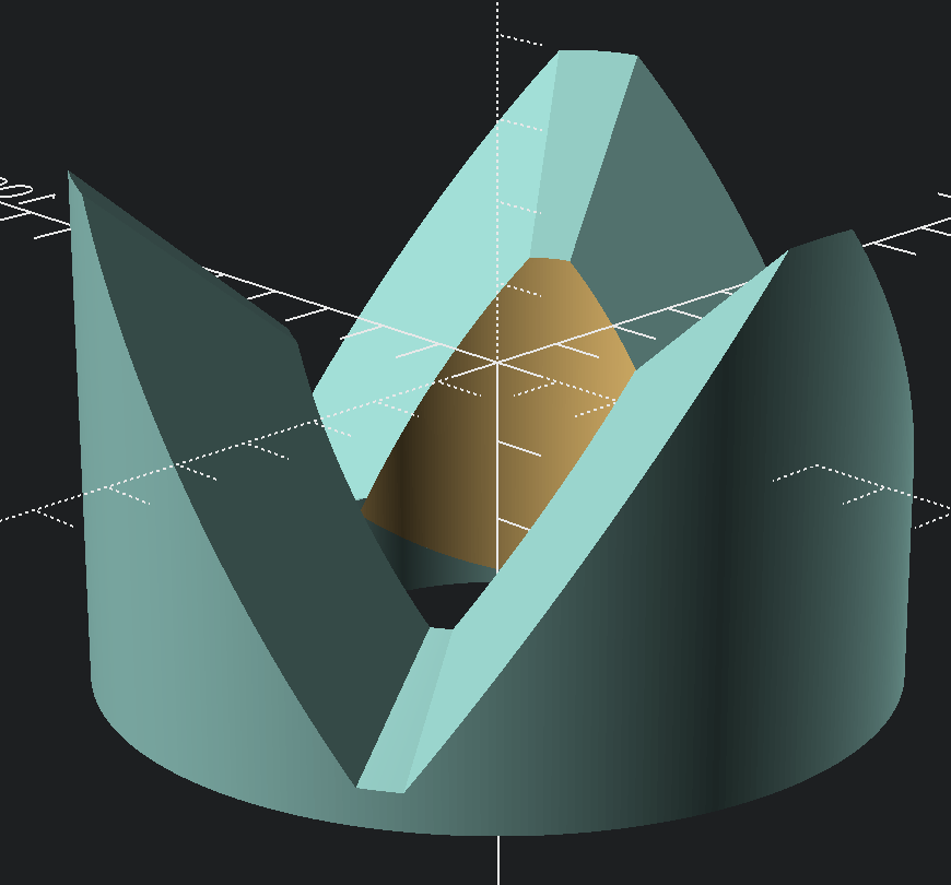

I had been using spherical coordinates and that made it very easy to construct the part using only the 3 angles, groove angle, ridge angle and tooth angle (radial between teeth). Since I have been specifying the chamfer as a percentage of the tooth height, I realized that finding the angles for the chamfers was easy too since everything is proportional including the angles.
The final realization I had though is that normal spherical coordinates did not produce quite the right result as the radii I know are the inner and outer ones. These lie on a cylinder not a sphere. I looked into cylinder_to_xyz in BOSL2 and found that it uses (r, theta, z), spherical uses (r, theta, phi). I needed something else. I created sperical2_to_xyz(r, theta, phi). This is the same as spherical but r is the radius in the XY plane, not in XYZ. It was quite easy to alter the spherical_to_xyz code to get what I wanted.
Here is just a code fragment but it gets the point across.
IR = _ir(hs);
OR = _or(hs) / cos(180/_n(hs)); // OR is the radius of the circumscribing polygon of N
// Ridge Chamfer
thetaCA2 = _toothAngle(hs) * _chamfer(hs)/200;
phiCA   =  (_grooveAngle(hs) -_ridgeAngle(hs)) * _chamfer(hs)/100;
function profileToooth(r) =
     [spherical2_to_xyz(r,  thetaCA2,          _ridgeAngle(hs) + phiCA),
      spherical2_to_xyz(r,  _toothAngle(hs)/2, _grooveAngle(hs)),
      spherical2_to_xyz(r, -_toothAngle(hs)/2, _grooveAngle(hs)),
      spherical2_to_xyz(r, - thetaCA2,         _ridgeAngle(hs) + phiCA)
It works down to N = 3 and could work for N = 2 if the profile were changed to a half tooth. I used skin at first but that breaks down at low tooth counts. I also found that using the tooth profile to produce the groove chamfer didn’t work very well with skin or hull, so I now do that as part of adding the base. I’ll post more complete code soon as I can.

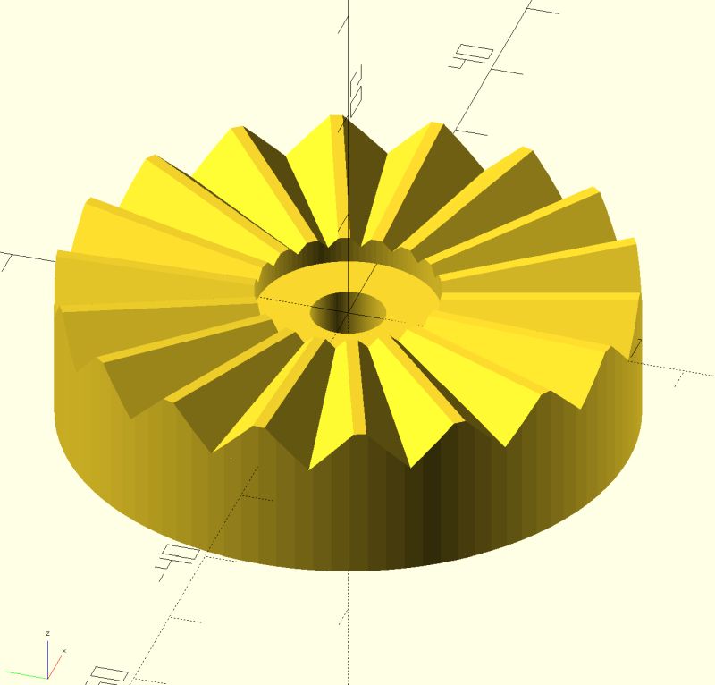

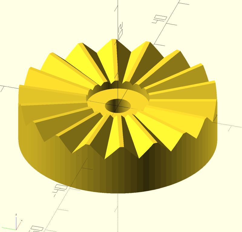

Since a new thread was requested, I'm starting a new thread.  I completed an implementation based on the principles I previously described of tilting the triangle.  One thing that I didn't make clear is that even though the errors are small at high tooth counts, those errors can make the polyhedron invalid.  Part of the intention of my approach was to construct the hirth joint as a single polyhedron.  If you're willing to accept that a 30 tooth joint is a 60 sided polyhedron then you don't need the extra complications of intersecting with a tube.
I thought it would be a simple matter to round the valleys, but I was wrong.  I can round the tooth tips, but not the valleys because the tilt of the triangle causes a rounding profile to stick out and create a funny ridge along the valley.  Perhaps the approach can be adapted to use projection instead of tilt?
Here's a 16 tooth example:
<image.png>
Here's 8 teeth:
<image.png>
Code is attached.  A significant amount of complication arose from calculating the location of the bottoms of the valleys in the case where you crop the part with a cylinder.  Code attached.

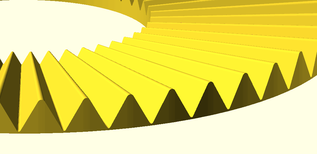

Bob Carlson
Thu, Nov 7, 2024 12:54 AM
I have established that there is an error in the code fragment. The line
Is where the error lies. What should it be? I was assuming that the theta for the chamfer “shoulder” point would be proportional to the chamfer but it produces a slight error. It is barely noticeable but gets more blatant at low tooth counts and high conic.
Anyone see what it should be? I’m guessing there is some trig functions involved,but ...
-Bob

Thu, Nov 7, 2024 2:41 AM
Bob, I did I think exactly the same thing in my code and didn't notice
anything, but now that you mention it, doing chamfers on an angular basis
is of course not going to match doing them on a linear basis.  So that
means the geometry changes a bit if you change the chamfer size.  This
isn't necessarily catastrophic, but is a little unexpected, I suppose.
Generally speaking you can't mate two parts produced with different chamfer
size anyway, so I'm not sure this is crucial to get right.  But in order to
get it right, I think both thetaCA2 and phiCA are going to need to be
computed with trig---either that or there's some complicated way of
computing just one.  The question is whether these two parameters can be
computed independently or are they related in some complicated way.
Treated as a 2d problem you are trying to get the angle that corresponds to
a fraction of a chord of the circle, which is a reasonably straight forward
triangle calculation.  I got atan(chamfer*tan(angle)) where angle is
180/tooth_count for the ridge chamfer.  But the chamfered one still doesn't
align with the unchamfered.  For example:
Yellow is unchamfered.  Blue has huge chamfer applied only at ridge (and
slightly larger radius so we can see it clearly).  And we see that the
angle has changed.  I actually got less error with the original
calculation, but that might be because I didn't correct the phi angle only
the theta angle.  (Or maybe I botched the trig.)  So I tried computing a
correction for phi and got ridge_angle-atan(ridge_angle -
chamfer*(tan(ridge_angle)-tan(valley_angle))), but still things don't line
up correctly.  (And the horizontal correction is still worse than not,
which makes me wonder if the horizontal correction needs to take into
account the vertical position of the chamfer somehow.)  Doing the phi
correction alone actually is an improvement over no correction.
Here's my current code (without any chamfer corrections).  It does rounding
and skew teeth.

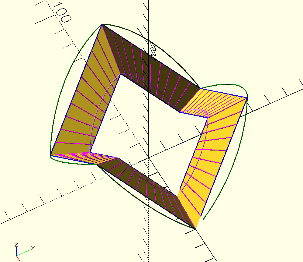

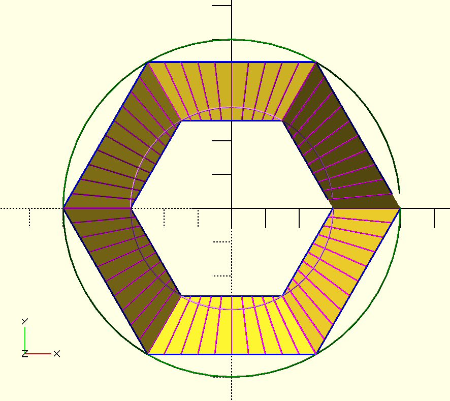

I don't think the straight projection on cylinder will work.
The only way I think this can work is if you project using vectors
considering outer race and inner race, projecting outwards and inwards
respectively on outer and inner cylinder.
picture below can make this clear.
magenta lines are the vectors
[image: Screenshot 2024-11-07 at 9.49.27 AM.png]
[image: Screenshot 2024-11-07 at 9.53.29 AM.png]
On Thu, 7 Nov, 2024, 8:12 am Adrian Mariano via Discuss, <

I don't think the straight projection on cylinder will work. The only way I think this can work is if you project using vectors considering outer race and inner race, projecting outwards and inwards respectively on outer and inner cylinder. picture below can make this clear. magenta lines are the vectors [image: Screenshot 2024-11-07 at 9.49.27 AM.png] [image: Screenshot 2024-11-07 at 9.53.29 AM.png] On Thu, 7 Nov, 2024, 8:12 am Adrian Mariano via Discuss, < discuss@lists.openscad.org> wrote: > Bob, I did I think exactly the same thing in my code and didn't notice > anything, but now that you mention it, doing chamfers on an angular basis > is of course not going to match doing them on a linear basis. So that > means the geometry changes a bit if you change the chamfer size. This > isn't necessarily catastrophic, but is a little unexpected, I suppose. > Generally speaking you can't mate two parts produced with different chamfer > size anyway, so I'm not sure this is crucial to get right. But in order to > get it right, I think both thetaCA2 and phiCA are going to need to be > computed with trig---either that or there's some complicated way of > computing just one. The question is whether these two parameters can be > computed independently or are they related in some complicated way. > Treated as a 2d problem you are trying to get the angle that corresponds to > a fraction of a chord of the circle, which is a reasonably straight forward > triangle calculation. I got atan(chamfer*tan(angle)) where angle is > 180/tooth_count for the ridge chamfer. But the chamfered one still doesn't > align with the unchamfered. For example: > > [image: image.png] > > Yellow is unchamfered. Blue has huge chamfer applied only at ridge (and > slightly larger radius so we can see it clearly). And we see that the > angle has changed. I actually got less error with the original > calculation, but that might be because I didn't correct the phi angle only > the theta angle. (Or maybe I botched the trig.) So I tried computing a > correction for phi and got ridge_angle-atan(ridge_angle - > chamfer*(tan(ridge_angle)-tan(valley_angle))), but still things don't line > up correctly. (And the horizontal correction is still worse than not, > which makes me wonder if the horizontal correction needs to take into > account the vertical position of the chamfer somehow.) Doing the phi > correction alone actually is an improvement over no correction. > > Here's my current code (without any chamfer corrections). It does > rounding and skew teeth. > > module hirth(n, ir, or, id, od, tooth_angle=60, cone_angle=0, chamfer, > rounding, base=1, crop=false,skew=0, rot=false, orient,anchor,spin) > { > ir = get_radius(r=ir,d=id); > or = get_radius(r=or,d=od); > dummy = assert(all_positive([ir]), "ir/id must be a positive value") > assert(all_positive([or]), "or/od must be a positive value") > assert(is_int(n) && n>1, "n must be an integer larger than 1") > assert(is_finite(skew) && abs(skew)<=1, "skew must be a number > between -1 and 1") > assert(ir<or, "inside radius (ir/id) must be smaller than > outside radius (or/od)") > assert(all_positive([tooth_angle]) && tooth_angle<360*(n-1)/2/n, > str("tooth angle must be between 0 and ",360*(n-1)/2/n," for spline with > ",n," teeth.")) > assert(num_defined([chamfer,rounding]) <=1, "Cannot define both > chamfer and rounding") > assert(is_undef(chamfer) || all_nonnegative([chamfer]) && > chamfer<1/2, "chamfer must be a non-negative value smaller than 1/2") > assert(is_undef(rounding) || all_nonnegative([rounding]) && > rounding<1/2, "rounding must be a non-negative value smaller than 1/2") > assert(all_positive([base]), "base must be a positive value") ; > tooth_height = sin(180/n) / tan(tooth_angle/2); // Normalized tooth > height > cone_height = -tan(cone_angle); // Normalized > height change corresponding to the cone angle > ridge_angle = atan(tooth_height/2 + cone_height); > valley_angle = atan(-tooth_height/2 + cone_height); > angle = 180/n; // Half the angle occupied by each tooth going around > the circle > > factor = crop ? 3 : 1; // Make it oversized when crop is true > > profile = is_undef(rounding) || rounding==0 ? > let( > chamfer=default(chamfer,0), > vchamf = chamfer*(ridge_angle-valley_angle), > pts = [ > [-angle*(1-chamfer/2), valley_angle+vchamf/2], > [-angle*chamfer, ridge_angle-vchamf] > ], > full = deduplicate(concat(pts, reverse(xflip(pts)))) > ) > back(valley_angle, > skew(sxy=skew*angle/(ridge_angle-valley_angle),fwd(valley_angle,full))) > : let( > vround=rounding*(ridge_angle-valley_angle), > profpts = [ > [ -angle, valley_angle+vround/2], > [ -angle*(1-rounding/2), > valley_angle+vround/2], > [ -angle*rounding, ridge_angle-vround], > ], > segs = max(16,segs(or*rounding)), > full = concat(profpts, reverse(xflip(profpts))), > skewed = back(valley_angle, > skew(sxy=skew*angle/(ridge_angle-valley_angle),fwd(valley_angle,full))), > // Using computed values for the joints > lead to round-off error issues > joints = [(skewed[1]-skewed[0]).x, > (skewed[3]-skewed[2]).x/2, > (skewed[3]-skewed[2]).x/2,(skewed[5]-skewed[4]).x ], > roundpts = round_corners(skewed, joint=joints, > closed=false,$fn=segs) > ) > roundpts; > > // project spherical coordinate point onto cylinder of radius r > cyl_proj = function (r,theta_phi) > [for(pt=theta_phi) > let(xyz = spherical_to_xyz(1,pt[0], 90-pt[1])) > r * xyz / norm(point2d(xyz))]; > > bottom = > min([tan(valley_angle)*ir,tan(valley_angle)*or])-base-cone_height*ir; > safebottom = > min([tan(valley_angle)*ir/factor,tan(valley_angle)*or*factor])-base-(crop?1:0)-cone_height*ir; > ang_ofs = !rot ? -skew*angle > : n%2==0 ? -(angle-skew*angle) - skew*angle > : -angle*(2-skew)-skew*angle; > topinner = down(cone_height*ir,[for(ang=lerpn(0,360,n,endpoint=false)) > each > zrot(ang+ang_ofs,cyl_proj(ir/factor,profile))]); > topouter = down(cone_height*ir,[for(ang=lerpn(0,360,n,endpoint=false)) > each > zrot(ang+ang_ofs,cyl_proj(factor*or,profile))]); > botinner = [for(val=topinner) [val.x,val.y,safebottom]]; > botouter = [for(val=topouter) [val.x,val.y,safebottom]]; > vert = [topouter, topinner, botinner, botouter]; > > anchors = [ > named_anchor("teeth_bot", [0,0,bottom], DOWN) > ]; > attachable(anchor=anchor,spin=spin,orient=orient, r=or, > h=-2*bottom,anchors=anchors){ > intersection(){ > vnf_polyhedron(vnf_vertex_array(vert, reverse=true, col_wrap=true, > row_wrap=true),convexity=min(10,n)); > if (crop) > > zmove(bottom)tube(or=or,ir=ir,height=4*or,anchor=BOT,$fa=1,$fs=1); > } > children(); > } > } > > > > On Wed, Nov 6, 2024 at 7:55 PM Bob Carlson via Discuss < > discuss@lists.openscad.org> wrote: > >> I have established that there is an error in the code fragment. The line >> >> thetaCA2 = _toothAngle(hs) * _chamfer(hs)/200; >> >> Is where the error lies. What should it be? I was assuming that the theta >> for the chamfer “shoulder” point would be proportional to the chamfer but >> it produces a slight error. It is barely noticeable but gets more blatant >> at low tooth counts and high conic. >> >> Anyone see what it should be? I’m guessing there is some trig >> functions involved,but ... >> >> -Bob >> >> On Nov 5, 2024, at 10:29, Bob Carlson via Discuss < >> discuss@lists.openscad.org> wrote: >> >> Here is just a code fragment but it gets the point across. >> >> IR = _ir(hs); >> OR = _or(hs) / cos(180/_n(hs)); // OR is the radius of the >> circumscribing polygon of N >> >> // Ridge Chamfer >> thetaCA2 = _toothAngle(hs) * _chamfer(hs)/200; >> phiCA = (_grooveAngle(hs) -_ridgeAngle(hs)) * _chamfer(hs)/100; >> >> function profileToooth(r) = >> [spherical2_to_xyz(r, thetaCA2, _ridgeAngle(hs) + >> phiCA), >> spherical2_to_xyz(r, _toothAngle(hs)/2, _grooveAngle(hs)), >> spherical2_to_xyz(r, -_toothAngle(hs)/2, _grooveAngle(hs)), >> spherical2_to_xyz(r, - thetaCA2, _ridgeAngle(hs) + >> phiCA) >> ]; >> >> >> _______________________________________________ >> OpenSCAD mailing list >> To unsubscribe send an email to discuss-leave@lists.openscad.org >> > _______________________________________________ > OpenSCAD mailing list > To unsubscribe send an email to discuss-leave@lists.openscad.org >
Thu, Nov 7, 2024 4:58 AM
this is the final version (attached is the scad file)
[image: Screenshot 2024-11-07 at 10.26.12 AM.png]
On Thu, 7 Nov 2024 at 09:54, Sanjeev Prabhakar sprabhakar2006@gmail.com

this is the final version (attached is the scad file) [image: Screenshot 2024-11-07 at 10.26.12 AM.png] On Thu, 7 Nov 2024 at 09:54, Sanjeev Prabhakar <sprabhakar2006@gmail.com> wrote: > I don't think the straight projection on cylinder will work. > The only way I think this can work is if you project using vectors > considering outer race and inner race, projecting outwards and inwards > respectively on outer and inner cylinder. > picture below can make this clear. > magenta lines are the vectors > [image: Screenshot 2024-11-07 at 9.49.27 AM.png] > [image: Screenshot 2024-11-07 at 9.53.29 AM.png] > > On Thu, 7 Nov, 2024, 8:12 am Adrian Mariano via Discuss, < > discuss@lists.openscad.org> wrote: > >> Bob, I did I think exactly the same thing in my code and didn't notice >> anything, but now that you mention it, doing chamfers on an angular basis >> is of course not going to match doing them on a linear basis. So that >> means the geometry changes a bit if you change the chamfer size. This >> isn't necessarily catastrophic, but is a little unexpected, I suppose. >> Generally speaking you can't mate two parts produced with different chamfer >> size anyway, so I'm not sure this is crucial to get right. But in order to >> get it right, I think both thetaCA2 and phiCA are going to need to be >> computed with trig---either that or there's some complicated way of >> computing just one. The question is whether these two parameters can be >> computed independently or are they related in some complicated way. >> Treated as a 2d problem you are trying to get the angle that corresponds to >> a fraction of a chord of the circle, which is a reasonably straight forward >> triangle calculation. I got atan(chamfer*tan(angle)) where angle is >> 180/tooth_count for the ridge chamfer. But the chamfered one still doesn't >> align with the unchamfered. For example: >> >> [image: image.png] >> >> Yellow is unchamfered. Blue has huge chamfer applied only at ridge (and >> slightly larger radius so we can see it clearly). And we see that the >> angle has changed. I actually got less error with the original >> calculation, but that might be because I didn't correct the phi angle only >> the theta angle. (Or maybe I botched the trig.) So I tried computing a >> correction for phi and got ridge_angle-atan(ridge_angle - >> chamfer*(tan(ridge_angle)-tan(valley_angle))), but still things don't line >> up correctly. (And the horizontal correction is still worse than not, >> which makes me wonder if the horizontal correction needs to take into >> account the vertical position of the chamfer somehow.) Doing the phi >> correction alone actually is an improvement over no correction. >> >> Here's my current code (without any chamfer corrections). It does >> rounding and skew teeth. >> >> module hirth(n, ir, or, id, od, tooth_angle=60, cone_angle=0, chamfer, >> rounding, base=1, crop=false,skew=0, rot=false, orient,anchor,spin) >> { >> ir = get_radius(r=ir,d=id); >> or = get_radius(r=or,d=od); >> dummy = assert(all_positive([ir]), "ir/id must be a positive value") >> assert(all_positive([or]), "or/od must be a positive value") >> assert(is_int(n) && n>1, "n must be an integer larger than 1") >> assert(is_finite(skew) && abs(skew)<=1, "skew must be a number >> between -1 and 1") >> assert(ir<or, "inside radius (ir/id) must be smaller than >> outside radius (or/od)") >> assert(all_positive([tooth_angle]) && >> tooth_angle<360*(n-1)/2/n, str("tooth angle must be between 0 and >> ",360*(n-1)/2/n," for spline with ",n," teeth.")) >> assert(num_defined([chamfer,rounding]) <=1, "Cannot define both >> chamfer and rounding") >> assert(is_undef(chamfer) || all_nonnegative([chamfer]) && >> chamfer<1/2, "chamfer must be a non-negative value smaller than 1/2") >> assert(is_undef(rounding) || all_nonnegative([rounding]) && >> rounding<1/2, "rounding must be a non-negative value smaller than 1/2") >> assert(all_positive([base]), "base must be a positive value") ; >> tooth_height = sin(180/n) / tan(tooth_angle/2); // Normalized tooth >> height >> cone_height = -tan(cone_angle); // Normalized >> height change corresponding to the cone angle >> ridge_angle = atan(tooth_height/2 + cone_height); >> valley_angle = atan(-tooth_height/2 + cone_height); >> angle = 180/n; // Half the angle occupied by each tooth going around >> the circle >> >> factor = crop ? 3 : 1; // Make it oversized when crop is true >> >> profile = is_undef(rounding) || rounding==0 ? >> let( >> chamfer=default(chamfer,0), >> vchamf = chamfer*(ridge_angle-valley_angle), >> pts = [ >> [-angle*(1-chamfer/2), >> valley_angle+vchamf/2], >> [-angle*chamfer, ridge_angle-vchamf] >> ], >> full = deduplicate(concat(pts, reverse(xflip(pts)))) >> ) >> back(valley_angle, >> skew(sxy=skew*angle/(ridge_angle-valley_angle),fwd(valley_angle,full))) >> : let( >> vround=rounding*(ridge_angle-valley_angle), >> profpts = [ >> [ -angle, valley_angle+vround/2], >> [ -angle*(1-rounding/2), >> valley_angle+vround/2], >> [ -angle*rounding, ridge_angle-vround], >> ], >> segs = max(16,segs(or*rounding)), >> full = concat(profpts, reverse(xflip(profpts))), >> skewed = back(valley_angle, >> skew(sxy=skew*angle/(ridge_angle-valley_angle),fwd(valley_angle,full))), >> // Using computed values for the joints >> lead to round-off error issues >> joints = [(skewed[1]-skewed[0]).x, >> (skewed[3]-skewed[2]).x/2, >> (skewed[3]-skewed[2]).x/2,(skewed[5]-skewed[4]).x ], >> roundpts = round_corners(skewed, joint=joints, >> closed=false,$fn=segs) >> ) >> roundpts; >> >> // project spherical coordinate point onto cylinder of radius r >> cyl_proj = function (r,theta_phi) >> [for(pt=theta_phi) >> let(xyz = spherical_to_xyz(1,pt[0], 90-pt[1])) >> r * xyz / norm(point2d(xyz))]; >> >> bottom = >> min([tan(valley_angle)*ir,tan(valley_angle)*or])-base-cone_height*ir; >> safebottom = >> min([tan(valley_angle)*ir/factor,tan(valley_angle)*or*factor])-base-(crop?1:0)-cone_height*ir; >> ang_ofs = !rot ? -skew*angle >> : n%2==0 ? -(angle-skew*angle) - skew*angle >> : -angle*(2-skew)-skew*angle; >> topinner = down(cone_height*ir,[for(ang=lerpn(0,360,n,endpoint=false)) >> each >> zrot(ang+ang_ofs,cyl_proj(ir/factor,profile))]); >> topouter = down(cone_height*ir,[for(ang=lerpn(0,360,n,endpoint=false)) >> each >> zrot(ang+ang_ofs,cyl_proj(factor*or,profile))]); >> botinner = [for(val=topinner) [val.x,val.y,safebottom]]; >> botouter = [for(val=topouter) [val.x,val.y,safebottom]]; >> vert = [topouter, topinner, botinner, botouter]; >> >> anchors = [ >> named_anchor("teeth_bot", [0,0,bottom], DOWN) >> ]; >> attachable(anchor=anchor,spin=spin,orient=orient, r=or, >> h=-2*bottom,anchors=anchors){ >> intersection(){ >> vnf_polyhedron(vnf_vertex_array(vert, reverse=true, >> col_wrap=true, row_wrap=true),convexity=min(10,n)); >> if (crop) >> >> zmove(bottom)tube(or=or,ir=ir,height=4*or,anchor=BOT,$fa=1,$fs=1); >> } >> children(); >> } >> } >> >> >> >> On Wed, Nov 6, 2024 at 7:55 PM Bob Carlson via Discuss < >> discuss@lists.openscad.org> wrote: >> >>> I have established that there is an error in the code fragment. The line >>> >>> thetaCA2 = _toothAngle(hs) * _chamfer(hs)/200; >>> >>> Is where the error lies. What should it be? I was assuming that the >>> theta for the chamfer “shoulder” point would be proportional to the chamfer >>> but it produces a slight error. It is barely noticeable but gets more >>> blatant at low tooth counts and high conic. >>> >>> Anyone see what it should be? I’m guessing there is some trig >>> functions involved,but ... >>> >>> -Bob >>> >>> On Nov 5, 2024, at 10:29, Bob Carlson via Discuss < >>> discuss@lists.openscad.org> wrote: >>> >>> Here is just a code fragment but it gets the point across. >>> >>> IR = _ir(hs); >>> OR = _or(hs) / cos(180/_n(hs)); // OR is the radius of the >>> circumscribing polygon of N >>> >>> // Ridge Chamfer >>> thetaCA2 = _toothAngle(hs) * _chamfer(hs)/200; >>> phiCA = (_grooveAngle(hs) -_ridgeAngle(hs)) * _chamfer(hs)/100; >>> >>> function profileToooth(r) = >>> [spherical2_to_xyz(r, thetaCA2, _ridgeAngle(hs) + >>> phiCA), >>> spherical2_to_xyz(r, _toothAngle(hs)/2, _grooveAngle(hs)), >>> spherical2_to_xyz(r, -_toothAngle(hs)/2, _grooveAngle(hs)), >>> spherical2_to_xyz(r, - thetaCA2, _ridgeAngle(hs) + >>> phiCA) >>> ]; >>> >>> >>> _______________________________________________ >>> OpenSCAD mailing list >>> To unsubscribe send an email to discuss-leave@lists.openscad.org >>> >> _______________________________________________ >> OpenSCAD mailing list >> To unsubscribe send an email to discuss-leave@lists.openscad.org >> >
John David
Thu, Nov 7, 2024 6:23 AM
very nice!  Thank you for sharing ;-)
On Wed, Nov 6, 2024 at 11:59 PM Sanjeev Prabhakar via Discuss <

[  -anglerounding, ridge_angle-vround],
rounding)),
roundpts;
[for(pt=theta_phi)
bottom =
min([tan(valley_angle)ir,tan(valley_angle)or])-base-cone_heightir;
safebottom =
min([tan(valley_angle)ir/factor,tan(valley_angle)orfactor])-base-(crop?1:0)-cone_heightir;
angle
:  n%2==0 ? -(angle-skewangle)  - skewangle
:  -angle*(2-skew)-skewangle;
each
topouter = down(cone_heightir,[for(ang=lerpn(0,360,n,endpoint=false))
each
or,profile))]);
anchors = [
intersection(){
if (crop)
-Bob
 IR = _ir(hs);
 // Ridge Chamfer
phiCA),
phiCA)
