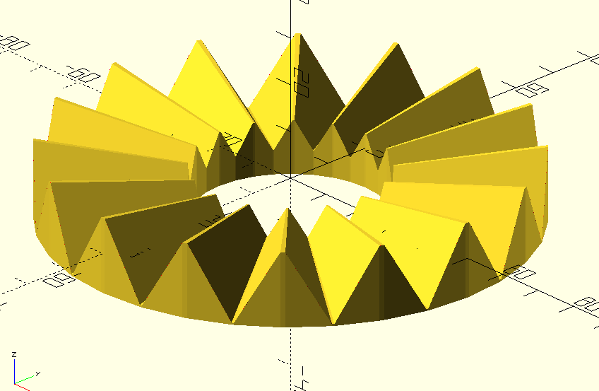

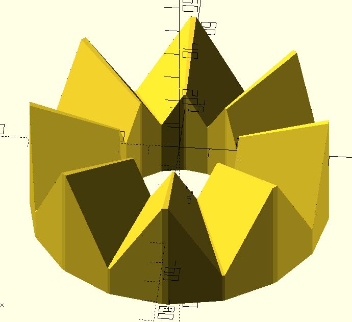

Since a new thread was requested, I'm starting a new thread.  I completed
an implementation based on the principles I previously described of tilting
the triangle.  One thing that I didn't make clear is that even though the
errors are small at high tooth counts, those errors can make the polyhedron
invalid.  Part of the intention of my approach was to construct the hirth
joint as a single polyhedron.  If you're willing to accept that a 30 tooth
joint is a 60 sided polyhedron then you don't need the extra complications
of intersecting with a tube.
I thought it would be a simple matter to round the valleys, but I was
wrong.  I can round the tooth tips, but not the valleys because the tilt of
the triangle causes a rounding profile to stick out and create a funny
ridge along the valley.  Perhaps the approach can be adapted to use
projection instead of tilt?
Here's a 16 tooth example:
Here's 8 teeth:
Code is attached.  A significant amount of complication arose from
calculating the location of the bottoms of the valleys in the case where
you crop the part with a cylinder.  Code attached.

A lot of discussion but it doesn't look like a useful coupling to me as it
will always try to force itself apart. Wouldn't straight sided teeth with a
chamfer to aid initial engagement be better.

I think the point is that it wedges together with good alignment and no
slop. Square teeth would need a clearance gap and then there would be
backlash.

@nop head nop.head@gmail.com
, these type of joints are typically loaded, so they cannot just pop off.
Another take on the theme, if someone develops a profile they like on one
side, they should be able to use a geometrical diff operation to form the
mating surface without slop. That said, the profile has to be symmetric to
accommodate the adjustment.
Hope this helps.
Here's 8 teeth:
Here's 8 teeth:
where you crop the part with a cylinder. Code attached.
