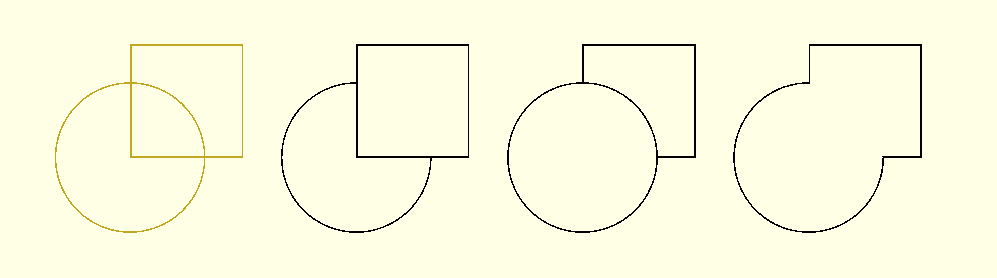

The problem is that OpenSCAD isn't a drawing program.  Here's a
snippet that I drew trivially in Inkscape:
OpenSCAD can't draw that, can't draw that box overlapping a circle.
OpenSCAD doesn't have lines, and doesn't have unfilled shapes.  It has
only filled shapes.  And the rendering process that's required before
export, that resolves things like unions and differences, destroys all
color information and (because the result is a filled shape) destroys
all internal lines.
You might think that
circle(10);
square(15);
would produce that figure, but it won't, not even if you make them
different colors, because the rendered output will be
with the interior lines destroyed - because a filled shape by definition
doesn't have interior lines.
With a bit of tedium (or with an appropriate library), you can do this:
$fa = 1;
$fs = 1;
t = 0.2;
    circle(10);
    circle(10-t);
    square(15);
    translate([t,t])
        square(15-t*2);
and it'll look sort of right:
But now let's zoom in... OpenSCAD on the left and Inkscape on the right.
The "lines" that were drawn with OpenSCAD got thicker, because they are
really filled shapes.  The lines drawn with Inkscape stay thin, because
they are really lines.
So, net, yes, you can use OpenSCAD to draw black and white drawings that
have no jaggies, if you're careful to draw your own lines using really
skinny 2D shapes and you don't zoom in very much.  But you have to draw
them as 2D shapes.  If you have a 3D model that you want a 2D image
of, this technique is no help at all, and OpenSCAD doesn't have tools
that will help you.

The attached image shows different combinations of your square and
circle that /can/ be done with OpenSCAD.
Yes, you can get more variations by stacking 2D or vertically-thin 3D
objects.
You can make 2D drawings with OpenSCAD.  It just isn't all that easy,
and it isn't all that obvious, and often you are stuck with screen shots
as your only export mechanism.  And, mostly, the techniques won't get
you a line drawing from a 3D model.

On 10/24/25 12:54 PM, Jordan Brown via Discuss wrote:
On 10/24/2025 10:47 AM, Cory Cross wrote:
On 10/23/25 4:22 PM, Jordan Brown via Discuss wrote:
but when you collapse the shape on the right to a 2D object all of
those interior lines will go away.
Could the "no top level union" of lazy union resolve this? It seems
to not work on 2D like it does 3D.
Lazy union was intended as an optimization, not a semantic change.
And although I don't know the details, I believe it's been found to be
a bad idea.  The very fact that you get different results from it says
that it's a bad optimization.
I don't believe it's considered a bad idea on its own. I think it's only
considered bad because it's also semantically different. Which is
exactly the behaviour I think is asked for in this case! But the
implementation only affects 3D, not 2D.
-Cory
