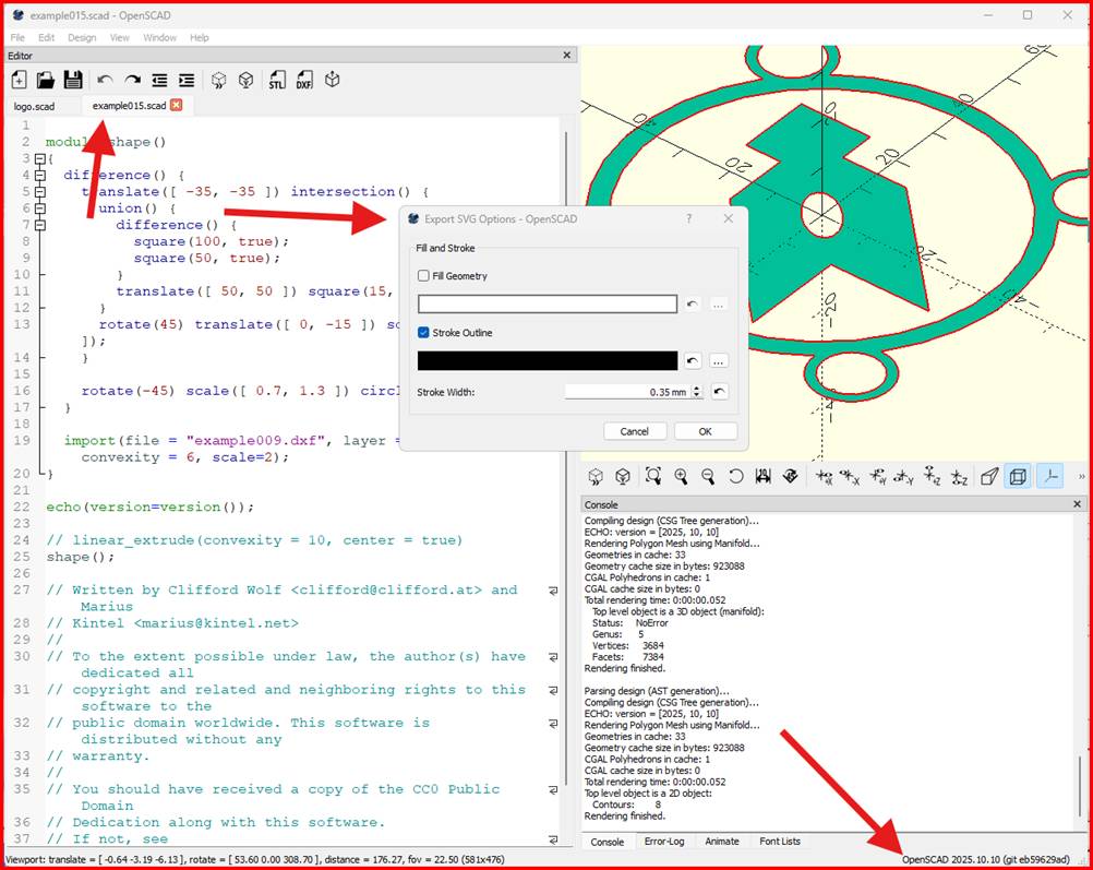

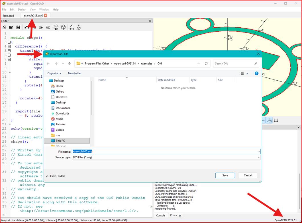

This is 2021 for me:
In Version 2025.05.30 I get dialog boxes with 3MF and PDF, but no explorer dialog box appears for where to save them.

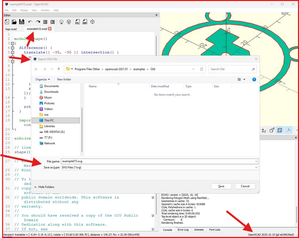

The save dialogue appears AFTER the first dialogue. This is 2025.10.10. I also suggest you get a newer nightly.
a. The SVG dialogue box:
b. The Save as dialogue:

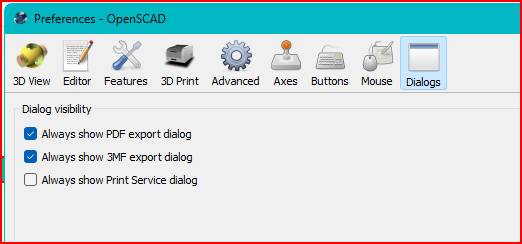

BTW There is this Preference tab, check it:
Not with mine. I’m lucky if I get the first dialogue. Your Version 2021.01 works (image001), why doesn’t mine?

Note the first dialogue box is not in 2021.01, it only has the Export SaveAs dialogue.
