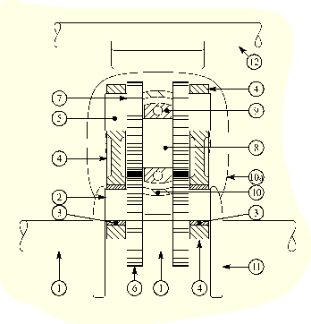

Is there some way of getting a clean image that would also print on
paper with lines as specified in the code?
You have to write your own code for drawing lines in openscad and then it
should be possible to sketch whatever is intended.
One of the example :
[image: Screenshot 2025-10-24 at 7.03.01 AM.png]

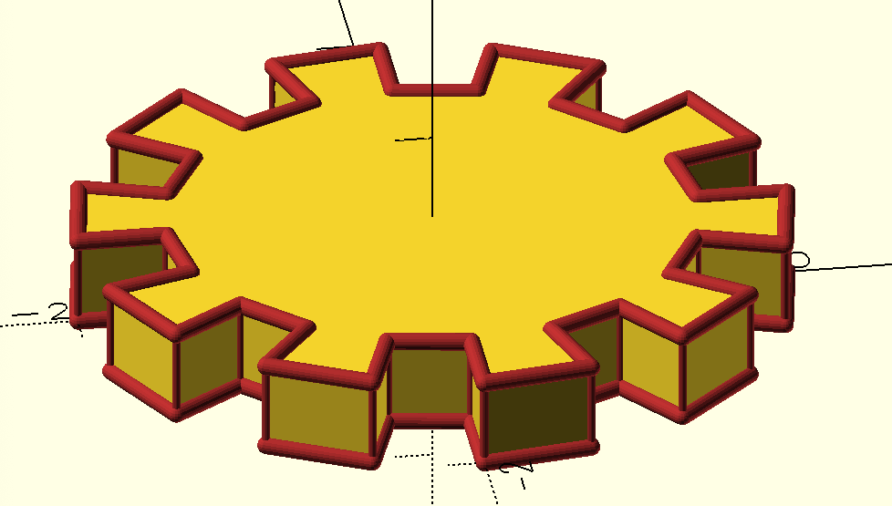

However, all these methods read what’s on the monitor screen, giving a
more or less pixellated image, depending on how many pixels the image is
given.
See the jagged elliptogon and the spur gear with lines of different widths
and some teeth missing altogether in the attached image. It looks messy.
It would also be nice to be able to do the outline of the gear with
thicker lines, and the teeth with thinner lines, but that’s not possible.
Is there some way of getting a clean image that would also print on paper
SHOCK! HORROR!
All those numbers! I like polygons, but this takes them from the sublime to the ridiculous!
My poor little laptop still with Windows 10 would surely suffer a meltdown, because the drawing contains not just one gear, it’s a machine with lots of parts - see the image below with drastically reduced number of pixels to illustrate the problem.
But an interesting idea anyway!

I think this can be done but it will be complicated.
Need to find a simpler solution to this problem.
On Fri, 24 Oct 2025 at 10:49, Caddiy via Discuss discuss@lists.openscad.org
SHOCK! HORROR!
to the ridiculous!

You can get perfectly clean 2D prints from OpenSCAD by creating a 2D
design and exporting it as an SVG or a PDF.
Here's a screen shot from OpenSCAD, enlarged:
Obvious jaggies, right?
Enclosed please find PDF and SVG exports.  Note that they are perfect;
you can zoom in as far as you like and you never see jaggies.  (Well, of
course there are jaggies, because you've viewing them on a pixel screen,
but they're coming from your view, not from the file.)  Print them out
on your 1000dpi printer, and you'll need a microscope to see the
jaggies.  (If you can see them at all, because of anti-aliasing and
print fuzziness.)
The problem is that OpenSCAD isn't a drawing program.  Here's a
snippet that I drew trivially in Inkscape:
OpenSCAD can't draw that, can't draw that box overlapping a circle.
OpenSCAD doesn't have lines, and doesn't have unfilled shapes.  It has
only filled shapes.  And the rendering process that's required before
export, that resolves things like unions and differences, destroys all
color information and (because the result is a filled shape) destroys
all internal lines.

Fri, Oct 24, 2025 5:55 PM
Work around in openscad could be to draw lines with chain hull of spheres
with diameter appropriate for the sketch.
This method i am using for quite a long time and works well for me.
Any color can be given to the edges that way. But yes then you need to
create models with points list and not with openscad primitives. Maybe this
is right now is the issue with most of the people as thinking in terms of
points list is a challenge initially for first few models. Apart from that
there could be a fear of writing too much code for drawing through points,
which is not quite True as per my experience and finally it will turn out
to be far more productive.
