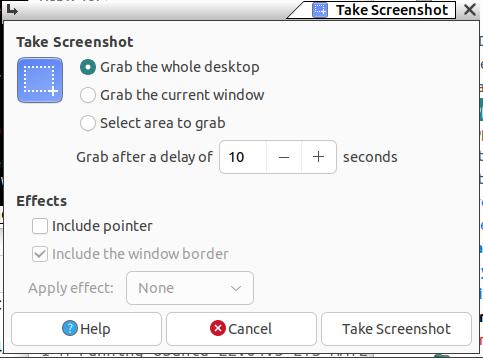

I'm running Ubuntu 22.04.5 LTS MATE
I use
mate-screenshot -i
If I don't need the delay I just use
mate-screenshot -a
I use
mate-screenshot -i
mate-screenshot -a
<mate-screenshot.png>

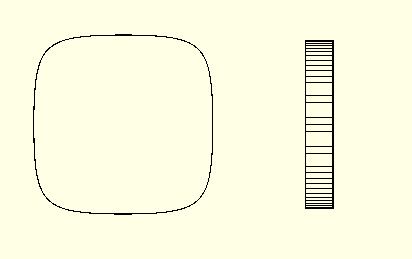

I am now using Win+Shift+S instead of Print and Copy Viewport. It’s very convenient and offers four modes instead of one.
However, all these methods read what’s on the monitor screen, giving a more or less pixellated image, depending on how many pixels the image is given.
See the jagged elliptogon and the spur gear with lines of different widths and some teeth missing altogether in the attached image. It looks messy.
It would also be nice to be able to do the outline of the gear with thicker lines, and the teeth with thinner lines, but that’s not possible.
Is there some way of getting a clean image that would also print on paper with lines as specified in the code?
Jordan Brown wrote: > On 10/22/2025 1:23 PM, Jeffrey Hayes via Discuss wrote: > > > why not just use menu Edit > Copy Viewport Image .. that puts the > > image onto the clipboard and you can paste that directly into a GitHub > > editor to have it automatically upload > > As I said in the original message... image size.  Win+Shift+S lets you > pick a rectangle to snip, which is usually a lot more convenient than > resizing your window so that CVI will grab the size you want. > > Also, CVI has a small bug that messes up the top pixel or so and the > right pixel or so. > > Also, historically, CVI has copied transparency - when you had a > transparent object on the screen, the resulting image would be > transparent and the final display would be not at all what you wanted.  > Ref #3828 <https://github.com/openscad/openscad/issues/3828>.  I can't > duplicate that problem now, so presumably something has changed, but I > can't replicate it even on an older OpenSCAD and that suggests that it's > a platform difference of some kind, rather than something that's been > fixed in OpenSCAD. > > > or on windows use the builtin Snipping Tool to screen shot the whole > > screen, a window, or a selection > > it is much better than what Print Screen used to do (or, i guess that > > should be present tense. > > I believe that Win+Shift+S, my primary recommendation, *is* the Snipping > Tool. > > > and for Mac OS there are a dozen great snapshot tools - is this > > discussion not about reinventing the wheel ? it is possible i have not > > read deeply enough and so have missed something .. sorry if so > > but i think these tools already exist > > The point was not about reinventing anything, but about discussing the > existing alternatives. > > Plus the fact that if you get the image into the clipboard, you can just > paste it into GitHub or email without worrying about file formats. I am now using Win+Shift+S instead of Print and Copy Viewport. It’s very convenient and offers four modes instead of one. However, all these methods read what’s on the monitor screen, giving a more or less pixellated image, depending on how many pixels the image is given. See the jagged elliptogon and the spur gear with lines of different widths and some teeth missing altogether in the attached image. It looks messy. It would also be nice to be able to do the outline of the gear with thicker lines, and the teeth with thinner lines, but that’s not possible. Is there some way of getting a clean image that would also print on paper with lines as specified in the code?
Thu, Oct 23, 2025 11:22 PM
looks messy.
No, or at least not in general.
My first thought was "export to SVG", and that will work for the shape
on the left, but when you collapse the shape on the right to a 2D object
all of those interior lines will go away.  If you made things different
colors, that might help.
OpenSCAD doesn't really do 2D, not in the sense of a program like
Inkscape.  It has no notion of lines, only of filled shapes.
You can try projection() to turn your model into a 2D object and then
export as SVG, but with some experiments you'll find that's a limited
solution.
