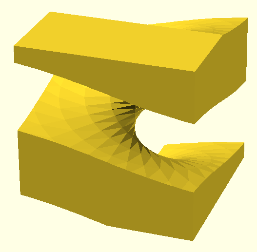

Such objects can be separated automatically using topological analysis
(as in 'polyfix'). Assuming the original file from OpenSCAD is
"boxes.stl", you can split them into disjoint "lumps"
polyfix -lumps ./boxes.stl -out=*.obj
The result is one file per disjoint lump.  This works by repeatedly
looking up neighbouring faces, it works as long as the parts are truly
disjoint. The complexity of the shapes is irrelevant.

Rogier,
I realize you'd like the whole thing in OpenSCAD, but it seems very
difficult.
I have a command utility that splits parts out of an STL into multiple
STL files, in case that helps. I also have a utility that converts an
STL back to an OpenSCAD file (as a single polyhedron).
The code is a work in progress, but I've attached a clean-building ZIP
file. If you're on Linux, you can just go to MeshUtil and type "make".
After putting your example in split-test.scad:
$ openscad -o split-test.stl split-test.scad
$ ./stl_split split-test.stl
Number of triangles: 1996
Split into 2 parts
Writing: part.1.stl
Writing: part.2.stl
$ ./stl_to_scad part.1.stl part.1.scad
$ ./stl_to_scad part.2.stl part.2.scad
$ openscad part.*.scad
BTW, that's a pretty cool object to come out of so few lines of SCAD!

On 12/31/25 09:46, Rogier Wolff via Discuss wrote:
I am working on objects that are created like this:
m = 0.5;
cs = 50;
difference () {
translate ([0,0,cs/2+.001]) cube (cs, center=true);
linear_extrude (height=cs+.002, twist = 5*90, convexity=10) square ([100,m], center=true);
Put it on its side and 3D-print and you have a simple puzzle to put it
back together.
But the procedure is to click "split to objects" in the slicer and
orient the pieces before printing. This adds a step that needs to be
redone with an intelligent person behind the keyboard. I want to make
the prints reproducible by doing it in openscad before exporting.
This requires being able to separate the two resulting objects.
Does anybody have a way of doing this?
In this simplest-example,
difference () {
translate ([-50,0])square ([100,100]);
works to get one half. But my splitting shapes are quickly becoming
more complicated from here on out.

On Fri, Jan 02, 2026 at 07:08:06PM -0800, Curt McDowell wrote:
Rogier,
difficult.
I have a command utility that splits parts out of an STL into multiple STL
files, in case that helps. I also have a utility that converts an STL back
The code is a work in progress, but I've attached a clean-building ZIP file.
Split into 2 parts
Writing: part.1.stl
Writing: part.2.stl
Oh, Cool!
I nowadays have a "newscad" script that creates an scad file that has
my "template". It includes my private openscad library (up, down,
dup3, stuff like that.) AND... it defines the "do_output" function.
This function normally does nothing. But there is a script waiting
for changed scads and when that runs the scad, it will generate each
of the output STL files from that openscad source.
If I add this to my bag-of-tricks, I can put a "do_split" in the output
section of my scad file, the script will first run the split(s) and THEN
all the output sections, so I can orient my split objects for printing
in the same scad file!
This looks very much like a workflow that I'm happy with. :-)
m = 0.5;
cs = 50;
difference () {
back together.
difference () {
STL
back
file.
Split into 2 parts
Writing: part.1.stl
Writing: part.2.stl
Oh, Cool!

On Fri, Jan 02, 2026 at 08:20:44PM +0100, Carsten Arnholm via Discuss wrote:
Such objects can be separated automatically using topological analysis (as
in 'polyfix'). Assuming the original file from OpenSCAD is "boxes.stl", you
The result is one file per disjoint lump.  This works by repeatedly looking
up neighbouring faces, it works as long as the parts are truly disjoint. The
